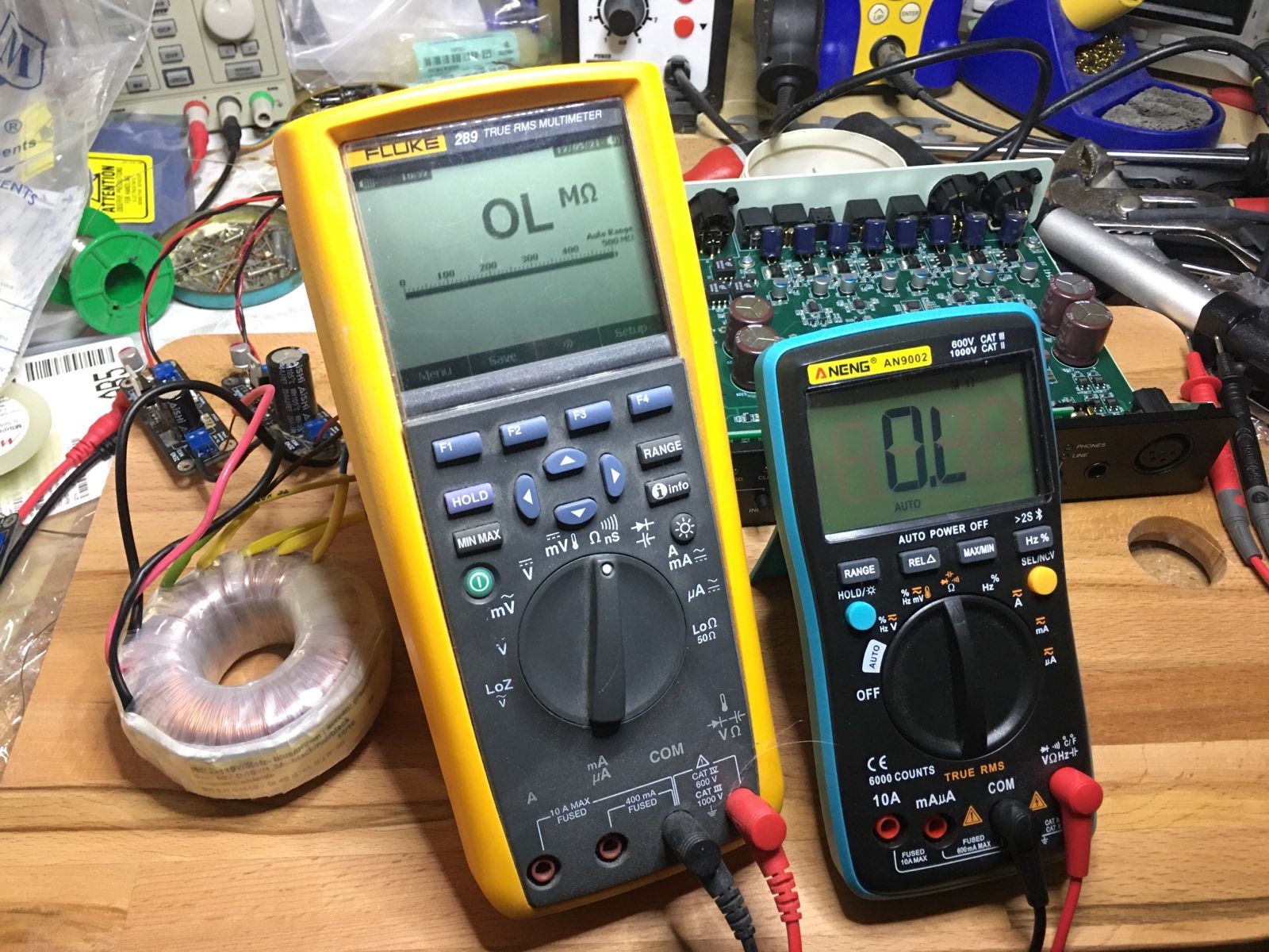

I have a Fluke 289. It is stable and reliable multimeter. After a while, I had to replace super-capacitor on the main board, as it got rusted and meter has lost date etc.
Last year I got an Aneng 9002 for 19euro who measure excellent and allow me to graph or make remote measurements via bluetooth.
These tools can not be compared, in reliability, safe etc, but for the price and what offer, Aneng 9002 is a tool to be considered.

Hi NickKUK,
Cheap meters are only calibrated with a couple adjustments, no others are available. Individual calibration checks are simply not done. This is how it is. Over 50% of cheap meters I calibrated were way out of tolerance new out of the box as part of the pre-sales checks when I worked at Transcat. Many were unable to meet their performance specifications across all functions and ranges. This was documented by myself and the other calibration techs day after day. We used to groan when a cheap meter was presented for calibration as they represented more futile work.
Fluke and HP / Agilent / Keysight meters all had a factory calibration certification included (the more expensive ones did). All meters for those brands tended to fall well within specifications. Basic DC accuracy could be 0.05%, and that is very accurate. Older meters of those brands did tend to stay within tolerance. My HP 974A (I have three) meters are rated for 0.05% basic DC tolerance, and all three are still in tolerance. They are very old meters. My Fluke 85 is also still in tolerance. Not bad at all since they are over 20 years old now and have not required adjustment.
There was one brand I won't mention that had software calibration (called closed case calibration) that was accurate, but they would not maintain that accuracy and drifted. The company charged 1/2 the cost of the meter (that was their factory rate!) to adjust the meter using in house software. They often failed the second calibration interval (one year).
Oscilloscopes historically were not expected to be extremely accurate. Their value was more in showing the waveform accurately and giving you a reading of amplitude within about 2%, better for lab scopes. The most accurate readings would be the horizontal, or time scale. So generally speaking, a modern oscilloscope tends to be a bit more accurate, but it's use is really about time and approximate amplitude. The accuracy will be limited by the probe / scope combination, and the input divider - plus the rest of the active circuitry. So lots of room for errors to creep in. The probes for my scopes run about $275 each Canadian, and passive probes are limited to about 500 MHz. So when you're playing with a DSO and a $20 probe you really have to ask yourself how much to expect in the accuracy department.
So today's DSOs can possibly be more accurate than the older analogue equivalent scope, but they are often about the same accuracy once you figure in the probe. The more expensive digital and mixed signal scopes (MSO) are a lot more accurate, but you still can't expect extreme accuracy. Another issue to watch for is the sampling artifacts which can generate displays that do not represent the waveform that is actually there. For some waveforms I still prefer my old Philips PM3070 and PM3065, but when those are turned on, forget working on FM tuners. The entire reason for the MSO on the bench was to replace the three instruments needed to cover all my measurements. Cheaper digital oscilloscopes do not produce useable displays needed for looking at eye patterns used in digital audio. The Philips scope are perfect for that.
At the end of the day, you can certainly use inexpensive equipment. However, you have got to keep in mind that the readings from those are not very accurate, and the performance can deteriorate rather quickly over time. I do use cheap meters but check them against a good one (called a cross-check) before each session. I toss them when they are far enough out, but they do save a good meter from damage. That's right, they are disposable and untrusted.
If you depend on, or rely on a reading, you cannot afford a cheap meter. At least get one decent meter from Fluke or Keysight. A bench meter is the best, but at least something good. Then you can compare your cheap instrument to it to have an idea what the reading it gave you really was.
We all want to set bias current accurately (so many millivolts) and DC offset (mV again), or a regulator output voltage. We do the work ourselves to do a good job. Why go to that effort and depend on something that cannot be depended upon? Sending cheap stuff out for calibration is expensive, more than a good meter for a couple trips. So I know very few of us will calibrate their meter. Most of us assume best case from the reading on the box without ever even figuring out what that means for a couple ranges. Then you use it for a decade making those same assumptions.
Isn't that flipping crazy?
-Chris
