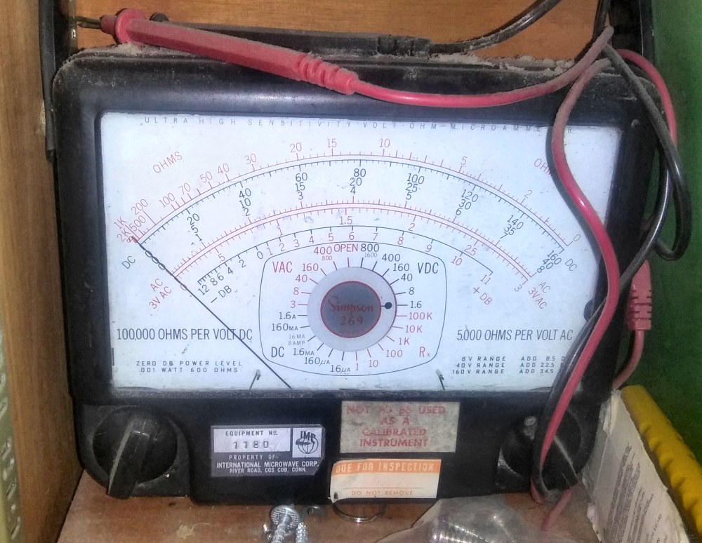

It's got nothing on my Simpson 269 (except sensitivity on the <100V ranges). It's probably from around 1970. All works fine except I won't throw $23 for a 22V battery for high-Ohms. I know why it was in Cos Cob Conn but I can't spill IMC secrets. Yes, the switching is chain-driven, and that is a 16uA meter movement. Yes, I have been letting it sit a while.
No, I did not buy it to use, I rescued it from trash. I use it occasionally, because I no longer value precision (and I have 3 other meters in my voting pool).

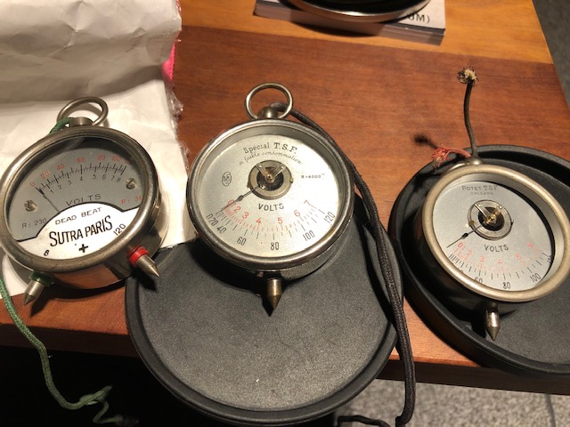

@PRR: these have no plastic to worry about.... Some of those are 100 years old. All of them still work.
