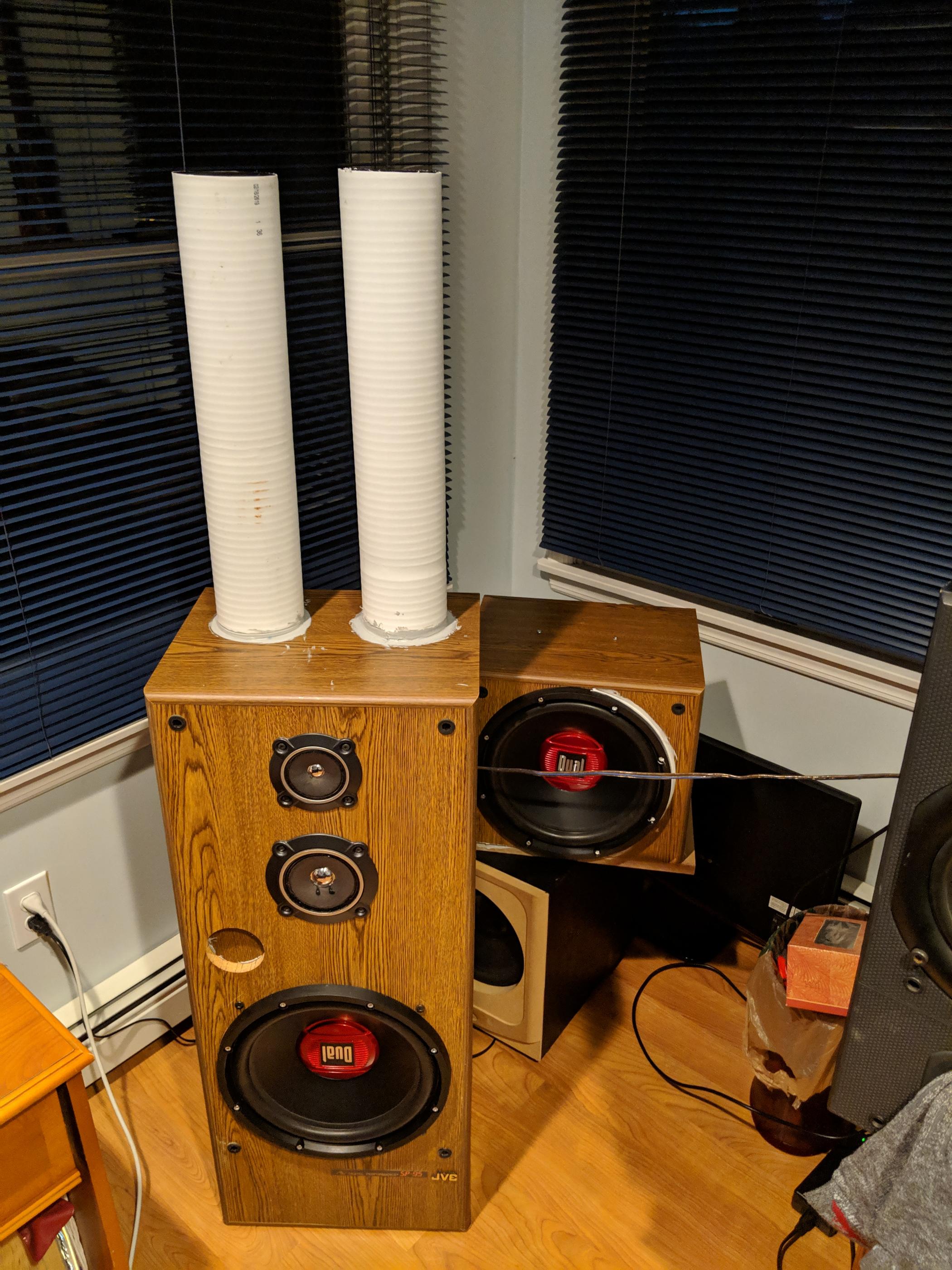

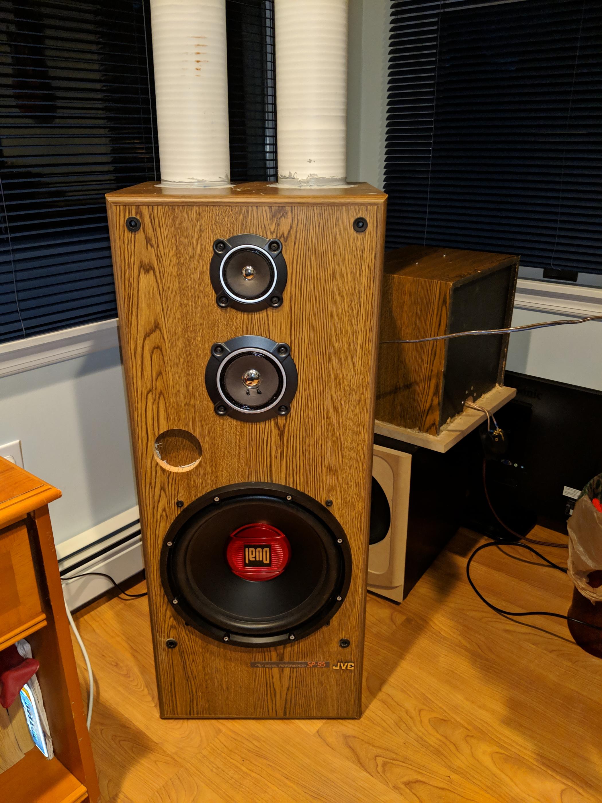

Hi folks, check out my latest creation.
Goals:
  • use the JVC speaker enclosure
  • use a walmart 12" subwoofer ($30)
  • make it go low and loud
I did a similar sealed build documented here, which went low after EQ but didn't get loud, so I thought I'd fix that by making it ported.
Result:
VLjNmj9jQAKwbzx8W-Z-tkqbVUJPnFPux60XRZPV2F985ZnEB8TiqRZAe-KHS6u-bCgOZ337X54Raok_SmjPe0pSkY3HQHQZOAu8t6_bX_pmYjOFjM0iQAsRKec8OF-0lkhF1cbUhVTNf3M87lSSuHto-ajLzVk9GlGpLtTatmxrzBUjI2zUrrghaQ25v4vzBu3PtV-71Jo386YGEOj41u_pVH7YEysMtpr4BvDnzjCBR_-leW-hNnlPxDE81Qb6cBR9i50cQC0aw11mV5DCzQAtowFflvB6-gqcI3aBgXgHTALTWaKXe4tL06Mu84mLw3E4l1-Zf6jPiQ_ndtNh5ujyaY-gbkLWkKh9CkDBn-OeKQZ4L4L2ncLEaXC9YnyQloPaJwAipE96IYWjmA3i-j_2o3Zi3LVWS4sYyWwJvxejX07Nz0vb0-BBvrcGL6Gg185s7LbtxldLtyOwsLUnUBU7k7tXKlDvwu-mNO6NLM_8mNTqCd4gW1msXvs7UwfXs2jBpqqqTY1w1Rew1aSkyPobQUDWbD3MpHF7eSW4PC0Xw3xw0c6ufLca6F34JRelPrkaCfmIV0-Ow3UkwODl8v4eW9Ibq4rWkP9bjBQDbFlY5jbtzywBw7E4s1B9PwL3hcjpHjbZCA6ig-FiWzAX6uKz4qGs57Btel8R3SNB95uYZG0yBe4EOFgZ1yekXmirOeGX-BK1kE5rtKinYeelzQT3=w979-h1305-no
(photo album)

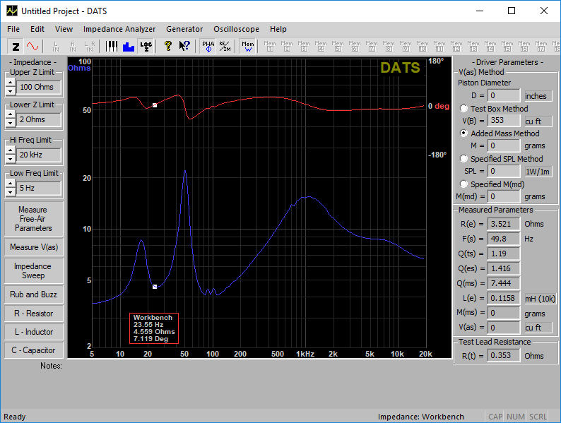

Impedance sweep:

Ports are 4" drain/sewage pipes from home depot (link)
They're 1m long each, they down into the box till they're behind the woofer.
Thoughts:
While it was fun to build, shakes the whole house, it doesn't sound as good as the sealed sub. I know a couple of issues with it already. I'll let you guys guess based on the pics and impedance sweep down in the replies :)
More photos available here: (photo album)
