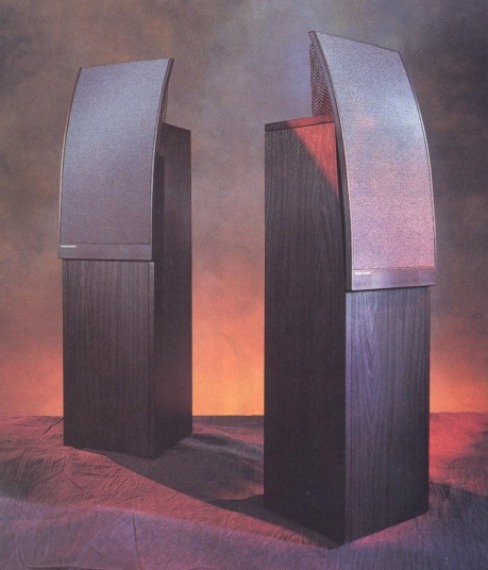

My favorite speakers (Dahlquist DQ 16) are actually semi-aperiodic. They have a port that would make them appear otherwise, however there is a thick foam divider panel bonded into the cabinets which creates the primary chamber.
