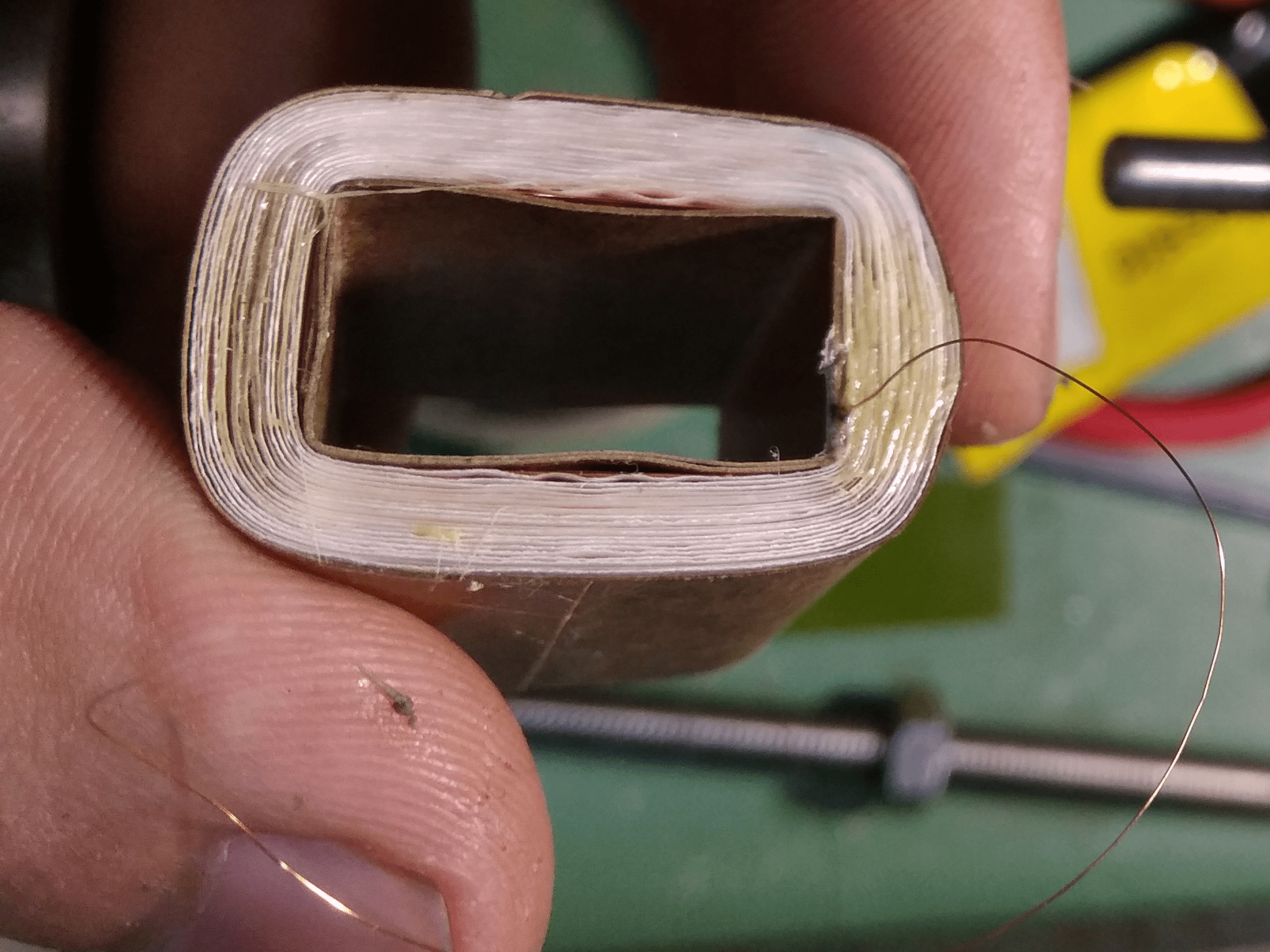

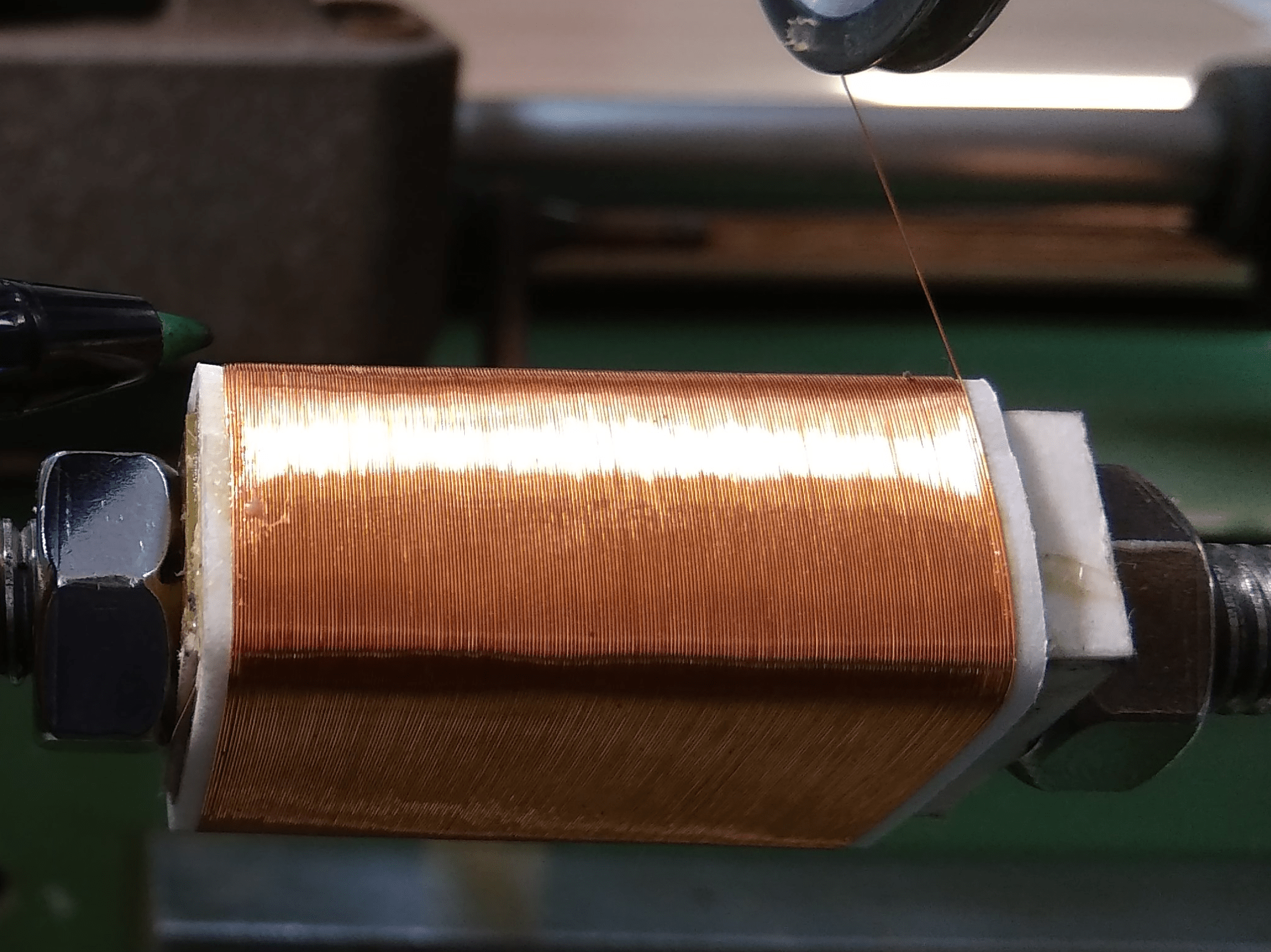

Would you take the challenge of winding on teflon? Its a pita, coldfowing under pressure, slippery as hell, static, almost impossible to tape or glue and certainly not possible to wind selfsupporting but if i where younger maybe doable with a bobbin. What do you thinck? I am asking because i am looking for a winder that would take up the callenge, i could supply the 0,1mm teflon and SU90 bobbins if needed, 12 bifilar wound layers with 0.5mm Cull on each bobbin, 4-8 in total.
I am to old for that, would you take the challange? Offcourse I would pay you properly, I know what it takes...
Hi, first, you don't need teflon, Nomex have very low dielectric coefficient and much more convinient for coil winding process. 2nd, if you are still keen to use teflon, there are adhesive teflon tapes with fabric-like surface, quite expensive but available of varius sizes without any problem. We used them in the past for industrial equipment repair.Would you take the challenge of winding on teflon? Its a pita, coldfowing under pressure, slippery as hell, static, almost impossible to tape or glue and certainly not possible to wind selfsupporting but if i where younger maybe doable with a bobbin. What do you thinck?
A friend, colleague an winder teacher to an extent, told me a tale of his attempt of winding an OPT using teflon one time. It turned out to be a nightmare, he said. Not only due to softness, slipperiness and the inability to glue and hold the teflon well, but he also told me it would easily pick up electrostatic charges and attract all kind of dust around.

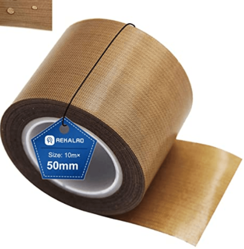

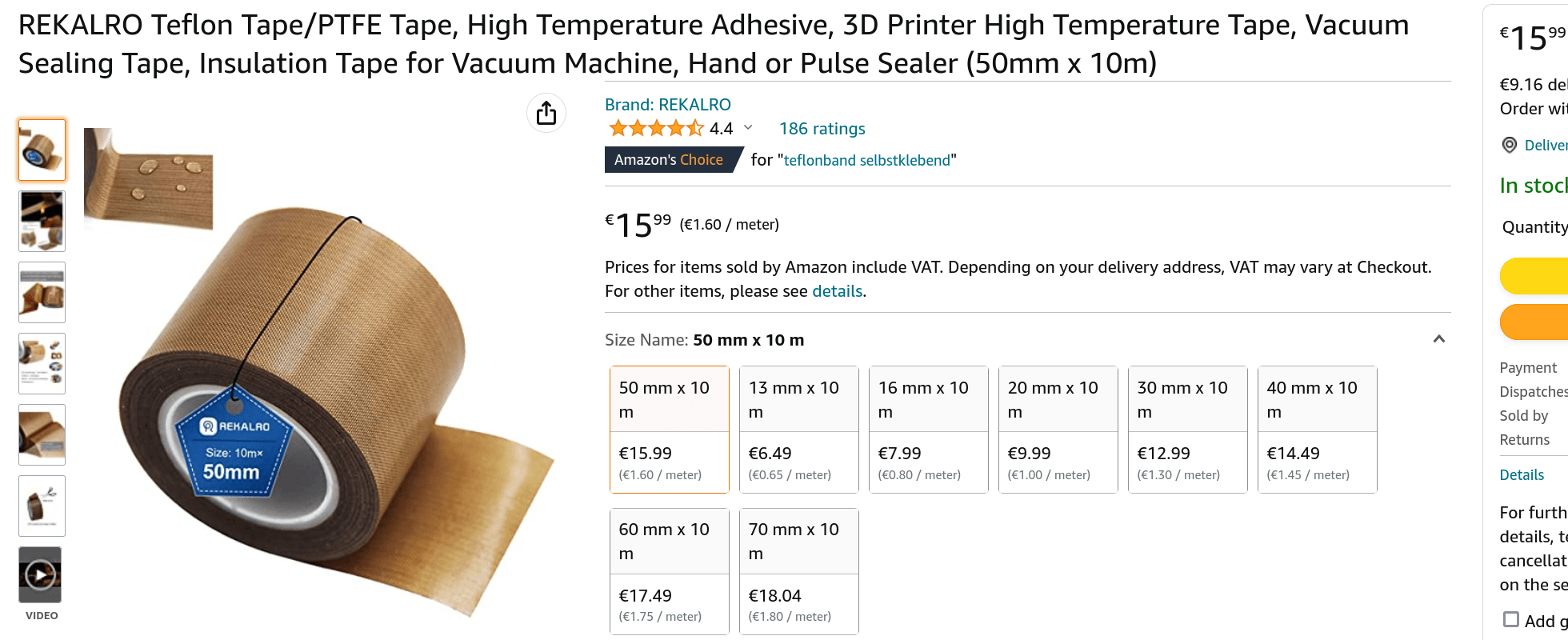

Here is a proper teflon adhesive tape if someone is still fanatically keen to use as insulation in transformer. Again, best overall insulation for transformer manufacturing is a Nomex paper. Period. Personally, I wouldn't mind to use teflon in this particular case.
Hi Linuks Guru, I want teflon because it does not soak when impregnated and only polypropylene or polyethene would have comparable low loss factor.
The teflon tape you mention is glass fiber filled, expensive and not nearly as good as teflon, I would rather etch teflon to make it glue able if needed, but best would be to wind without it. In my youth I did both, etching, without, and also used teflon tape when winding wideband transformer for measuring equipment (0,5-500khz), I am very experienced when it comes to transformers from low level and up to hundreds of kVA for Rf heating. I was specialized in Rf heating. So I know about all there is to know regarding teflon, but now I am 75+ and a bit shaky and this job needs nerves f steel, steady hands and good eyes.
