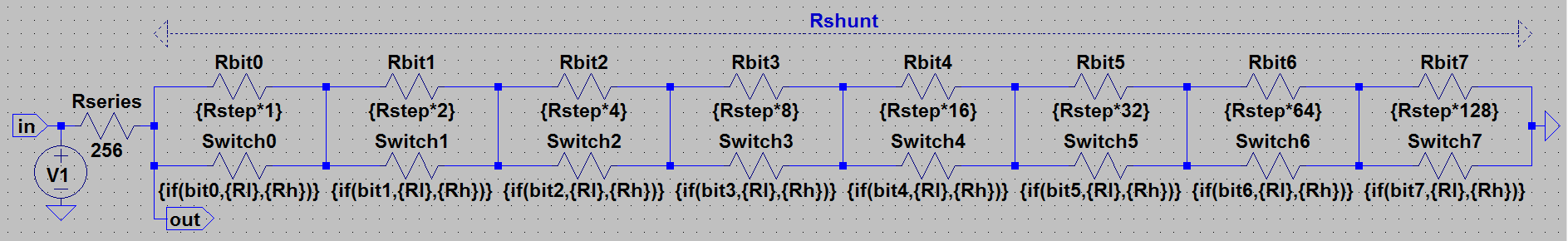

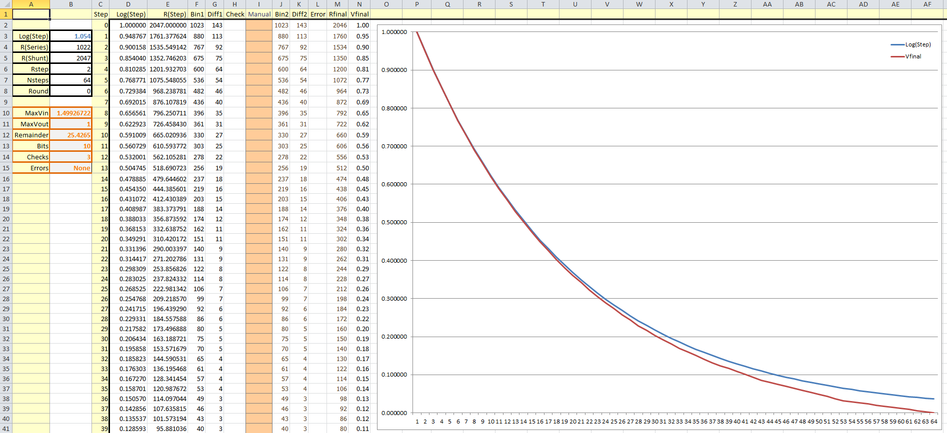

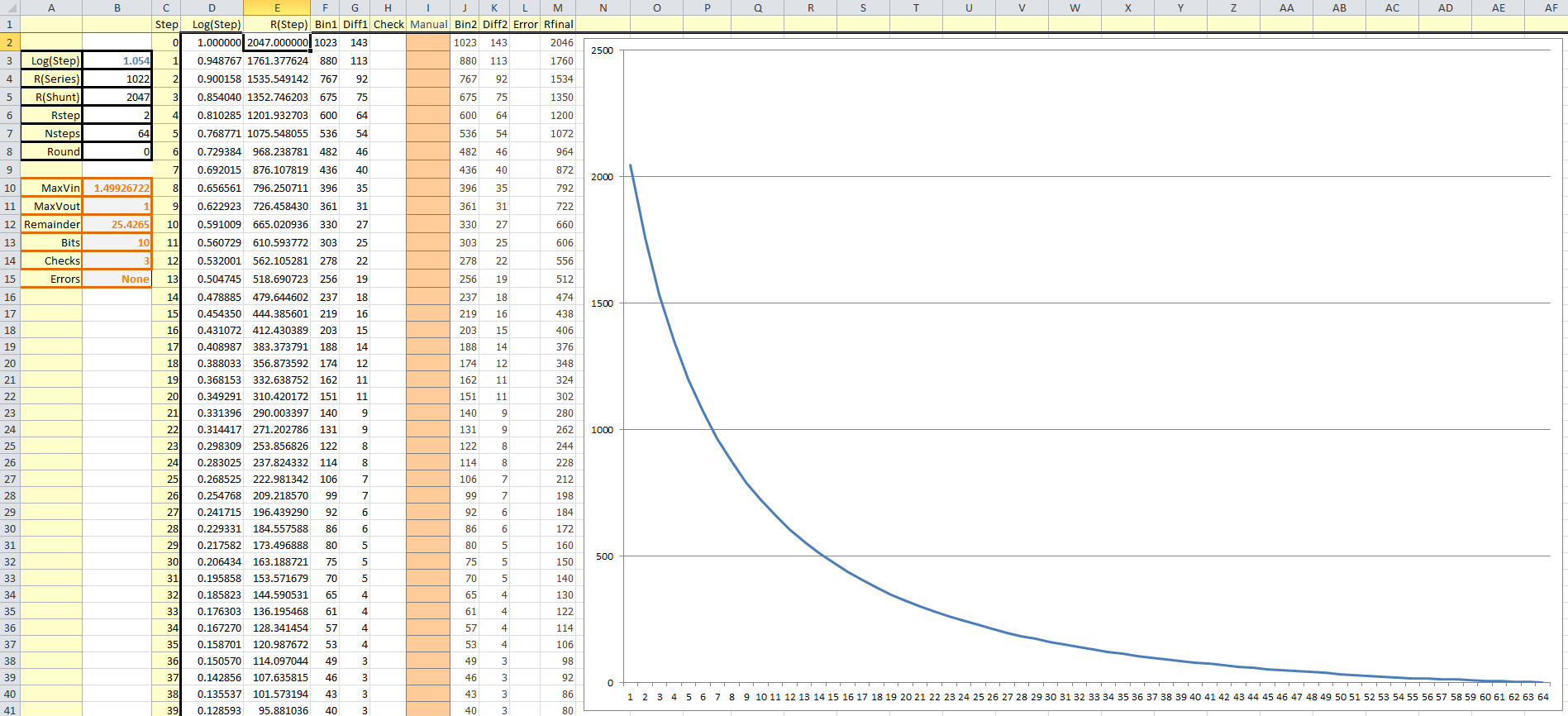

This thread makes a excel sheet available that is intended to calculate the binary values needed to create a resistor ladder network emulating a logarithmic potentiometer with a fixed series element.

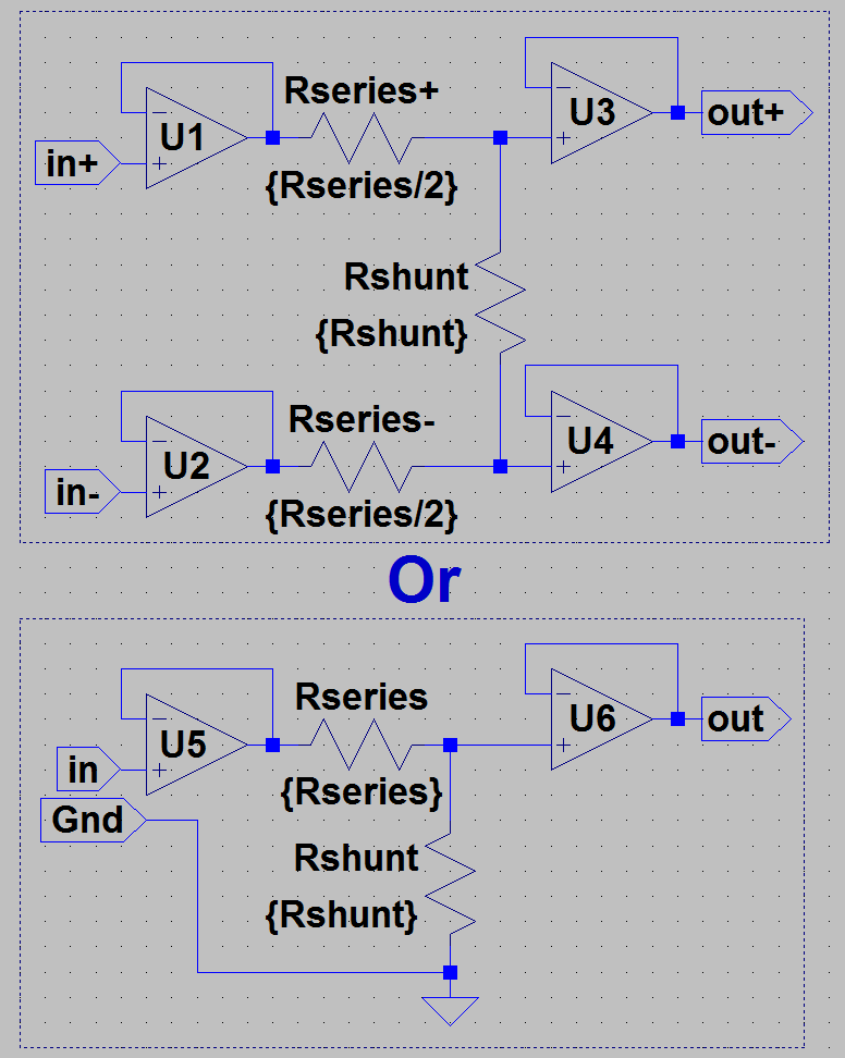

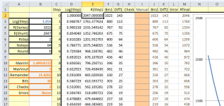

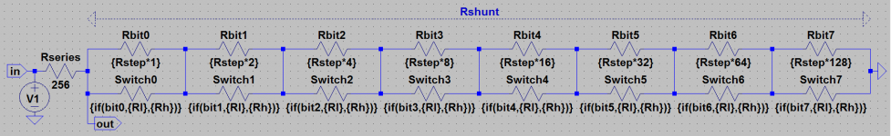

Updated version of the files above, sorry for that 🙂 All files (and more) are included in the .zip-file.
  • Digital Shunt Potentiometer.zip

In the case that the maximum voltage is 2V (on the input) and the series element is 200 ohms then the maximum current, at zero volume, is 20mA. This is easily handled by most (if not all) opamps (or other buffers) so having a series element of 100 ohm is no problem, and the added noise is extremely low. At maximum volume the series element has a high value so the current load on the opamp is neglectable (when the shunt element is 1k it will be 2mA).

First of all it in the diagrams shown in post 1 I show buffers that should be used to drive the low impedance.

If you keep the Rseries resistors below about 1.5 k Ohms, you can still get outstanding noise performance with this design. Good opamps like a 5534 or AD797 will easily cope with that type of load. On my Symphony preamp, I use a 5 k pot, so the worst case input R seen by the buffer is 2.5 k Ohms. The buffer feeds the power amp. It's the quietest preamp I have built. You can see the schema on my website and the write up on the noise calculations and gain structure.
Yes, in my (current) design I am using 2xLME49710 (balanced) and 2x500 Ohm in series, the opamp's are offset into class A using current sources of 5mA while the maximum output voltage (at the opamp's) is 2V (this works great).
