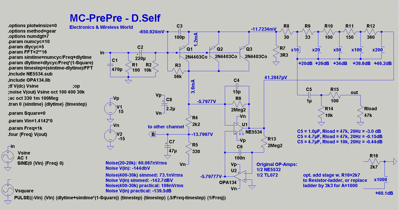

maybe it has been shown before....
anyway here´s a D.Self design published in WirelessWorld probabely in the early 90s.
Easy to source and cheap parts and quite flexible in gain.
ein is ~0.4nV/sqrtHz. Not bad for such a simple circuit.

here´s the asc-file and the models.
Model instructions included in txt-file.
Attached also the original article from e&ww

One thing about that circuit -- the input impedance is essentially R1, or 100 Ohms. If you eliminate R1, or make it a high value, the maximum input impedance is approximately R2||R3. (Approximately).
Great amplifier for MC, but for measurement purposes it loads the DUT.
As you start addressing the stable gain and noise issues the circuit inevitably will no longer be so simple. I wanted something that I could use to measure the noise of my shunt voltage regulator, and the final circuit that was decent enough for me was that one in the attached image. If you look carefully you'll notice that it really a simple circuit. Stable gain precisely dialed in via two precision resistors (1k/1R). And it works in real life, as I built and measured it at about 0.4nV/rtHz. No idea what distortion it has, but that was no concern for me, as I intended to use it just for measuring noise.

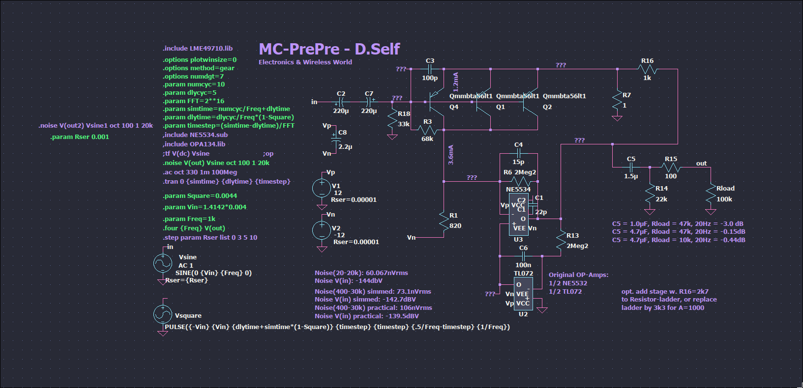

I built this with a few mods, I only kept the 1000x voltage divider and dropped to 1R/1K values, and used two electrolytics back to back so I can sense positive and negative rails. Also increased input impedance a bit. I power it with Li-Ion batteries.Hi,

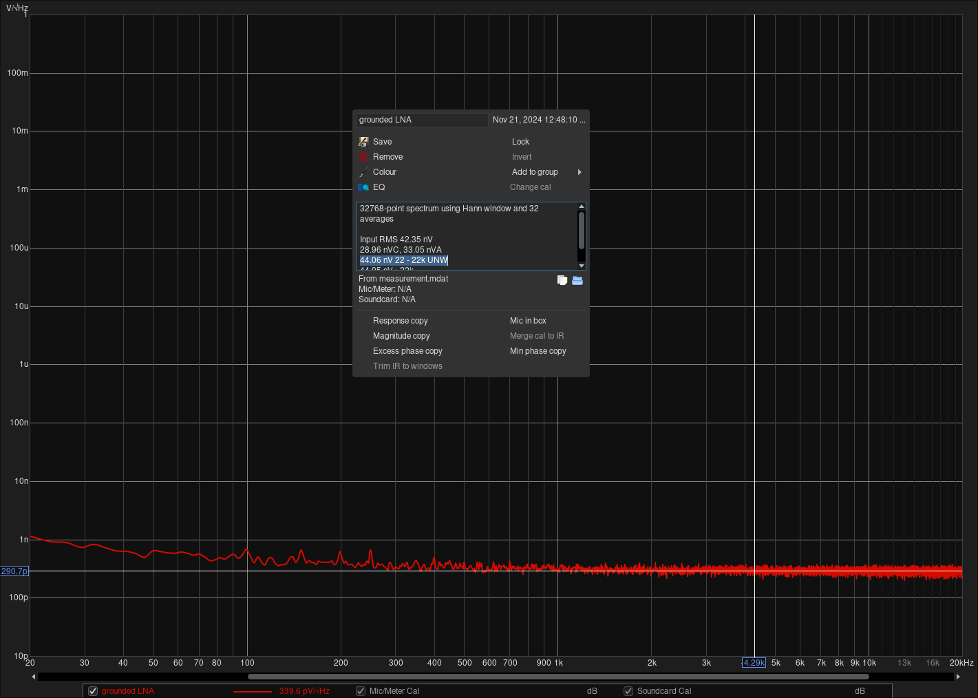

Works fine with very low noise. NE5534 needs a 2.2uF-4.7uF electrolytic across the power supply pins, I installed right on top of the opamp soldered on its pins. Without that cap it wasn't stable.
Also replaced BJTs with MPSA56 (used MMBTA56, three of them, 4th didn't bring much).
Noisefloor:
There is some extra noise 20Hz-1kHz but might be due to my PCB layout, couldn't get it flat to 20Hz. But still pretty good for my needs.
True, but should work fine for power supplies.
