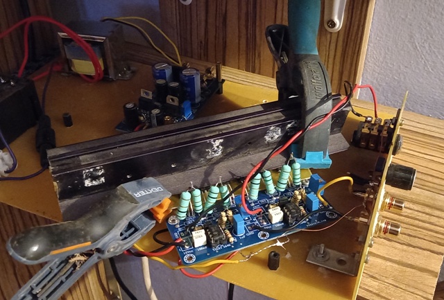

I hurriedly threw some components on this PCB (project). Don't laugh at improvisations. 😀
I connected it to my laptop(Spotify) and listened to it with the AKG702. The supply voltage is 12.5V and I am going to increase it.
Yes, I need a little more gain.
I guess I don't have too many possibilities with this scheme and I would make a preamplifier with 5532 ... I think it's not a very good idea and maybe I'll get some advice.

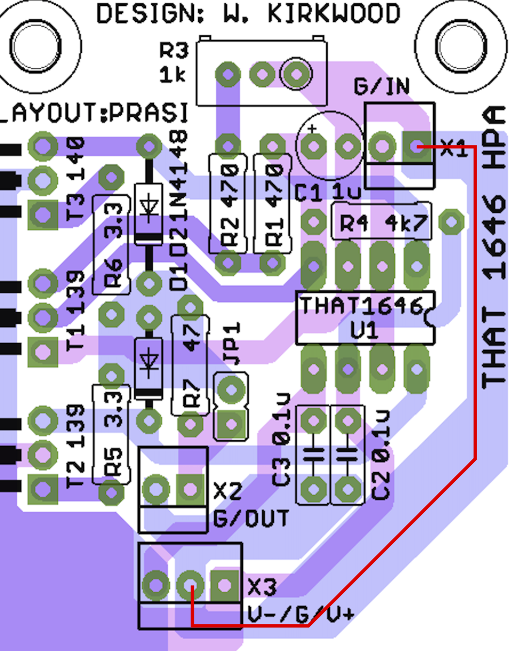

first of all i would like to thank you all Wayne, Xrk, Prasi..
still trying to source ICs but the other day the pcbs arrived Prasi designed;
i have a question abot signal input labels on X1 terminal where the IN labeled trace goes to the GND on X3 terminal..
shouldn't it be in reverse labeling (IN/G) or am i missing something?
thanks in advance..
You're welcome!
It looks like the silkscreen is indeed reversed at the input connector.
"G" should be on the right.

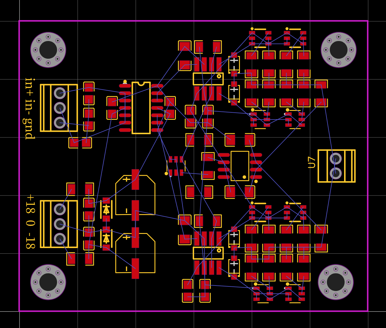

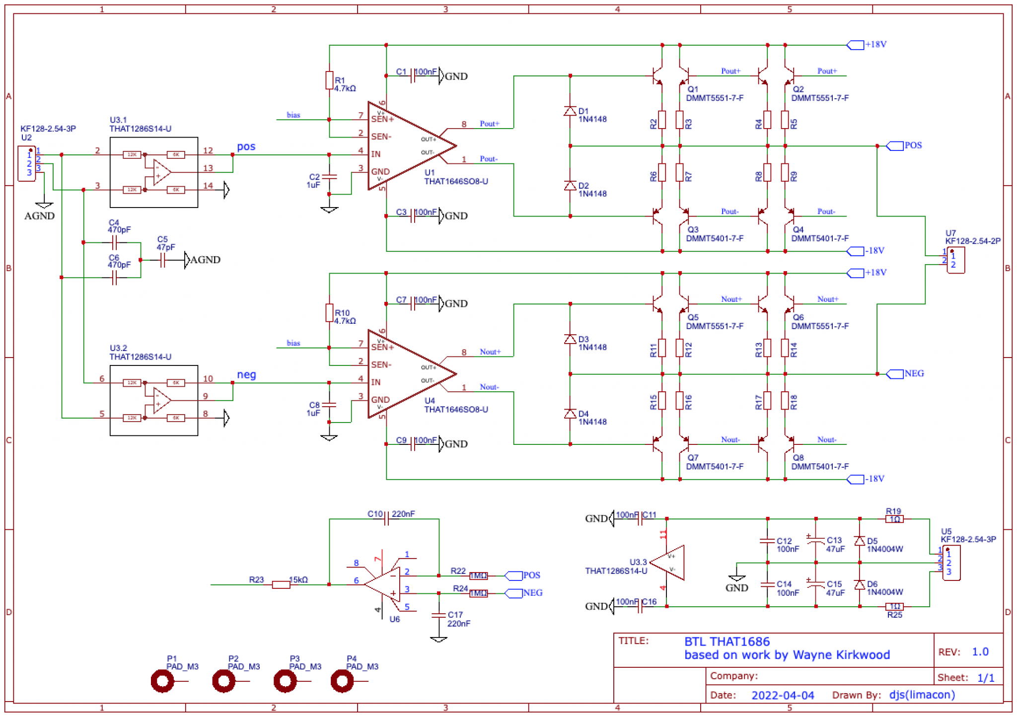

Hi Wayne!
I've started to cook up a small 60x50 board inspired by your design! I have tried to keep it as simple and sparse as possible. I hope to run a 16ohm compression driver with this little amp.
Cross coupled THAT128x
Dual THAT1686 in 'BTL' mode
DMMT5551/DMMT5401
OP27 servo (maybe)
Very much WIP. I have made a start simulating in Tina-Ti. I'd be happy to hear your comments.

Nice!
Where is the third transistor/Vbe multiplier? It provides thermal feedback. I see the "bias" port on the sch but no circuit.
You don't really need a servo in this circuit. The output Vos is low - it's the sum of the 1646 output offsets plus 1/2 the Vbe difference of the NPN/PNP output pairs. Typically its under 5 mV.
I would remove C2 and C8.
