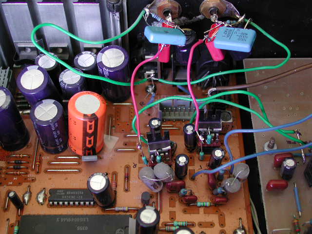

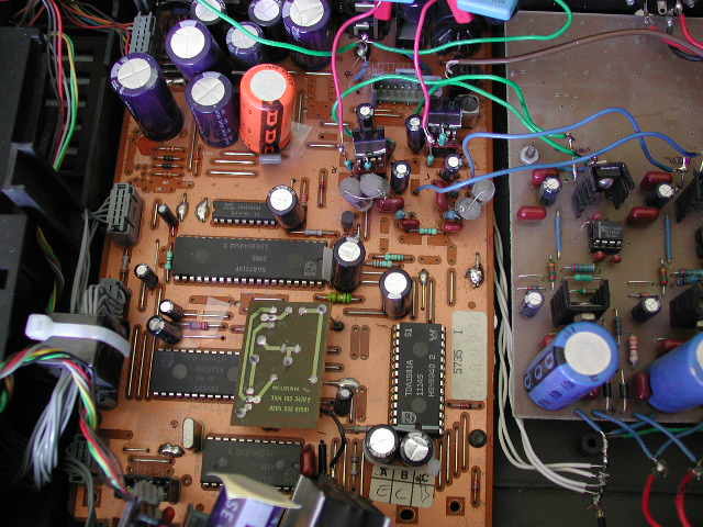

tschrama said:
A oversampling TDA1541A, stock, or DIY? Could you tell someting about your circuit and components.
The CDP is a regular Magnavox CDB650 which was Pooged many years ago it has an SAA7210 decoder and SAA7220 Filter and a TDA1541A S1 DAC.
On the analog section had an AD846 (not shure, but it is a CFB opamp which was proposed originaly by Jung) keeping part of the original analog filter. Later I've been trying to replace it with an LM6181 CFB without any analog filtering.
The analog section PSU is using dedicated Jung/Sulzer super reg at (+)(-) 15V without the sensing option.
Hope I don't forget something important.
Here is a pic of the unit before trying to implement the LM6181 analog section.

Since I am not satisfied with the CDP sound, been trying different approches to this I/V analog section but with my limited electronic knowledge I get frustrated, besides I don't get straight answers from the many well experianced guys around here such as say "you can't do that with an LM6181 so try this" or "your getting into deep waters so follow this approach." which has been the gereral attidude on DIYaudio forums.
Well, frustrated or not I continue to work on this CDP (at my slow pace). To beggin with, I'm quite amazed at all what it can be get from the TDA1541A, it's such an overwelming sound I get from the new opamp (minus the noise of course) that I will like to continue with original oversampling setup, for the moment.
One interesting thing with this "new" approach with the LM6181 is that I decoupled the chips rails with only one 1uf film cap very very near the pins which might be contributing to the excellent sound I'm getting.
On trying to solve the noise (thinking it could be PSU related) I tryed further decoupling adding a ceramic cap at each point plus a MKS 4 0.01u across both rails at the chip.
I had never before try to use ceramic caps, the regular types. The result after this addition degraded the sound.
