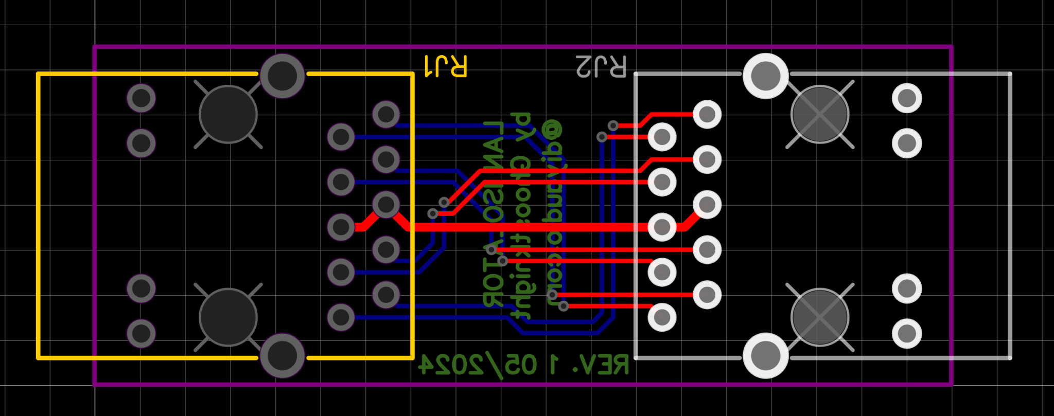

i just came across this device: https://www.dxengineering.com/parts/dxe-iso-plus-10/reviews on the use market and thought i buy one for 25 euro (new they seem to go for 75) to test it... result was pretty surprising imo and i wanna create my own replication of this device, so i dont have to buy more for 75 euro per piece
Simple dongle that i will shield "manually" afterwards with some sort of shrinkwrap/shielding/shrinkwrap "housing"

It baffled me because it looks like pass through. But it's relying on whatever emi filtering is built into the sockets.

oh i should have mentioned it... yes this relies purely on the filtering inside the connectors, take a look at the datasheet of the isolator its based on: https://static.dxengineering.com/global/images/instructions/dxe-iso-plus-2_vo.pdf to see what filtering it does
i think different connectors are pretty comparable... pretty much all say -18db at 10mhz, i choose those: https://www.lcsc.com/datasheet/lcsc_datasheet_2111251530_XKB-Connection-X01AQ070BA2AD_C2916444.pdf
making this thing cost around 5-7 euro
yes in theory most devices like a raspberry already have a connector like this... but the filtering adds up... the dx engineering recommends to use one device at each end, making this possibly 6 connectors with filtering/isolation insideA LAN is ethernet. Ethernet is trafo coupled per standard so isolated (if not power over LAN which obviously is needs a galvanic connection). And yes, it's built in to the sockets. Pretty basic.... and has been for decades...
Now... i just created this pcb because i noticed a improvement with this (and dont wanna spend 80 euro instead of 7euro), so i have some lying around for further experiments
imo this is the cheapest solution you can go with for lan filtering, that still seems pretty effective

not with those connectors: https://www.lcsc.com/datasheet/lcsc_datasheet_2111251530_XKB-Connection-X01AQ070BA2AD_C2916444.pdfRJ45 pairing 1-2, 3-6, 4-5, 7-8
i doublechecked here.... 5-6 is "ground" and pairs are 1-2 3-4 7-8 9-10
No problemsSorry, i miss count connector. You are right. I thought it just 8 pin

hmm since the commercial doesnt connect shield at all and the connectors also dont seem to have any form of low resistance connection from shield to GND im thinking about adding a switch to be able to passtrough the shield, from what i read so far you only dont want connect shield to the end device but shield can be continous from the source device, specially when using multiple lan isolators in series (when using 2 isolators at each cable end the middle cable shield should be "floating" i dont think this is a good idea
i think i will just add a switch tho if someones knows more here... let me know
