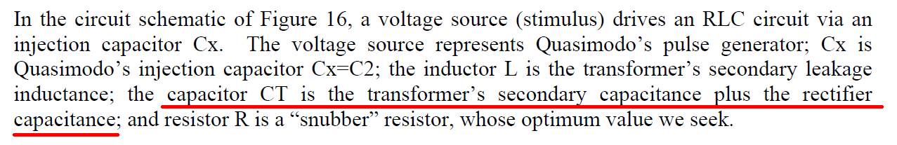

Jack, see equation (A.9)(b) on page 16 and remember the definition of the symbol "CT".

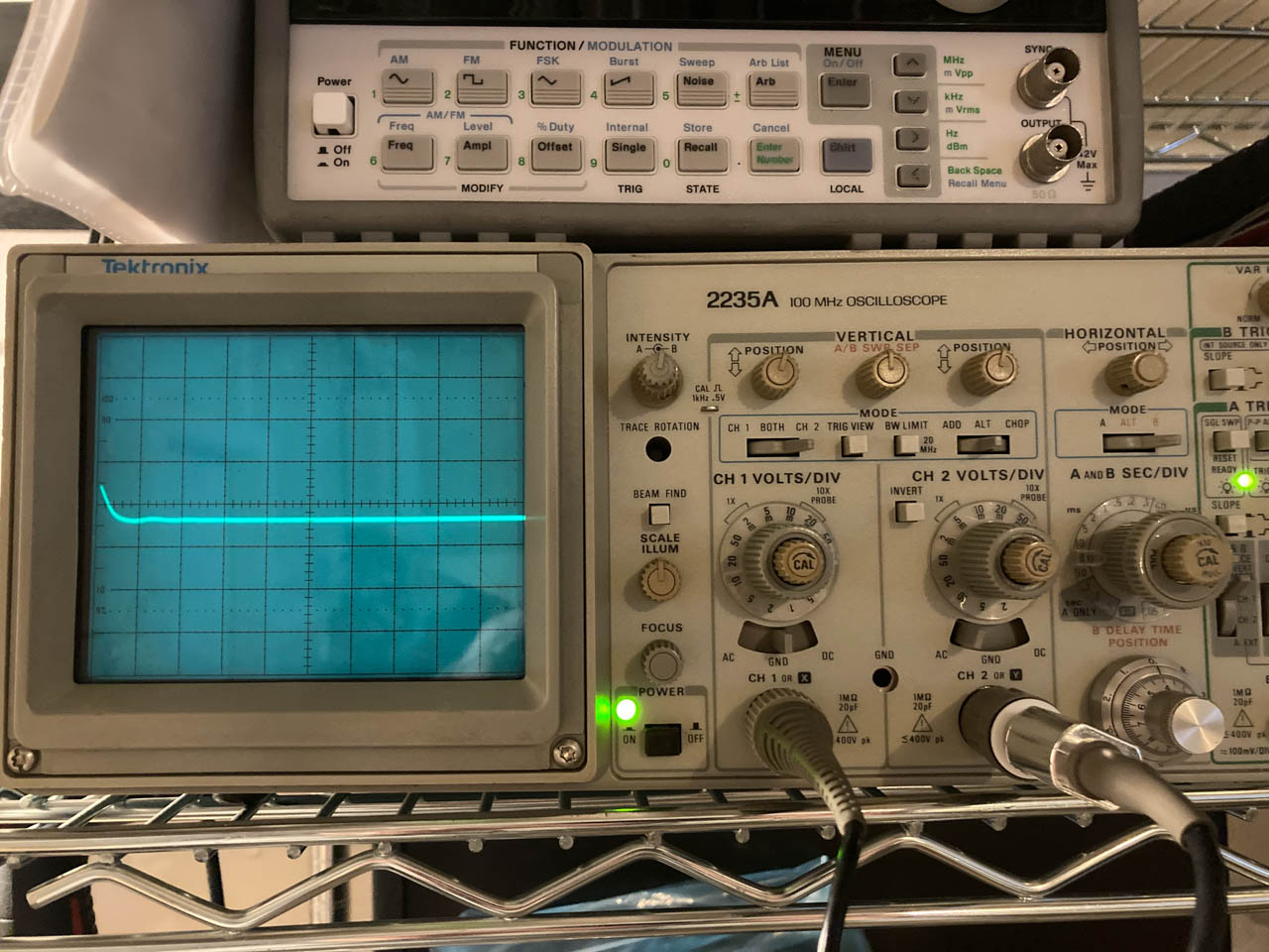

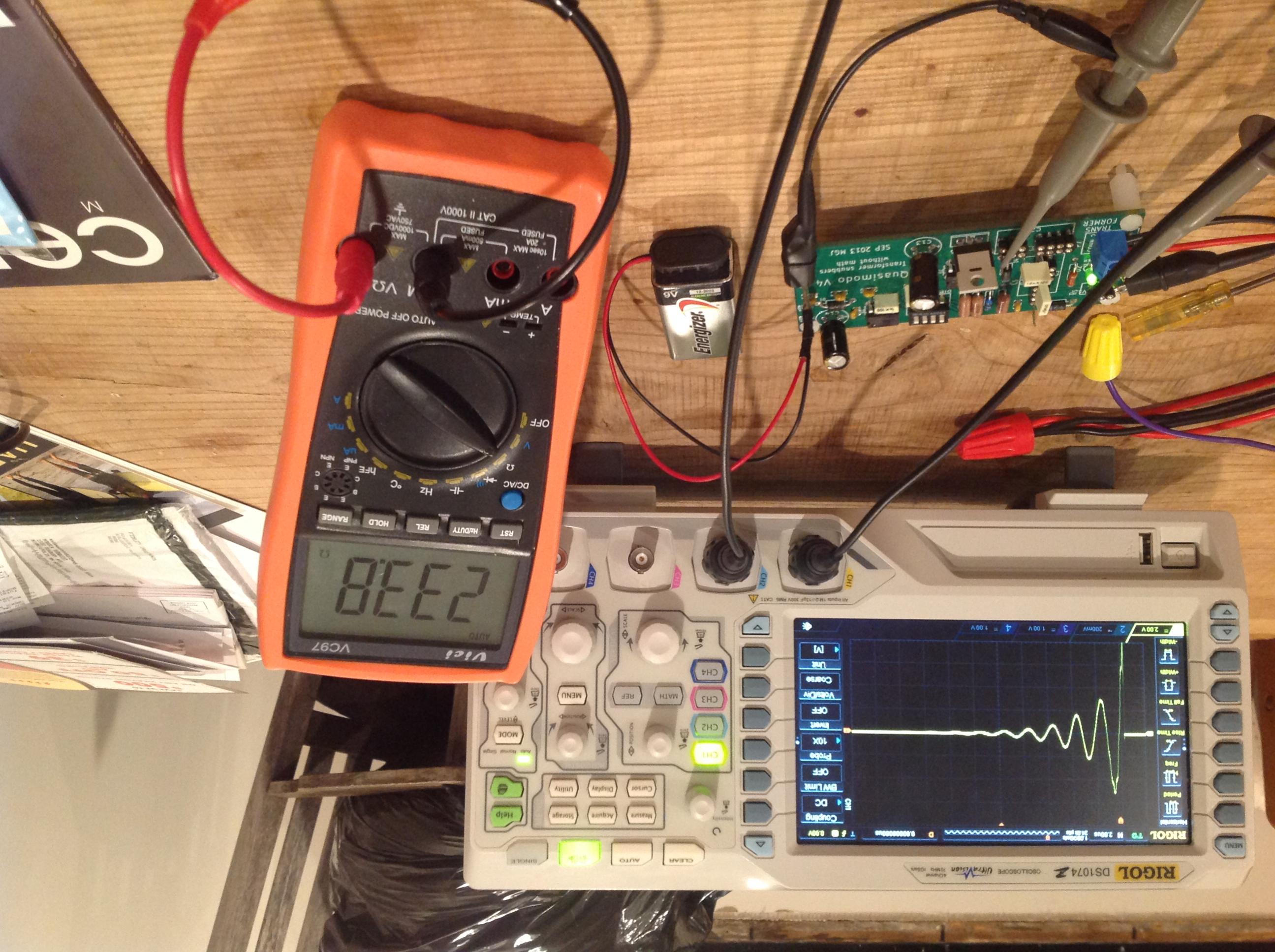

I built a Quasimodo and attempted to use it for the first time.
I'm testing a dual-primary/dual-secondary AnTek toroidal transformer.
Shorted each primary winding and one secondary separately.
The remaining secondary was connected to the Quasimodo.
I'm fairly novice at using an Oscilloscope so it took me a very long time to get the triggering working.
After going through the process in the PDF, the resistor read 31ohms for both sides.
Does that sound like a reasonable result?
I attached screenshots of the scope with inf.R and 31R.

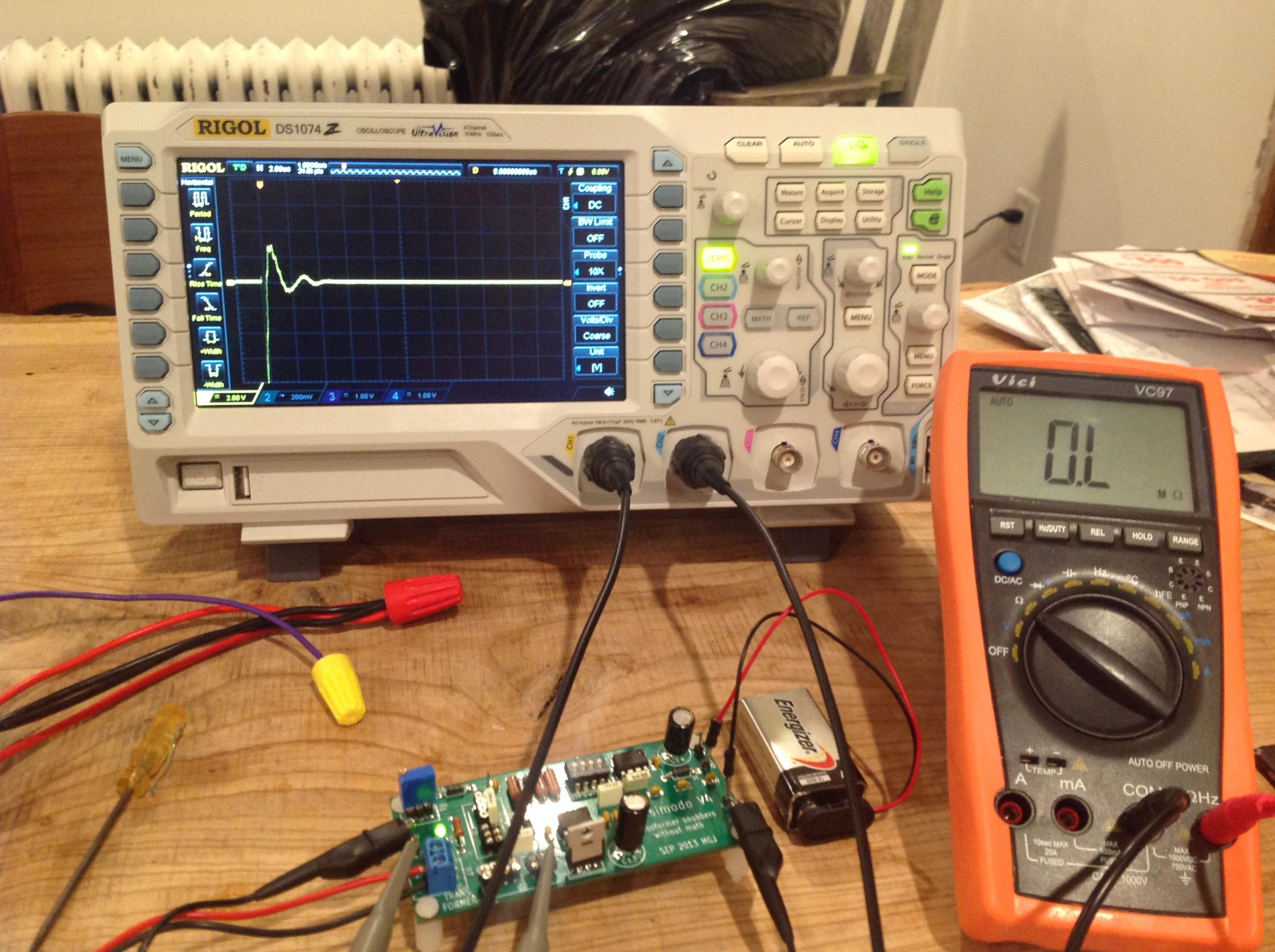

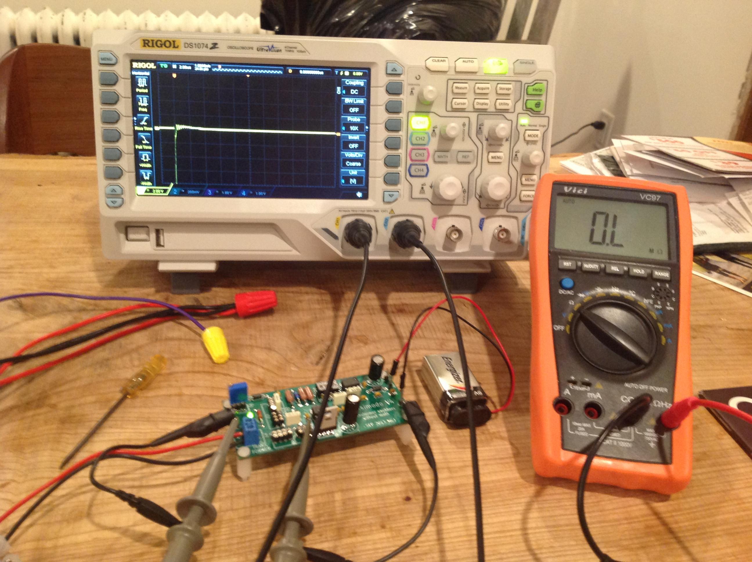

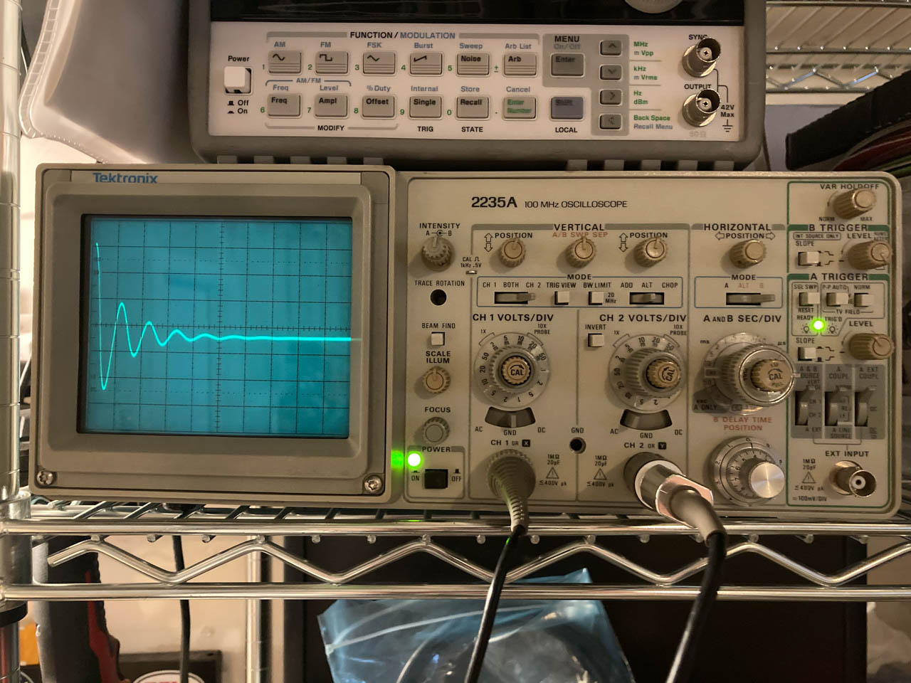

Me too. It took me one day to remove the 2 chips I had installed backwards, and resolder new ones. The LED is bright green now.
Took me all afternoon to remember how to hook up the scope. It's been years since I used it.
The transformer is an Antek 3222, with C2 and C3 values of .001 and .15uF respectively. Will post all details on the results thread after I run the other secondary.
The first photo show the waveform with no RV1 in the socket (upside down, not sure why?) Then photo2 with a few turns at 64.8r, photo3 shows what I thought was good at 19.1r, then the last one Photo4 (did I go too far?) at 9.0r.
I guess I feel that a resistor with value between 9 and 19 ohms should do the trick to dampen the waveform unless I hear otherwise from the experts on the thread, or the other secondary gives me wildly unexpected results.
Thank you Mark for making this accessible to someone with as little experience as me!
Sixto

Hi itsikhefezz,
I'm not as experienced with the Tek 2235 as some of the folks here, but I did notice a couple things ..
- some of the trigger challenges could be from using the B trace -- that requires adjusting 2 thresholds, plus holdoff; B sweep is really for another test situation altogether
- it might help if you stick to DC coupling 'til you're more comfortable -- especially with a low-duty-cycle signal (as this is)
- probably just a personal preference of mine, but I keep the Var knobs in the CAL position, except for special instances -- it has saved me a misleading *measurement* more than once
Overall it's looking pretty good to me ..:)
Is this a great piece of kit, or what?! Thanks M J
Cheers

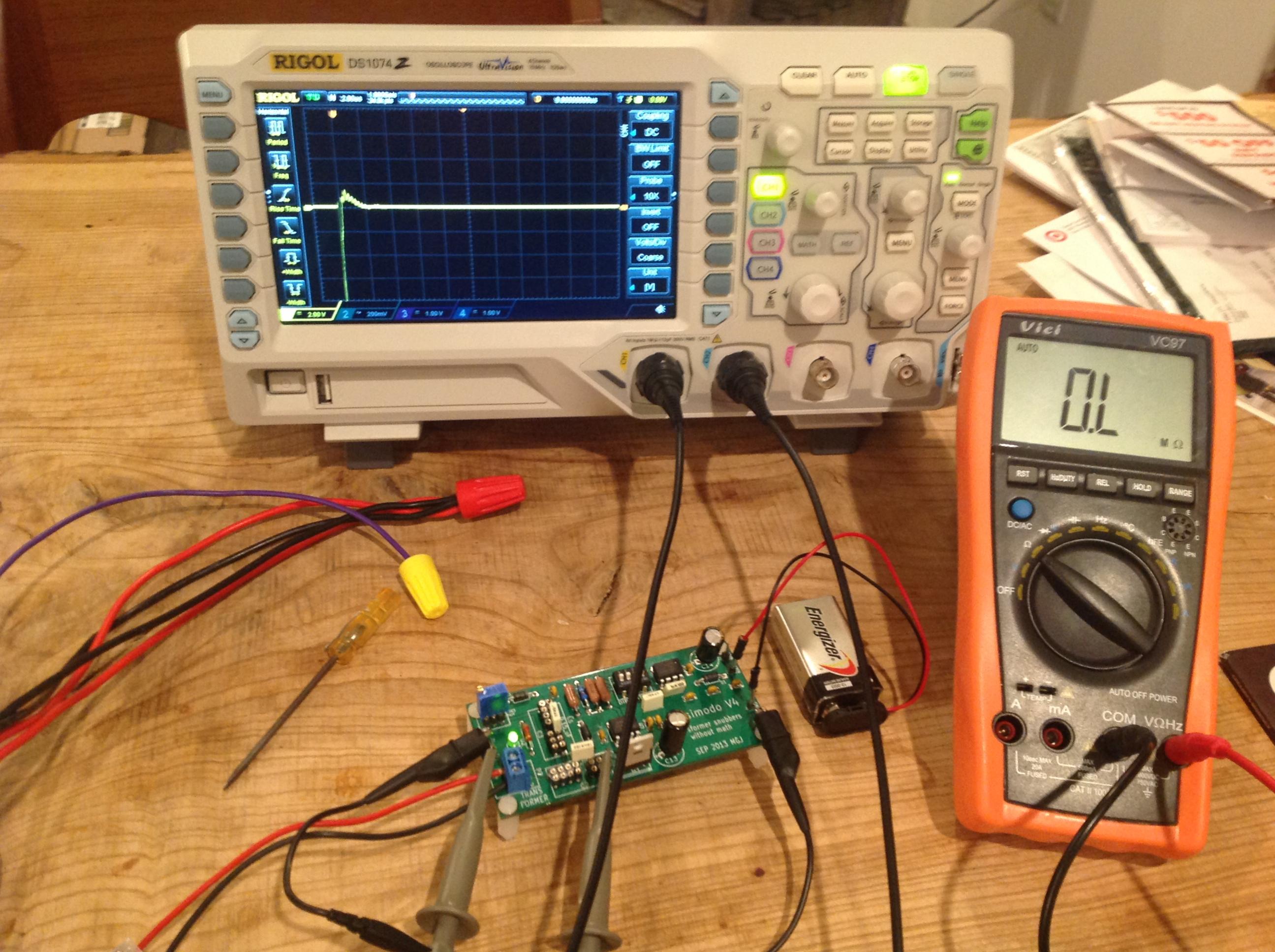

Follow-up
The transformer is an Antek 3222, with C2 and C3 values of .001 and .15uF respectively. Will post all details on the results thread after I run the other secondary....
... a resistor with value between 9 and 19 ohms should do the trick to dampen the waveform unless I hear otherwise from the experts on the thread, or the other secondary gives me wildly unexpected results.
Testing the other secondary (V-) gave me similar results (within 2r), so that's good. I also moved the probes from a pin inserted into the empty sockets spots at c2 to c3 and results were the same. The DIP switches made some difference to the waveforms after I adjusted the scope to maximize visibility, but not enough to change the results. So I'm Going to split the difference and get some 15 ohm resistors for both secondary snubbers. Fun stuff!
Sixto

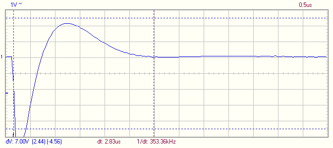

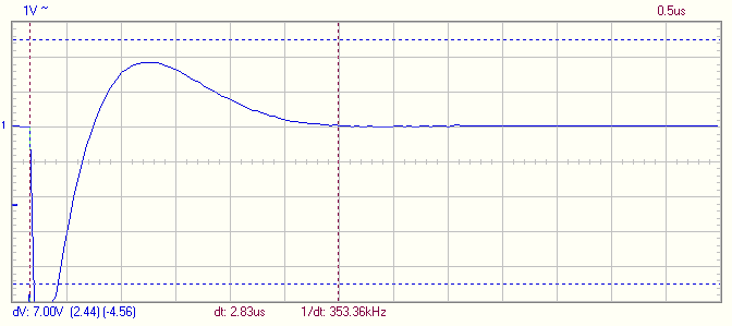

After many year i finally got down to building and using the Quasimodo. I used Cx=10nF, Cs = 150nF.
While I managed to fine tune and got a waveform with Zeta = 1 with Rs of 36ohm to 40ohm, the second peak level was still almost 2V, is that a cause for concerns. Does that means i need to tweak the Cx or Cs values?
Alex
