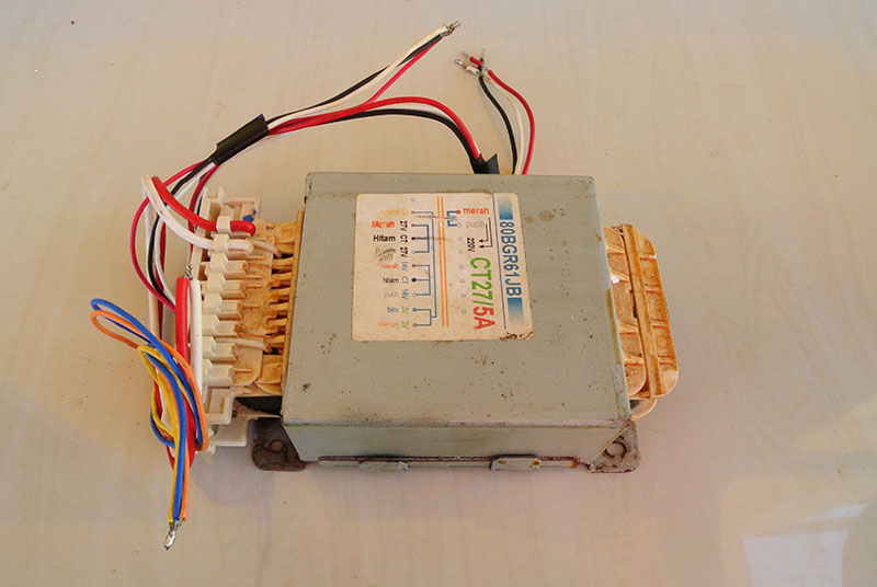

Here is mine
using EL Trannies, using part that i already have
Cx = 10nF, Cs = 220nF and Rs = 5K pot parallel with 2K2
Rs about 45 Ohm

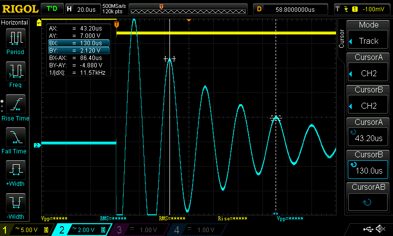

Here is mine
Rs about 45 Ohm
Thank you for the data, but I must say that I have mixed feelings about including this transformer into the table. It is a device with three different centre-tapped secondaries, and it would be very interesting to see what Rs values would be obtained by ringing each of them separately (I don't remember having seen a transformer like this in this thread).
As it is I could enter the results for the single secondary (I guess it is one of the two with the lower voltages), and then only thanks to the scope screenshot you attached, from which I can visually estimate a ringing frequency of about 270kHz. I'd rather had a measured value that I asked for in my previous post; and having produced this screenshot you were only a few simple steps away from actually measuring the ringing frequency. I'm sure your scope has cursors, and if you look at the screenshot below that illustrates the method, you only have to position them two or more peaks or valleys from each other, read off the time difference between them, and calculate the frequency. In the example below, the cursors are three periods away from each other, so the ringing frequency is three times higher than the value 1/[dX]=11.57kHz displayed, i.e. 3*11.57=34.7kHz.
Returning to your results, with the ringing frequency of 270kHz the theory predicts Rs=42 Ohm for Zeta=0.707, which checks with the value you obtained experimentally. Well done!
If you're handy with Excel or another worksheet software, you can enter the data into your local copy of the table and have a look at the results yourself.
So if you feel like measuring the other two secondaries as well I would be glad to include them into the table.
Braca
P.S. I'm not publishing the table now in order not to overload the thread; I'll be happy to do it each time a couple of new entries have been made available.

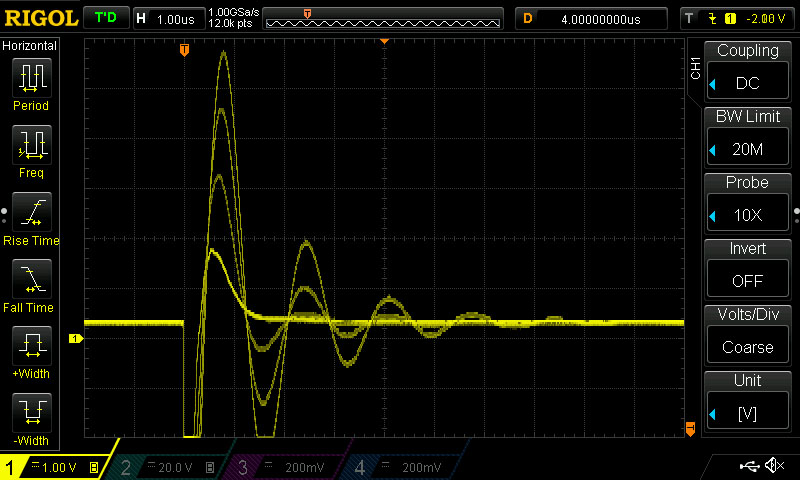

You don't have to put it on list, seller of this transformer says this trannies a surplus parts from Sony/Panasonic equipment and i believe the population on martket is very small
Thanks for your explanation, i'm still trying to "understand" what are you wrote. Since my math is no good
Actually i had measure for 14-CT-14 too and got smaller Rs about 21 Ohm, but not measure 3-0-3 since i'm not using it.

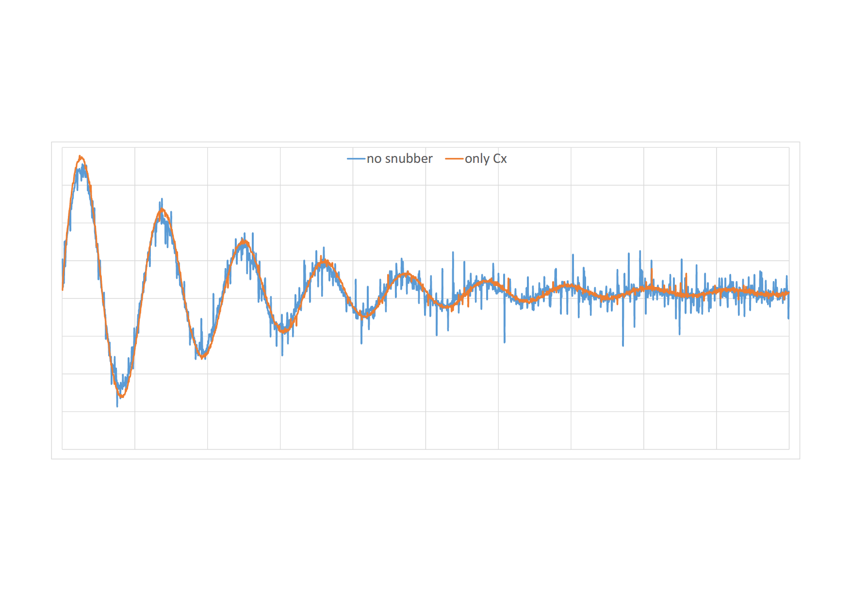

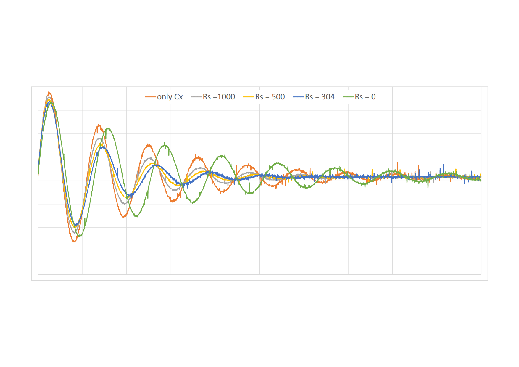

I did my own Quasimodo ExtraLight experiment.
R-core transformer is a Toroidy Audio grade 400VA 2x18V. All leads are open, only one secondary attached to a square wave generator at 110Hz or so.
R1 = 10kOhm, Cx = 10nF, Cs = 150nF
Scope traces for different Rs are attached. I find the lowest amplitude of the ringing with Rs = 304 Ohm. But I can't quench it.
Is this expected? Shall I change anything?
I also attach two traces, one without any snubber element, and one with only Cx. The difference seems only to be in much lower noise.
Edit: traces are 0.2ms/div and 50mV/div, approx.

R-core transformer is a Toroidy Audio grade 400VA 2x18V. All leads are open, only one secondary attached to a square wave generator at 110Hz or so. R1 = 10kOhm, Cx = 10nF, Cs = 150nF
Unfortunately that's not the correct way to connect Quasimodo (or its ExtraLight progeny) to a transformer for oscillatory ringing tests.
Please see Figures 2 and 13 of the Quasimodo design note, a .pdf file attached to post#1 of this thread. Carefully notice the bold black shorting bar(s) in Fig.13.
Thanks for the swift reply. I'm reading it as we speak...
I tried shorting the primary and the other secondary when putting the pieces together. Unfortunately I couldn't get a signal that way.
May have to go down with R1.
My square wave generator does some 7V.
