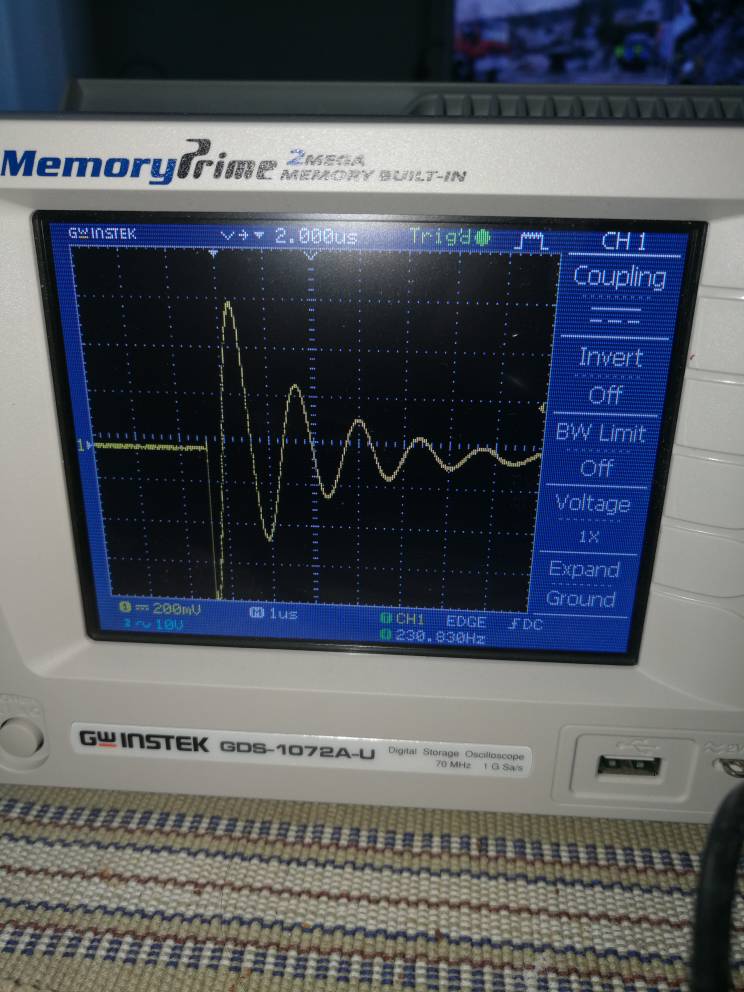

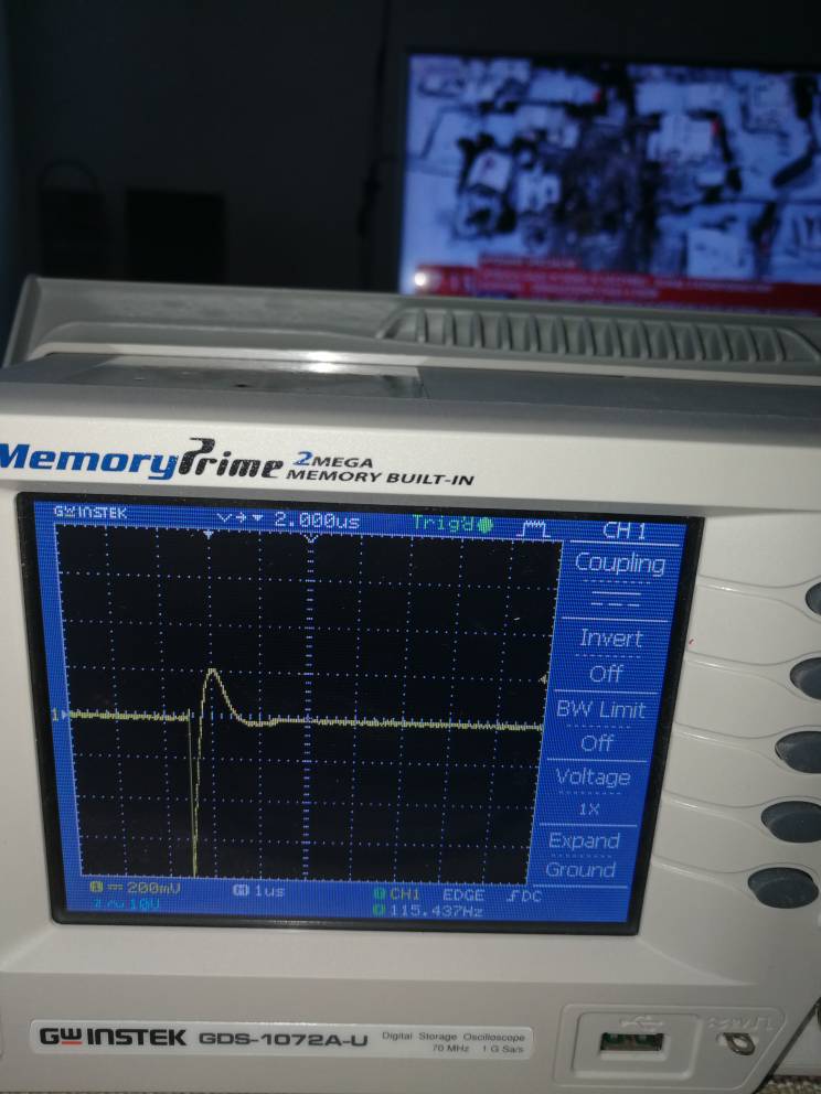

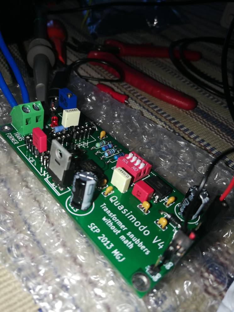

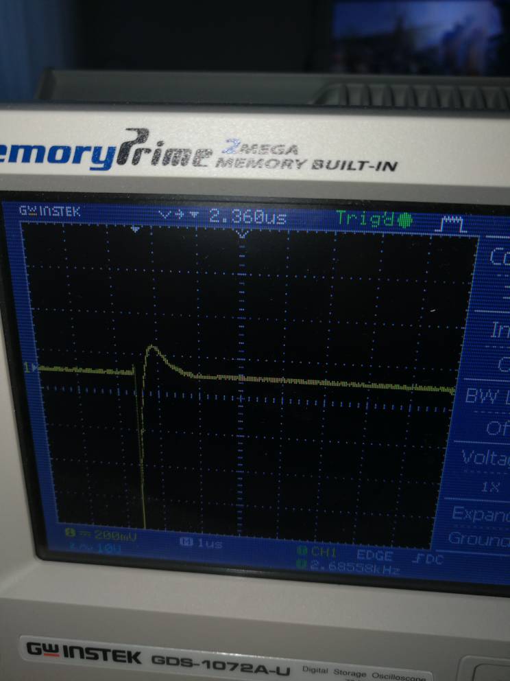

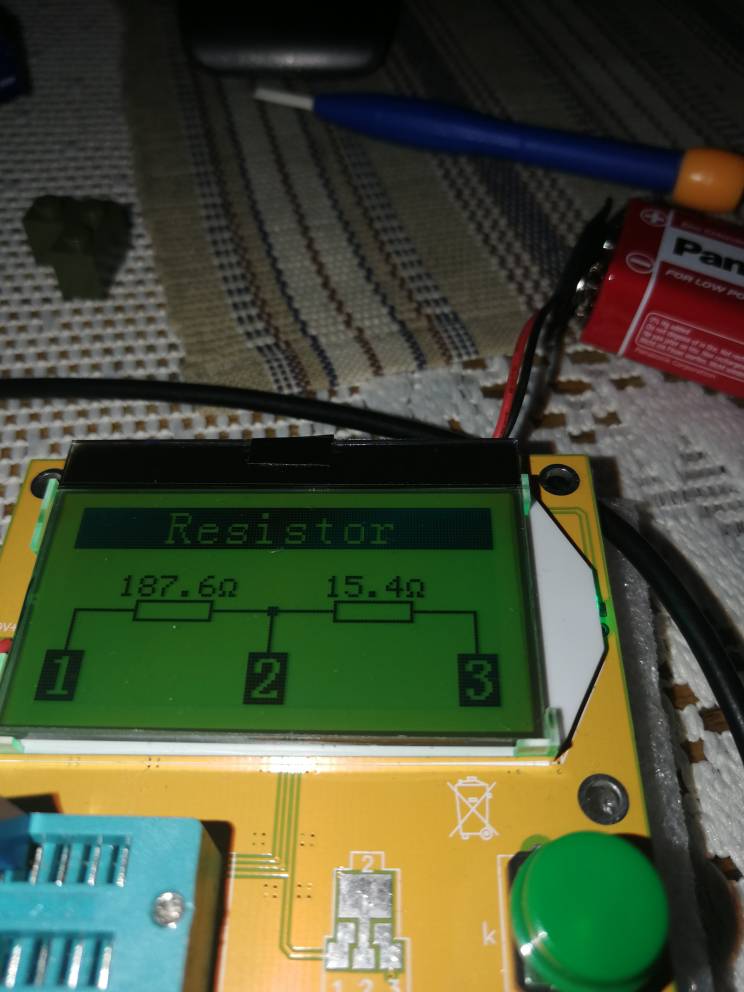

My first fun with the oscilloscope I'm not sure if I'm doing the right Potentiometer reaches 23.5 R (counting from the left between legs 2 and 3) Below is a straight line. Any advice? IMG_20191205_100654.jpgIMG_20191205_101356.jpgIMG_20191205_101836.jpgIMG_20191205_101918.jpg
Darr, the second-from-left photo is what you want to see. You probably want to buy a 200 ohm trimmer and also a 50 ohm trimmer for fine-fine-fine tuning. Many 1K trimmers become janky and ill-behaved below 50 ohms; especially the cheap ones from eBay or AliExpress or Futurlec or Tayda.

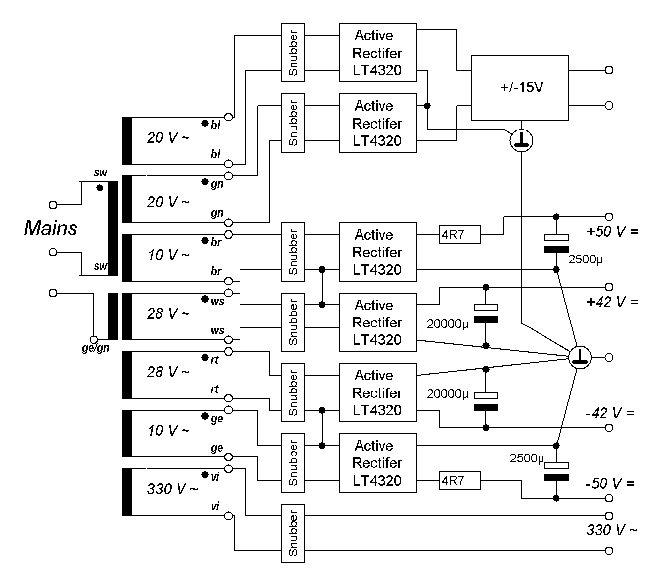

here is the schematic of the needed Powersupply (for an active Speaker) based on existing Power Stages with +/-50V for the voltage amp part and +/-42V for the VFET Powerstage. The Transformer is 750VA.
I have drawn this supply with my take of how snubbers would have to be placed and connected. So, I am looking for
1. verification of snubber placement and
2. for the correct measuring method to define values for all the snubber parts.
My guess for 2. is to short the windings I'm not measuring, with the exception of the staggered 28V/10V Windings which may have to stay open. Please let me have your advice...
Thanks and Regards,
Winfried

Wgh52, the key to deciding your question is found in the title of this thread. What you want is a "Transformer Snubber" -- six of them, actually.
Your diagram in #1729 shows the snubbers connected across the rectifier inputs; your diagram represents an attempt to snub the rectifiers.

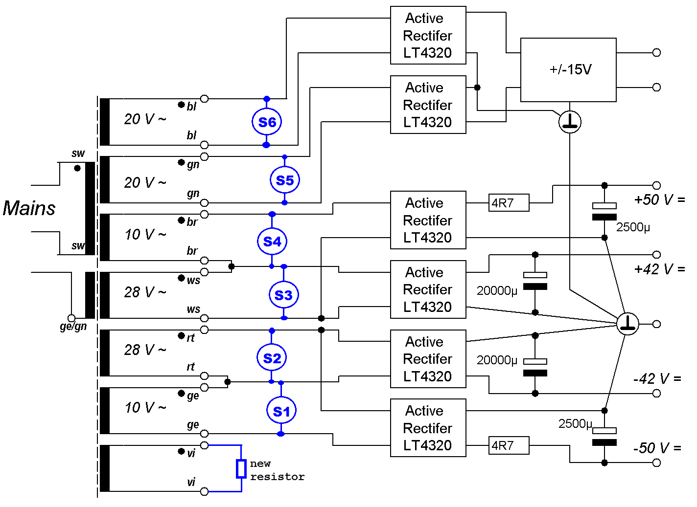

But that's not what you want; instead, you want to snub the transformer windings. So you reposition the snubbers in such a way that each individual transformer winding has its own snubber, as shown in the attached diagram. There are six windings and six snubbers; each snubber is connected directly across a winding.
I also show a resistor connected between the violet wires as some kind of a "termination" of the seventh winding. Personally, I simply do not care for floating wires; too many years designing CMOS might be the reason. I'd use a 1 watt resistor, whose value is chosen so it dissipates 1/4 watt in normal operation. Giving you a nice safety margin and a cool running part in a dormant piece of circuitry.
To optimize snubber number S3: make direct short-circuits across all other snubbers and across the violet wires and across the mains terminals. Every winding is shorted except ws-to-ws. Connect these two wires to Quasimodo and proceed.
Repeat another five times, individually optimizing the Rs values for the six snubbers.
Done!

Hello Mark,
you cannot believe how thankful I am for your thorough analysis and the clear advice! I understand snubbing better now as well...
I had intentionally omitted the circuitry fed by the vi-winding, because it produces 320V= which "just" precharges a capacitive signal sensor built into the Backes&Mueller 38mm Alu-Dome-Tweeter, producing a feedback signal to control correct dome-movement. From what I learned now, this winding should get a snubber as well - IF the needed parts, my Scope and Quasimodo can handle the voltage, though. We'll see...
Thanks a lot again!
Winfried

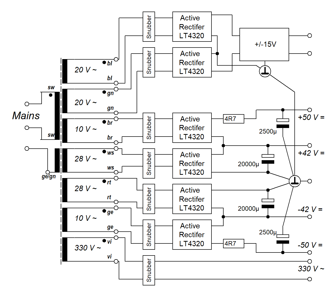

[off-topic-on]
A small off-topic to avoid potential problems for readers interested in LT4320 usage:
The staggering of windings voltages needs attention when using the LT4320! Staggering before rectification does not work, it has to be done after rectification! Therefore a tweaked block schematic...
Sorry for the mistake,
Winfried
[off-topic-off]
