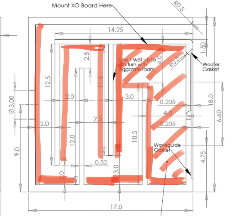

Im a little lost here about this Purifi TL thread,, but where to put the
the damping.
You are so active xrk971!
Could you sketh up something?
And also an Xsim with Dayton audio rst28f-4rd without WG-300 or what crossover you recommend.
It's nearfield listening listening for me,
desktop.
I have the speakers mounted in a 10L old box and it's the best I heard!
But going to build these TL!
Love you for your DIY affort!
Hi Solve,
I tried damping with one wall of the labyrinth covered with eggcrate foam and without. Both times the rear chamber of the TL adjacent to the driver is completely covered in eggcrate foam. I think I like the version where the labyrinth has one wall covered in foam per the original sketch is best. It helped to reduce a 300Hz resonance bump. You can completely substitute the eggcrate polyurethane with melamine foam and that will be even better. The melamine won’t rot in 20 years and absorbs the back wave better.
Here is sketch of the damping plan, use 10cm melamine sponges if possible or the thinner eggcrate foam. Not 2in thick eggcrate in labyrinth as that would construct flow too much. The last bit of foam on back wall is something I think may help but not tested yet. If you made a removable back wall that can be adjusted. Else, there is risk it may be too much damping. But I think the 1cm thick melamine should be fine there.

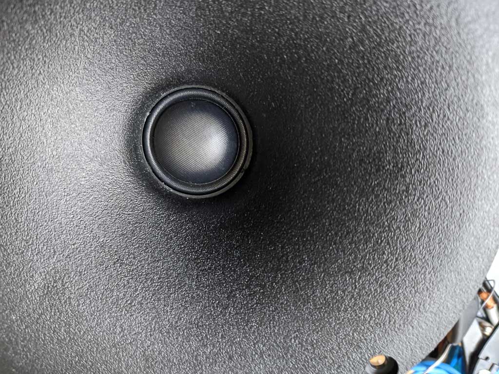

Never mind, I just saw that the RST28F is supposed to work on the waveguide as well. Although the (axial) frequency response appears to be significantly different at certain ranges. Also, how well behaved is it non-axial, 0° - 60° horizontally?
Can the bigger grille of the RST28F be removed without too much risk of damaging anything? Would this allow it to be mounted to the waveguide without additional felt?

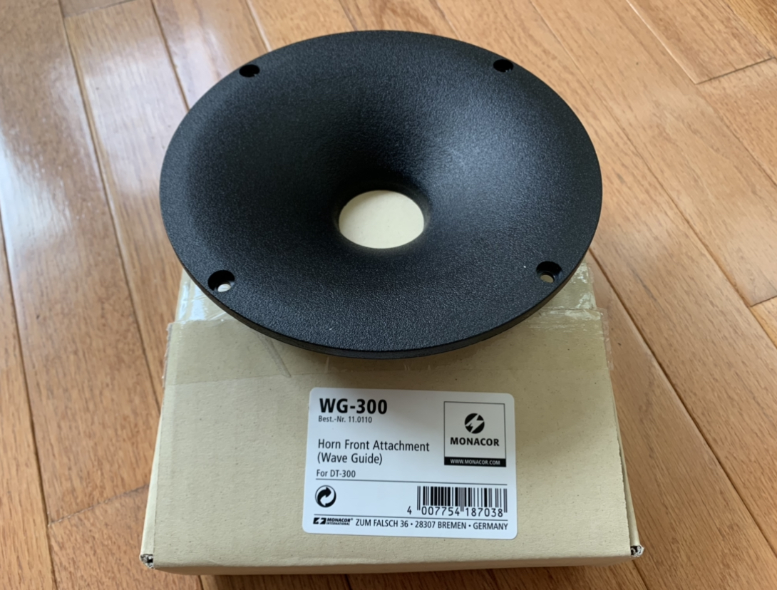

My new set of WG300 waveguides just arrived. That was pretty quick - shipped from Sound Imports in NL. 10Euro for a made in Germany waveguide with shipping was about $50 for the set. Nicely made with brass thread inserts in the back. Much better than 3D printing at home. Just print the adapter is more effective.
attachment.php
attachment.php
STL file for the adapter plate is here:

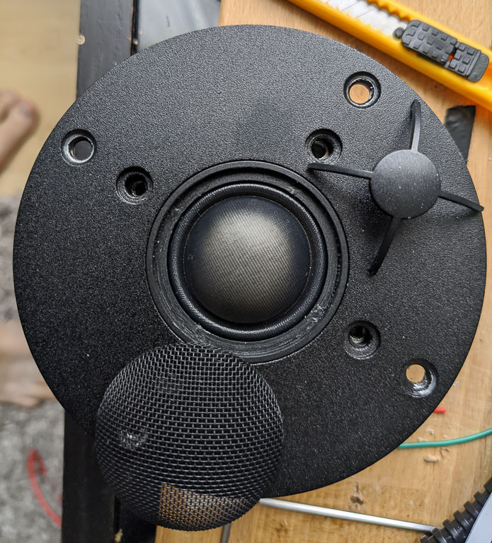

I had an broken RST28F to try out to dissmantel the grill and cross.
Some plastic left from the cross but just to work down.
Better fit on WG-300.
Now I need to make the wood adapter.
