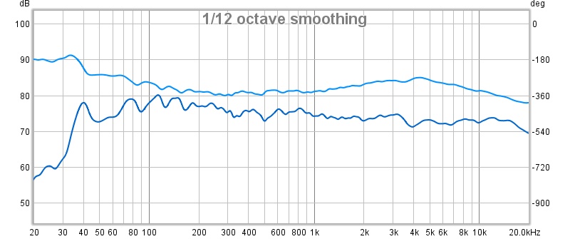

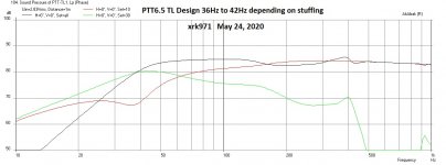

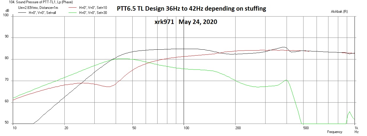

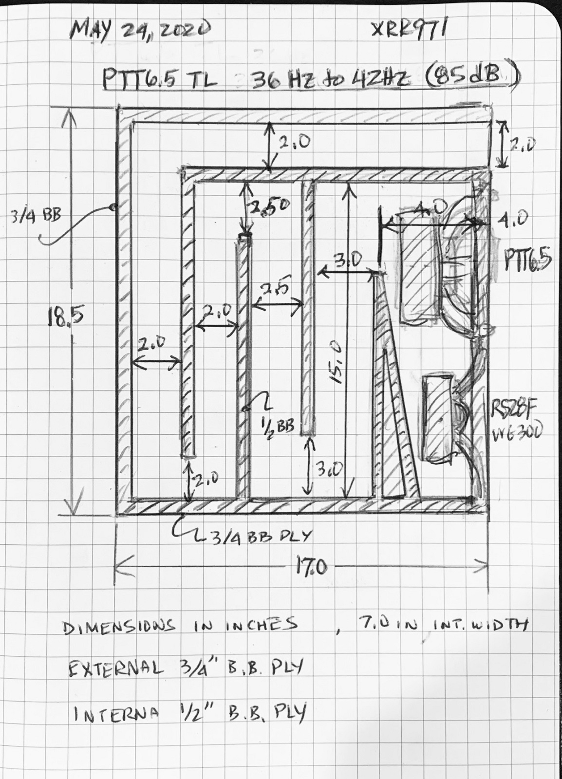

Here is the TL that I just came up with and simulated in Akabak. I am trying to keep it as a fairly compact standmount studio monitor rather than a floorstander. The design achieves between 36Hz and 42Hz -3dB depending on degree of stuffing/damping. Nominal sensitivity is 84.8dB at 2.83v ad 1m. Constructed of 3/4in BB ply on exterior panels and 1/2in BB ply on interior divider panels, box is 18.5in tall x 17.0in deep x 8.5in wide. Internal TL width is 7.0in.
Akabak predicted SPL for 2.83vs and 1m:

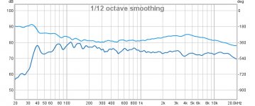

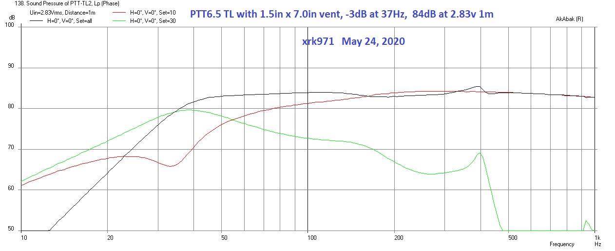

Tweaking the TL design just a bit and decreasing the final height of the terminus from 2.0in to 1.5in x 7.0in wide. This drops the sensitivity from 84.8dB to 83.8dB but gives the bottom end a little more reach with -3dB point squarely at 37Hz. Cabinet height decreases to 18in vs 18.5in.
17in deep x 18in tall cabinet is a very reasonable size for a tapered TL design with 37Hz F3. Should be good for 101dB at Xmax of 10mm at 21Vrms, which corresponds to 120Wrms (this exceeds sustained rms power by 20w), so we are thermal limited not excursion limited. For temporary dynamic peaks, Xdamage of 14.5mm gives 104.5dB max SPL at 30.3Vrms with 250w peak power. Maximum air velocity at vent terminus is 16.2m/s at 104dB and 30.3Vrms, and 11.2m/s at 101dB and 21.0Vrms. And as you would expect, max air velocity is at 37Hz, falling off quickly from there so no chuffing for all but the lowest frequencies. It would be good to use a -12dB/oct high pass filter at 30Hz to prevent over-excursion from infrasonic content if playing at very high SPL's.
Thanks, Zman01. I have also just found out that my cabinet maker who made my last TL's will do these for me as well - he won't be able to start until mid-June though. I still want to make a foamcore/XPS/cardboard pathfinder to test before he starts cutting wood though so I have some time. The RS28F-4 is now replaced by RST28F-4. I wonder if the tweeter is a drop in replacement for the old one?
I am trying to approximate a taper with successive straight sections. The drawing showing a 2in terminus is going to be smaller at 1.5in so each section is getting smaller. The damping takes care of the ripple. The Akabak simulation is pretty accurate and output is quite ripple free as my last two tapered TL’s have proven.

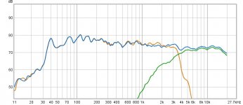

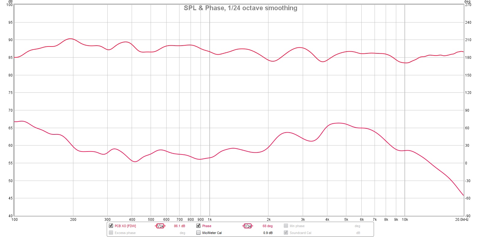

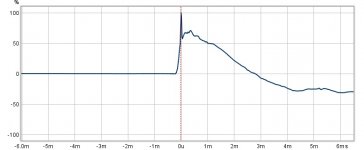

Hi Mainframe,
Looks like you nailed the Harsch XO on your miniDSP.
The indicators are: phase is flat with a 55deg wide band bump to the right of XO point; the combined curve is a little less than the woofer curve to the left of thr XO point; finally, the step response looks great as it looks like a right triangle.
Nicely done! How does it sound?

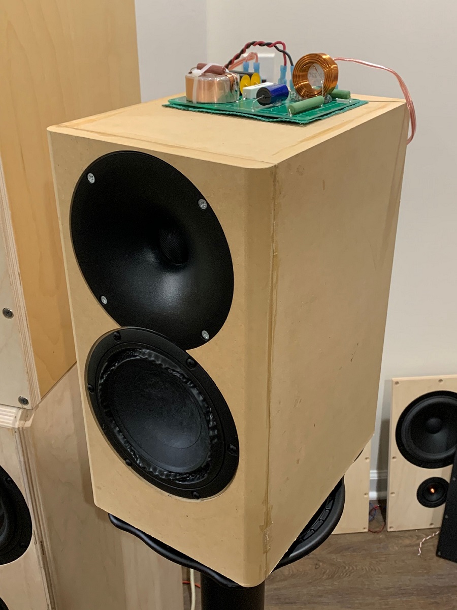

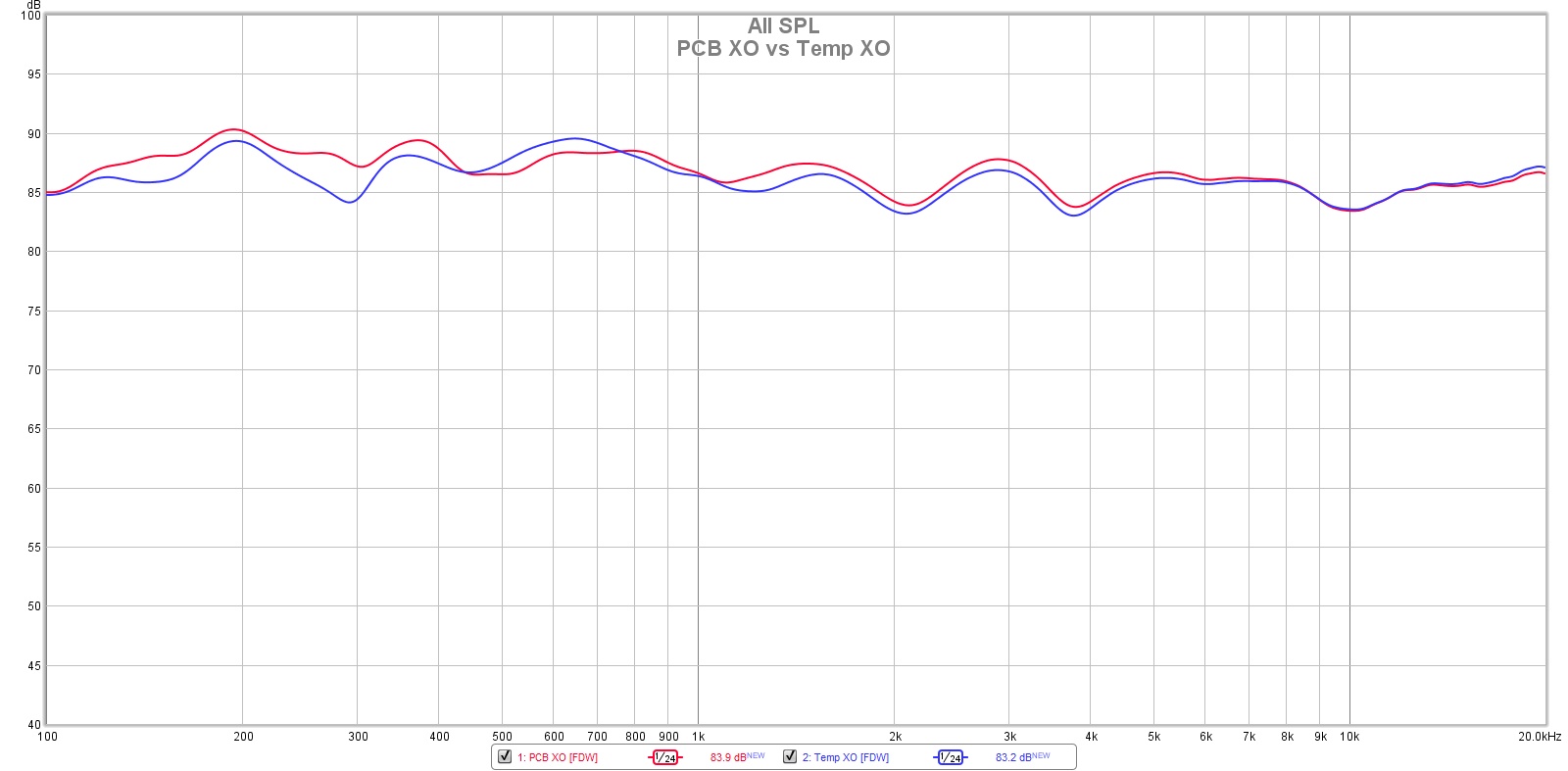

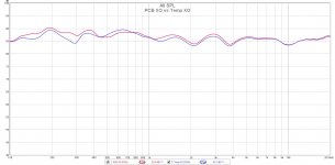

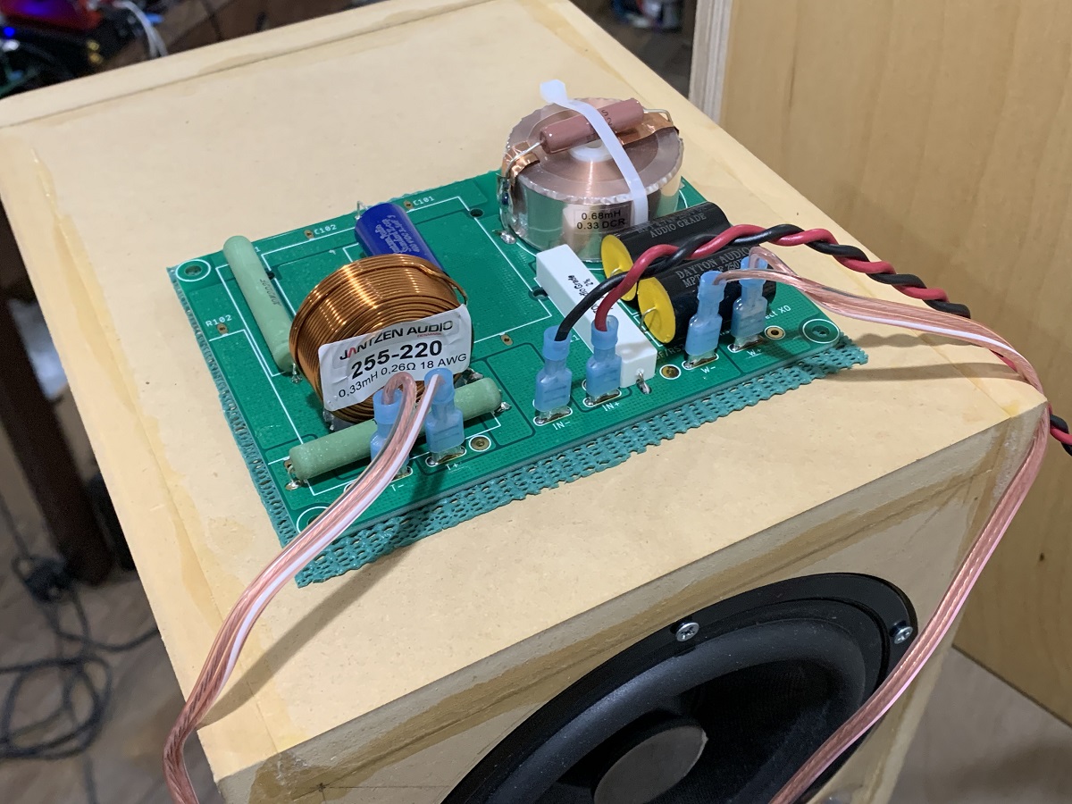

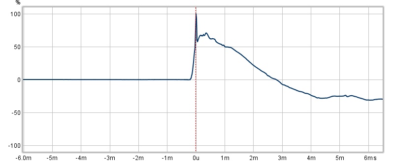

Real XO on PCB
I just got my parts in for the real XO and built it up using my 10F/RS225 FAST transient perfect XO PCB. Plenty of room and the components are nicely held in place. First time I am using a flat copper foil inductor.
Measurement shows a little smoother in midbass, and a tad higher SPL in midbass and lower treble - probably lower DCR values.
The step response and phase still looks good - the rise is exactly 55deg:
