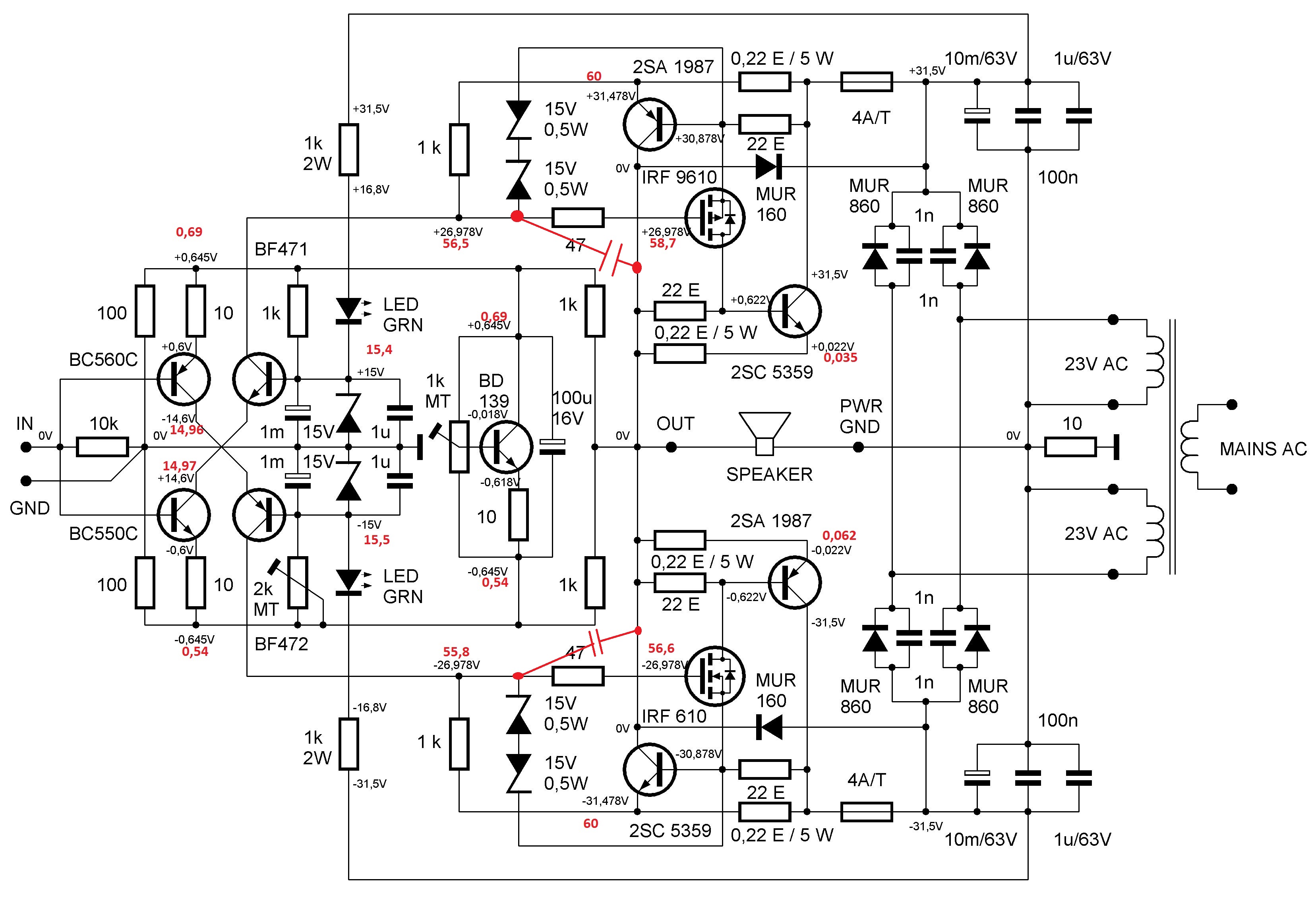

Ok, here's what did
With output bias set to ''0'' i slowly adjust offset to 0V and no problem
Next i tried to rise up output bias to say 30mA, offsset start to swing between -16mV to +50mV, the output heatsink starts to warm a little and those two resistors 33r/10w are hot and if i replace resistors with 2,5A fuse and start to set slowly output bias again the amp burn those fuse
I think your SSA don't like this layout
Any suggestions where the problem might be, or what should i do next?
Your SSA is oscillating, needs frequency compensation. That kind of calibration procedure needs oscilloscope. Please don't connect the amp directly, use rail serial resistors until you surpress oscillations.

Of course, SSA you've build was never build as a real circuit yet, although it is very similar to TSSA CF output topology, but don't worry will tamed the beast.Any suggestions where the problem might be, or what should i do next?
Your SSA has not even one compensating capacitor, that is why it is oscillating, so first you must add:
- 100 pF mica capacitor from input bases to GND, as close as possible to input transistors
- serial RC from output to GND, 10 Ohm/2W in series with 100 nF/100 V
- 1 uF/63 V capacitor from rails DC, after the fuses to GND
After this measures will be taken, please report the situation.

Instructions I gave you were just a start, so proceed from there on.
Now you need to add serial RC compensation from mosfet gates to rails. Use 100 Ohm trimmer in series with 50 pF trimmer on both mosfets. For this calibration you would need oscilloscope to observe the output. Fine tuning of these trimmers will set the amp below phase margin and prevent it against instability - no oscillations.

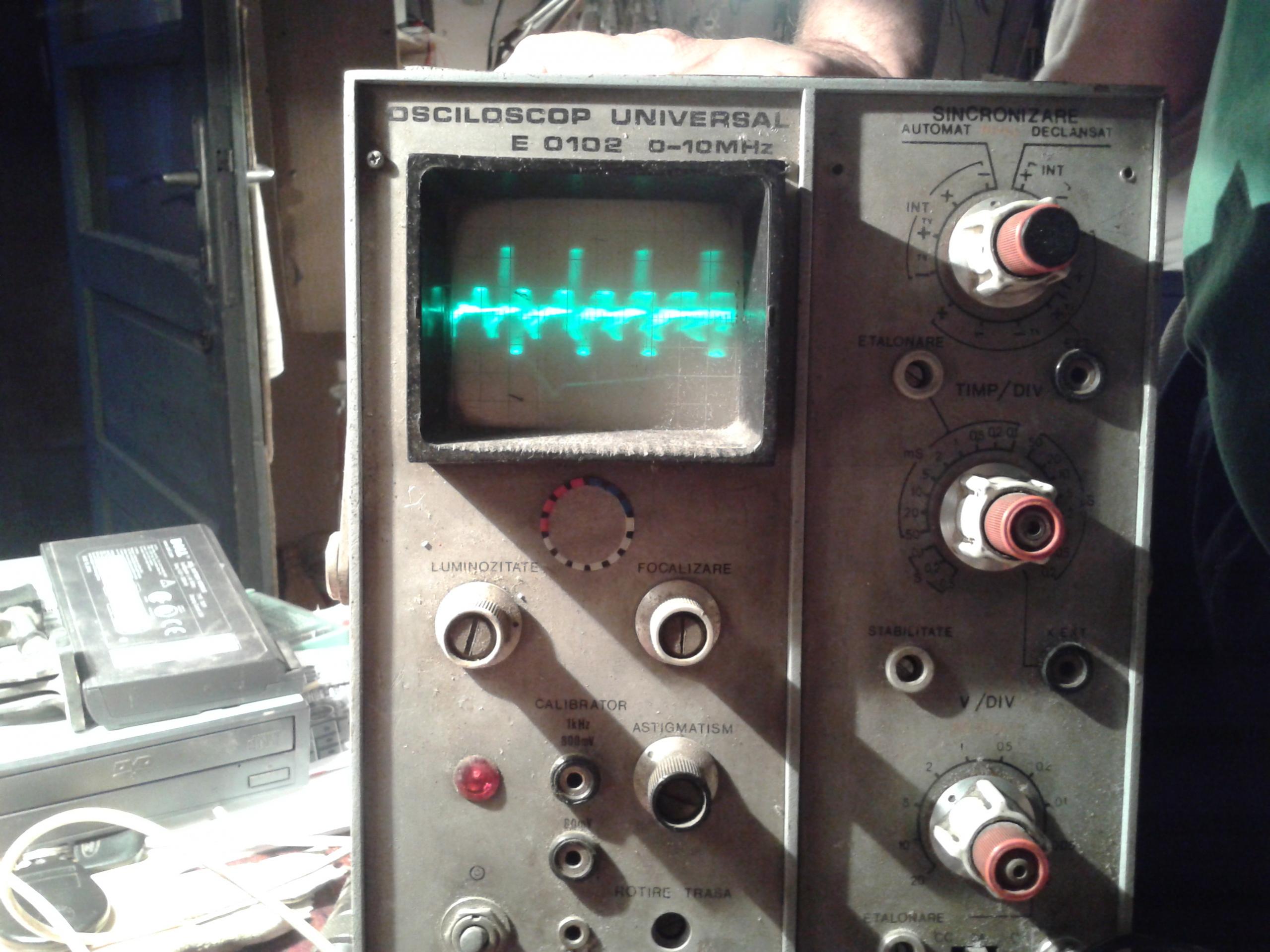

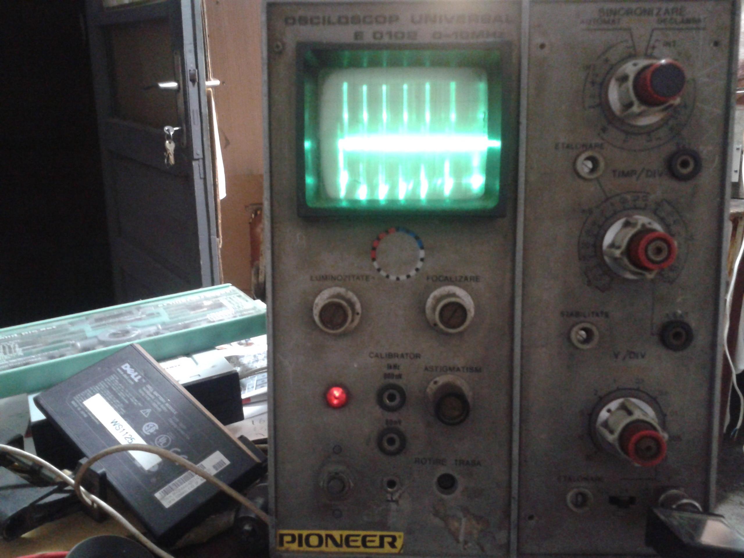

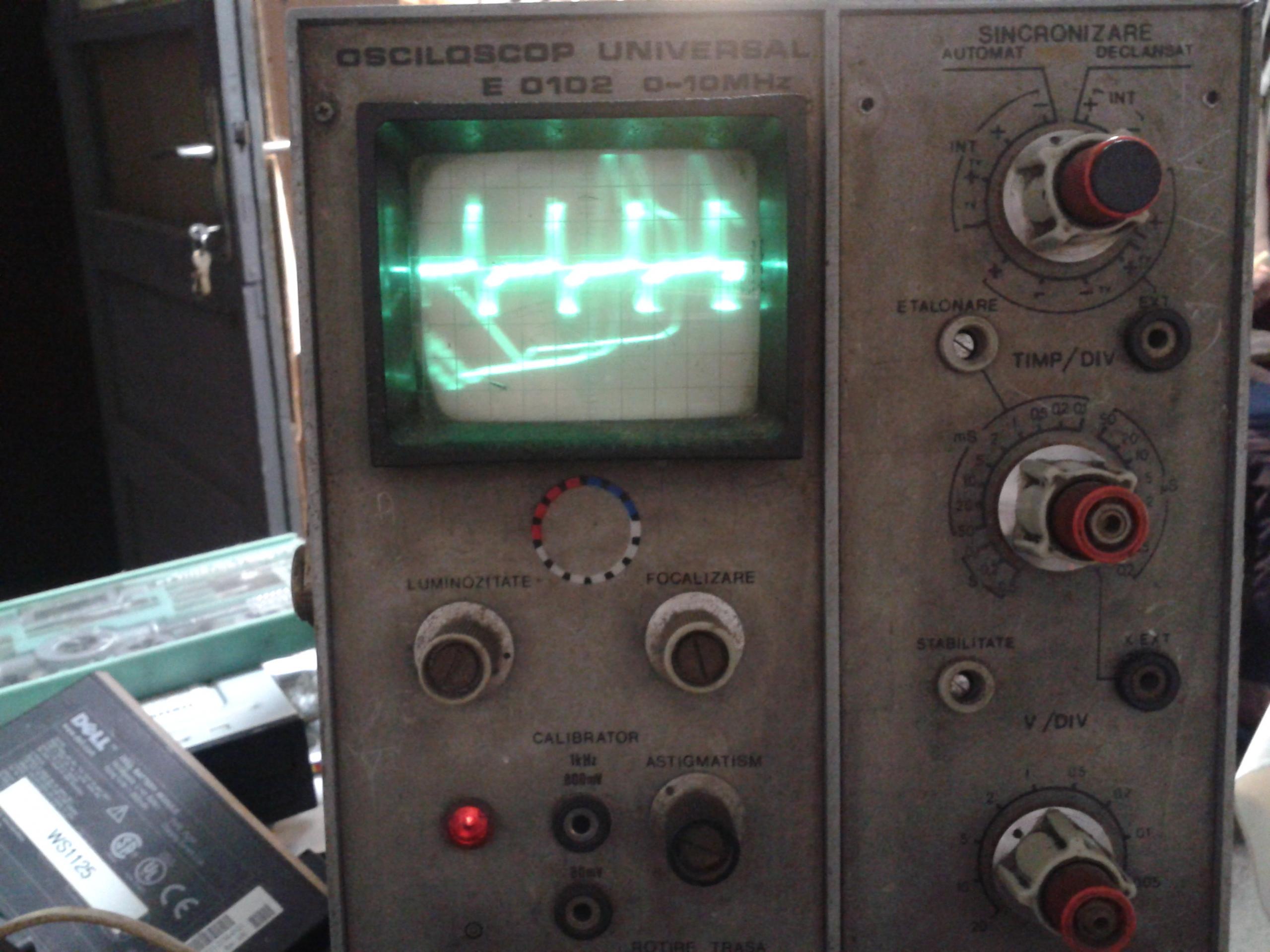

I manage borrow a o-scope
I mount 100 ohm trimmer + 47p on each gate to rails
If i adjunst trimmer from the positive rail nothing happens, if I adjust the trimmer from gate to negative rail more oscilation appear
How should i proceed next?
Both 50 pF capacitors must be trimmers otherwise calibration is nonsense. The whole aim is to set the amp's loop gain below 1 at frequency where phase shift is over 120 degrees. You can also try small capacitance from gate to GND if compensation to DC rails would be uneffective.

I follow your advice but it's worse

OK, according to scope plots, there's also some other problem in your circuit than just an oscillation, as so complex scope signal indicates that. Usually theres HF sine or its modulation at large. I know it's difficult for beginer to start and solve such wild amp conditions, especially if nobody built it before. This SSA version for sure can be stable, if I'll catch some spare time maybe I'll do it, but at the moment everything from me is dedicated to VSSA.
