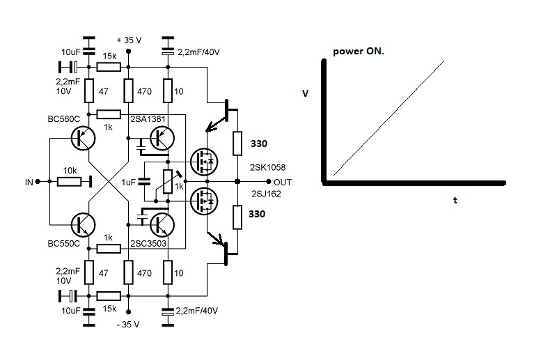

VFET cascoded VSSA could be like this:
(resistors protecting the gates can be initially higher; 1k perhaps)

I suppose CFA SIT (as you use NEC, not Sony V-FET) should be the fastest amp and thus the most musical). I have a couple of pairs of Tokin 2SK180 and would like to try them out as well in CFA design. But it must be a new thread than.
Never tried VSSA or TSSA, I think they are low power amps in comparison with SSAHP, not fit my needs.
Any complementary pair of VFETs will do. I also have Sony (SK60 and SJ18?), I don't remember.
There is one high power VSSA (BIGBT or something like this) and you could parallel outputs like Sony-TA N7.
Tokin Sk180 should be in "quasi" output, like Yamaha, but the biasing would be tricky. The good about the cascoded VFET is that they bias themselves; you only have to provide the biasing for the BJTs. 😉

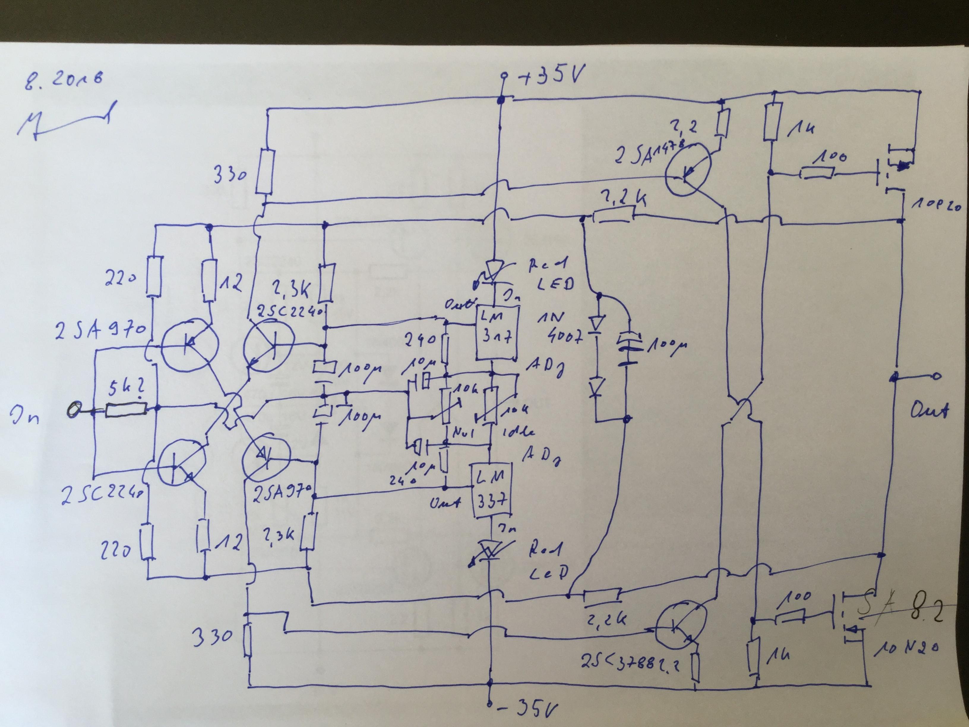

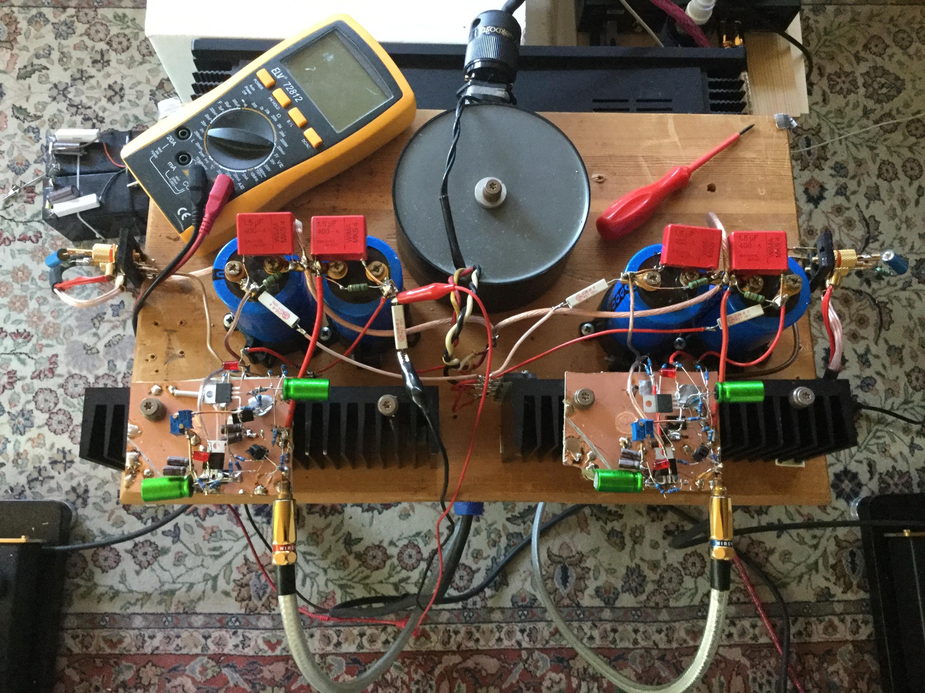

It worked right away but was a bit oscillating. It is very wideband so it amplifies nearly all what comes in. After i put the input filter it was quiet. I later reduced the filter to 1.2kOhm and 100pF. All that is left is a small is a small buzz that is only audible when i put my ears close to the driver. From the listening seat it is quiet and my speakers are 94dB sensitive.

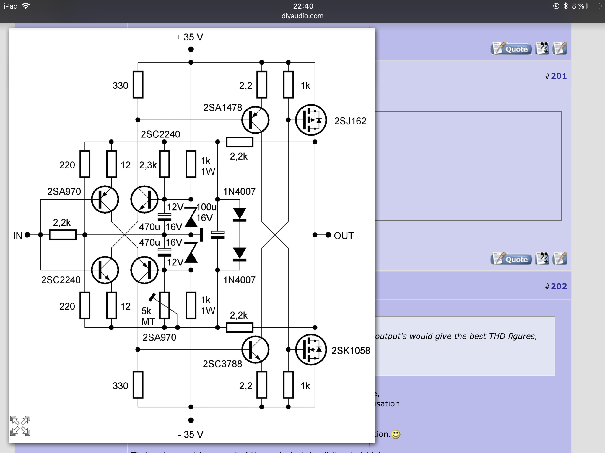

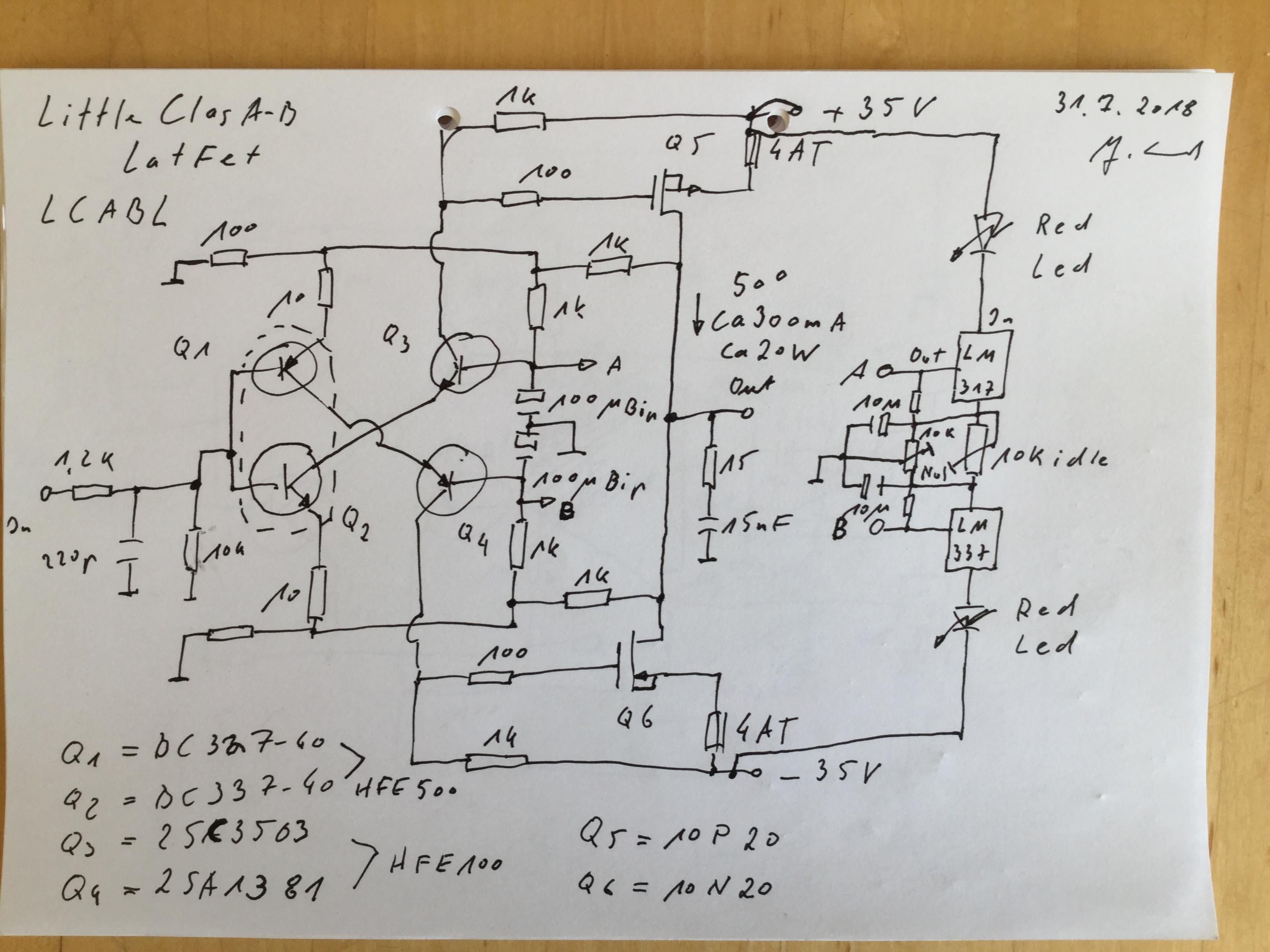

After my request Laty Cat made this circuit. I would like to build it next.
Maybe the voltage regulators could be used here too, plus provision for adjustable idle and offset nul. Whould be great if the input impedance could be raised a bit.
Maybe Lazy Cat finds the time to commend on this.
