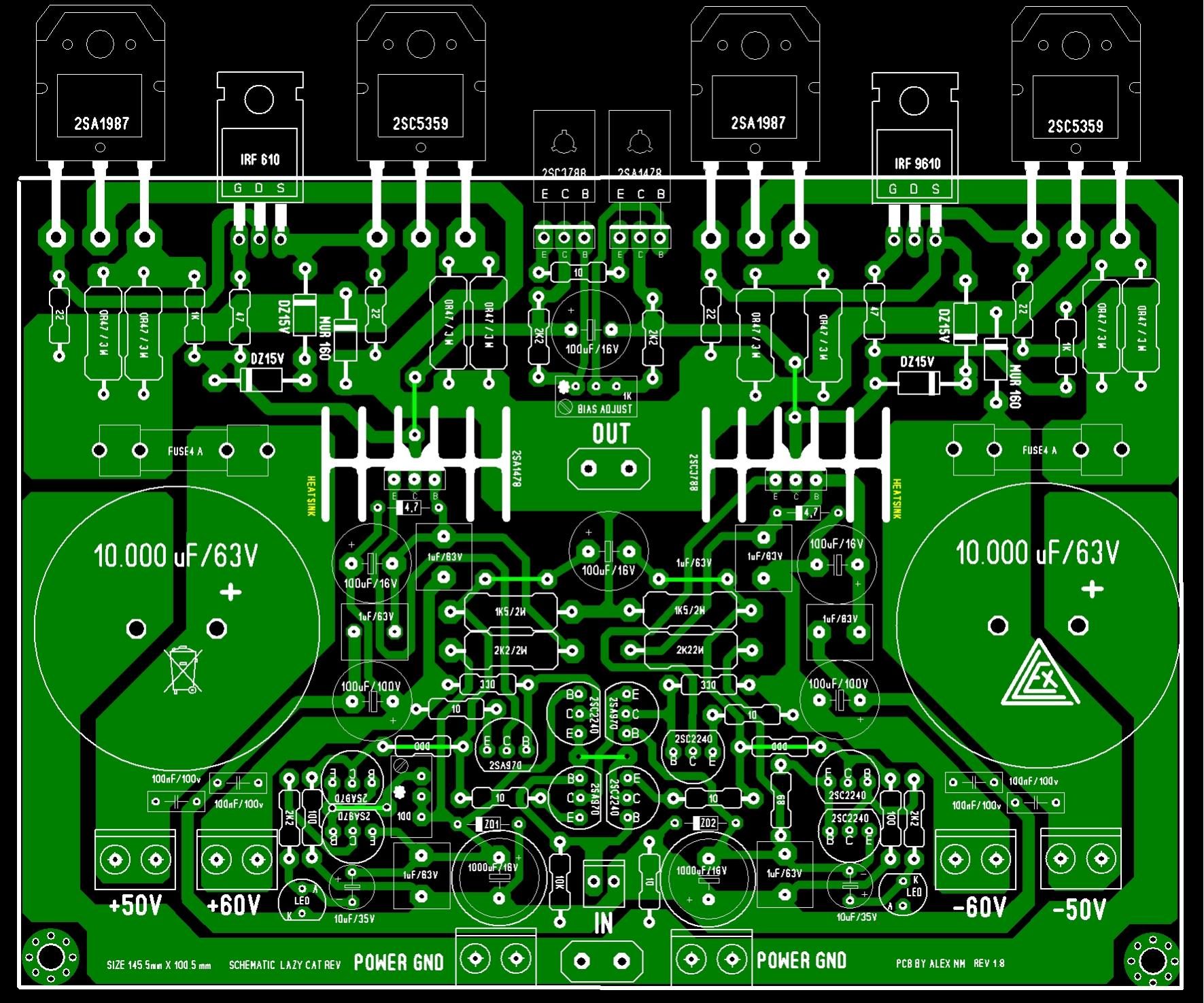

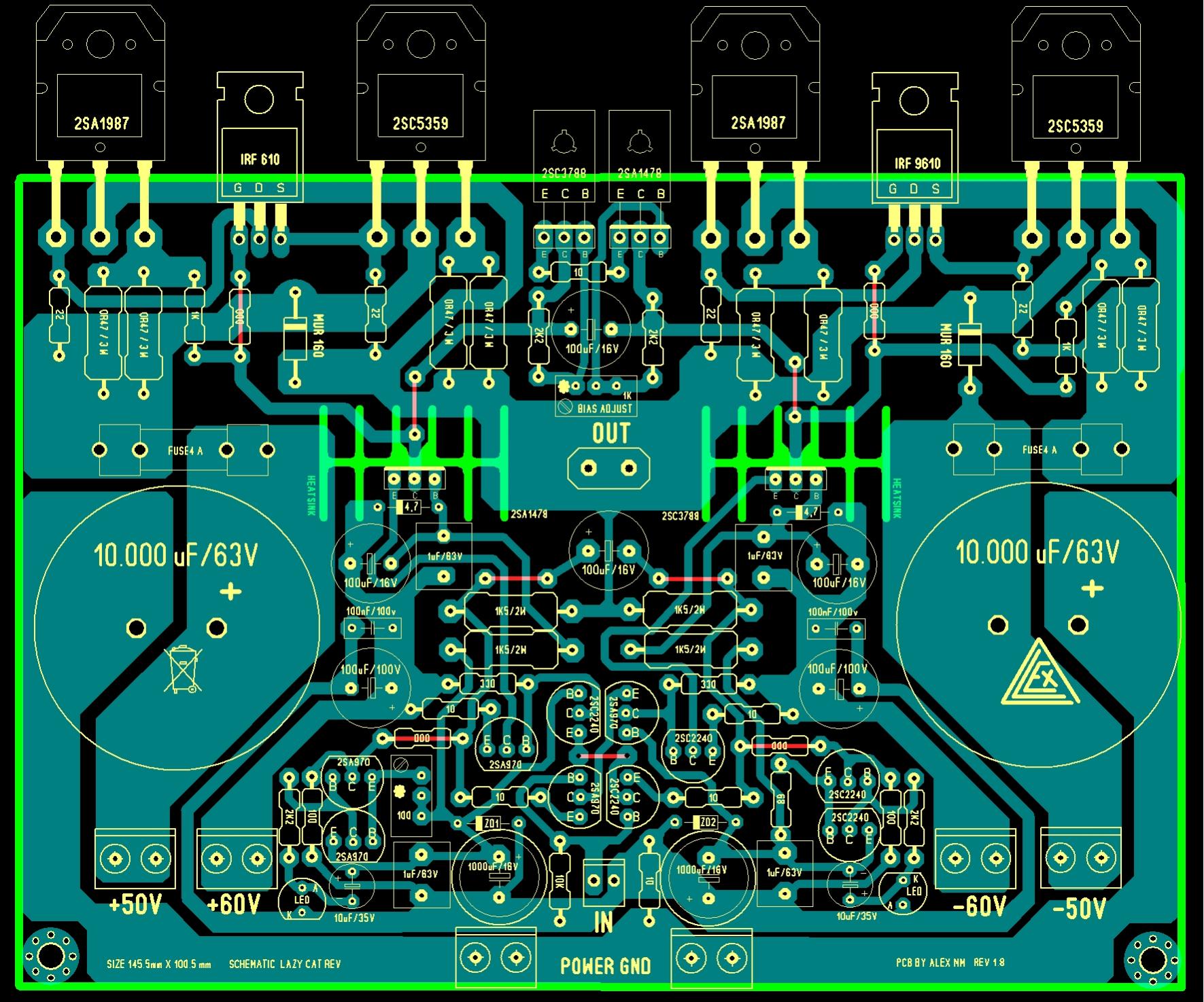

...... PCB without relay , maybe more elegant , and with larger heatsink![]()
I expect QC to do the job , and I will post PCB rev 1.8 in B&W .
Alex.
QC started ... now
Alex.
QC report:
- face BJT's in left current source like on the right
- resistor between 4,7V and 15V zeners is 2,2k/2W (two)
- 1uF capacitor between 4,7V and GND is missing (two) – very important GND decoupling (to input GND)
- parallel to 10.000uF put also decoupler cap 1uF/63V – 5mm pin dist
- IRF gate resistors 000 are actually 47ohm degeneration resistors (silk change)
- please put 2 oposite gate protection zeners on each IRF like in SSA Basic, I will put them in sch later
- IRF9610 Source and Drain are mixed, it should be the Source to Base 2SA1987 and Drain to Base 2SC5359
- GND (SPK -) faston in between existing GND connectors is missing
- this SSA is more powerful than SSA Basic, so all the output traces should be thicker
That's the report from QC department.
Alex.
