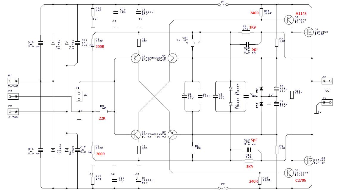

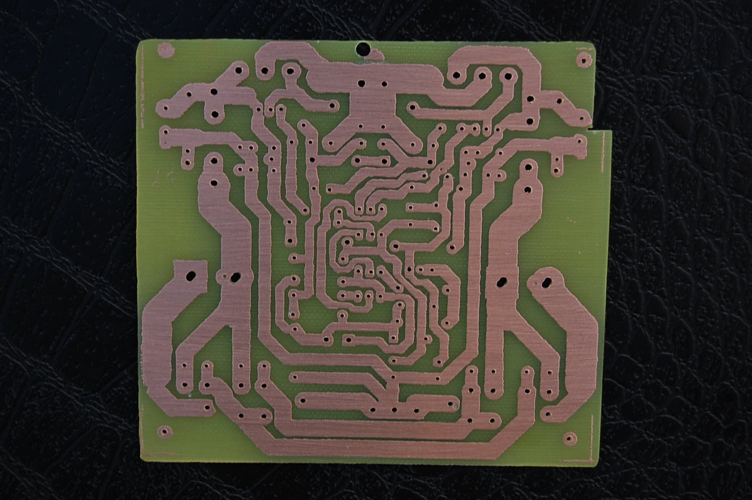

Hi all,
I am building Nico's Lateral-MOSFET version. I wanted more gain so I will change the ratio of R9/R1. I also a bit more current thru the drivers: 2SA1145Y & 2SC2705Y so I will decrease R11 & R12 to 240R. R13 will be a trimmer. I guess that I will need a pre-amp to drive the SSA but I will change R5 to the value recommended by MiiB.
I have made the PCB (a redrawn based on AlexMM Rev 1.4) & I will build the SSA over the weekend.
Any comments about the proposed changes.
Cheers, Stanley

On Alexmm 1.4 R13 seems to be a 2 or 3W resistor...A multiturn trimer is usely rated for 0.5W. Could it be an issue there if you completely replace R13 by a trimer?

Thanks Marc,
I will leave the R11, R12 & R13 as suggested by Nico. I will measure the voltage drop across R13 to see if I need a higher wattage resistor.

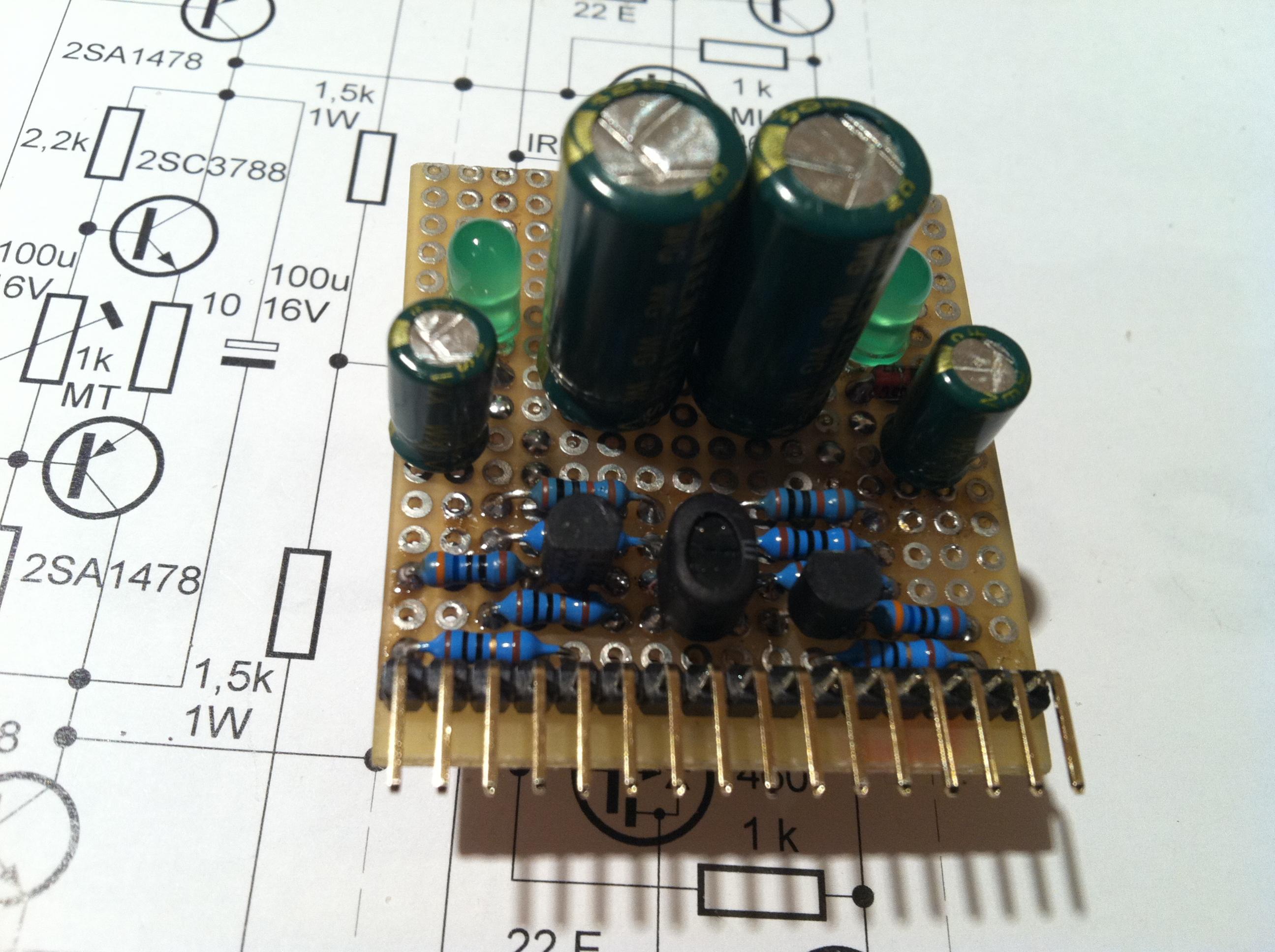

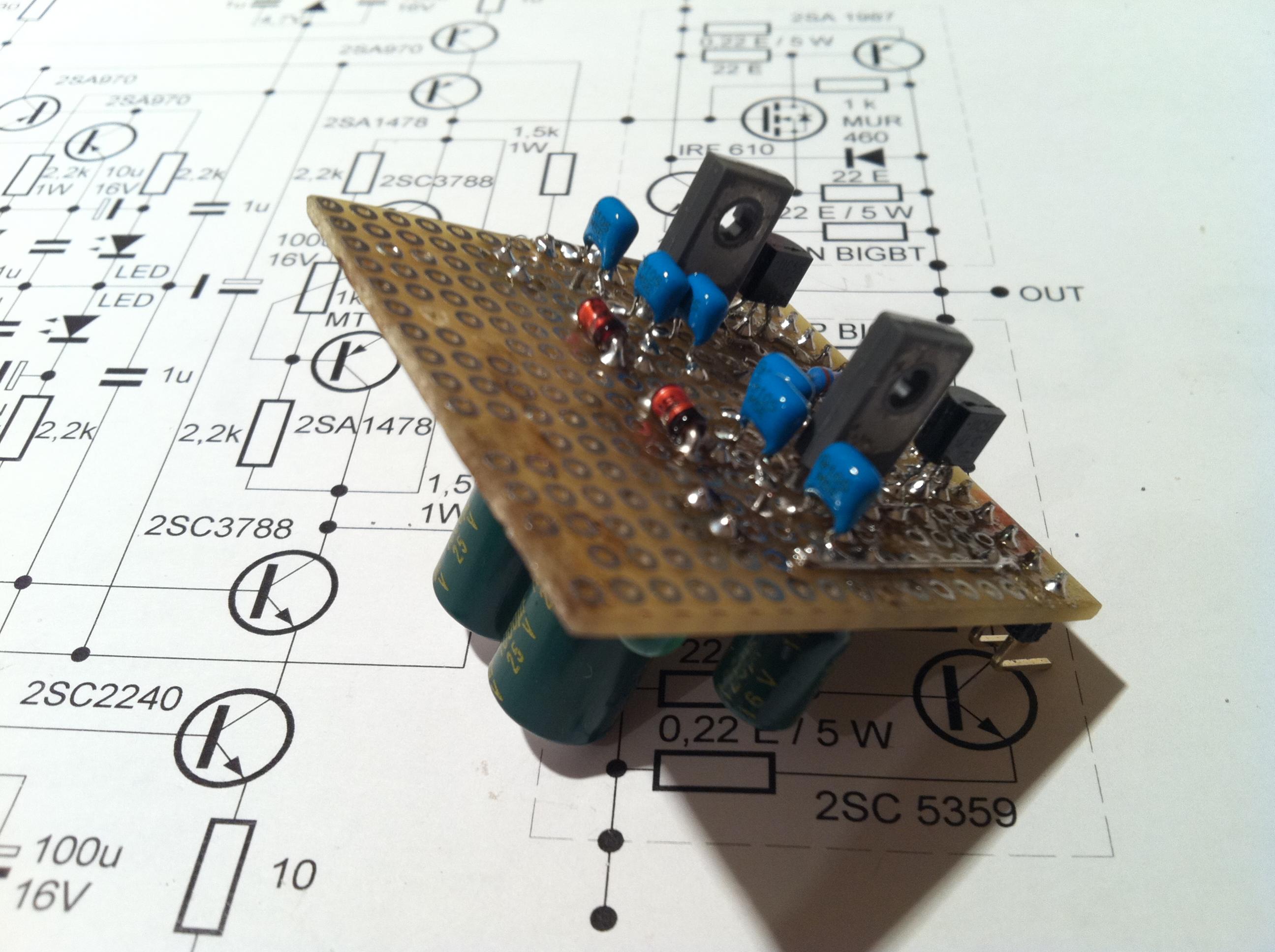

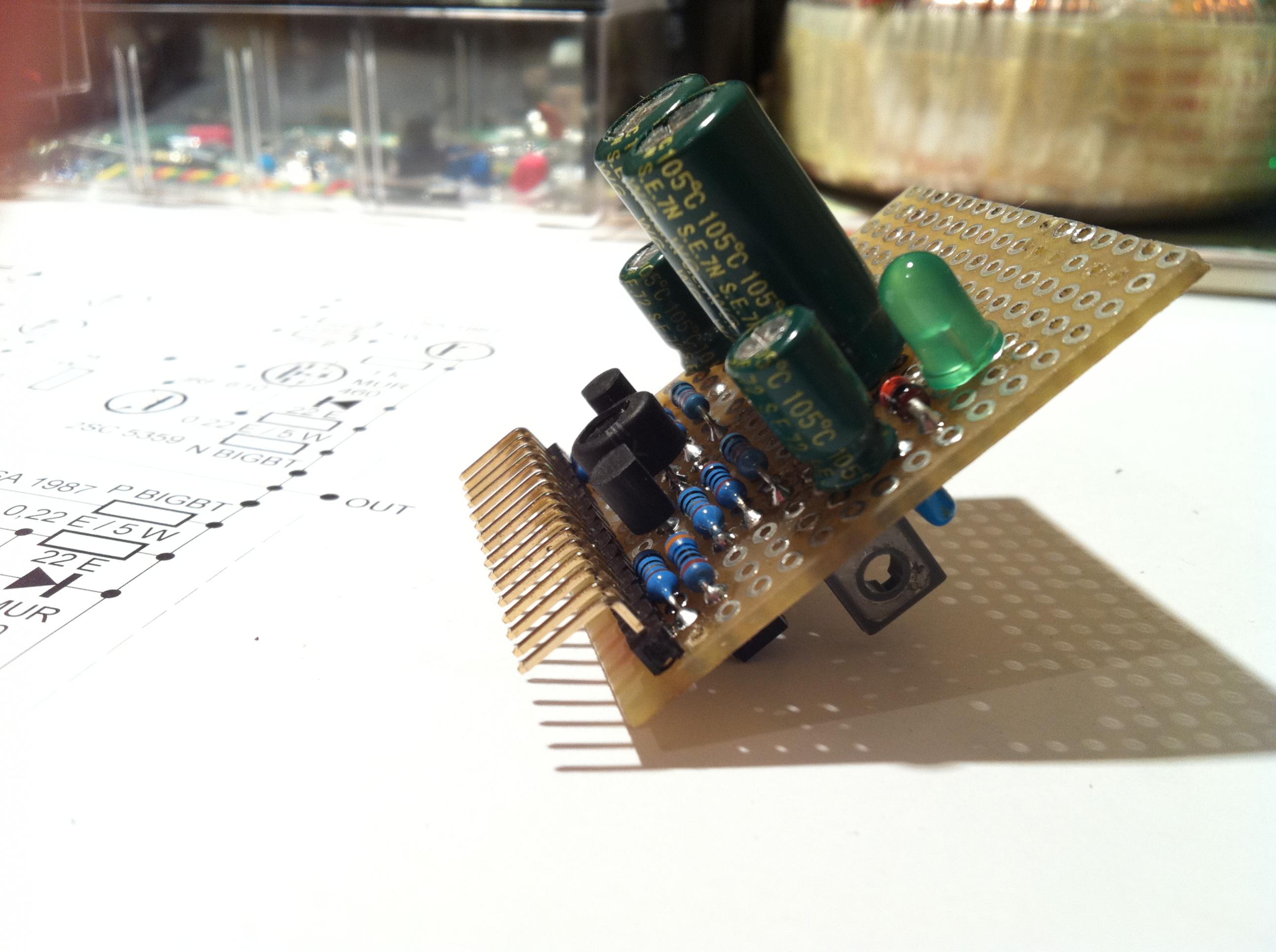

Hi to all ![wave :wave: :wave:](https://files.diyaudio.com/forums/images/smilies/wave.gif)
I had quite a busy week but still manage to put together SSA High Performance front-end-VAS which will be connected to my big metal BIGBT's soon. I intentionally made it on proto board, regardless Alex's PCB already present. The reason is in high-freq testing on the way, for that shortest possible tracks, star layout and some specific HF rules to follow are needed. So I came up with something like shown on pics and will be put on the test soon, hardly wait ...![headphones :hphones: :hphones:](https://files.diyaudio.com/forums/images/smilies/hphones.gif)
Hi to all
I had quite a busy week but still manage to put together SSA High Performance front-end-VAS which will be connected to my big metal BIGBT's soon. I intentionally made it on proto board, regardless Alex's PCB already present. The reason is in high-freq testing on the way, for that shortest possible tracks, star layout and some specific HF rules to follow are needed. So I came up with something like shown on pics and will be put on the test soon, hardly wait ...![]()

Feedback pF caps can always be added on the bottom side of PCB parallely to 1k feedback resistors, or you can put them on the top of the PCB, it's up to you.
I didn't have them in action or any other HF compensating caps at this SSA design, cause I have never noticed any hint of oscillation in any circumstances, not even in heavy clipping conditions (clean-flat cut at rail level). But anyway it's good to have them in to determine the exact end of power bandwidth of the amp
At this front-end-VAS test module from the upper post I will extensively test supply current injection to the input pair BJT's by CCS's or by resistors only. Better sounding solution will be used to further design development, with detail explanation in this thread of course.
