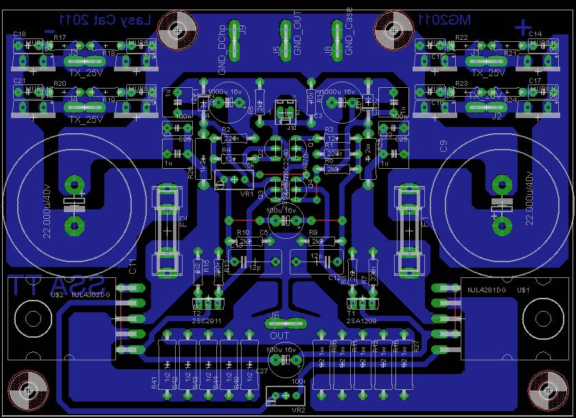

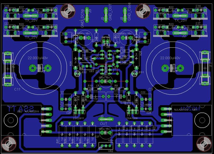

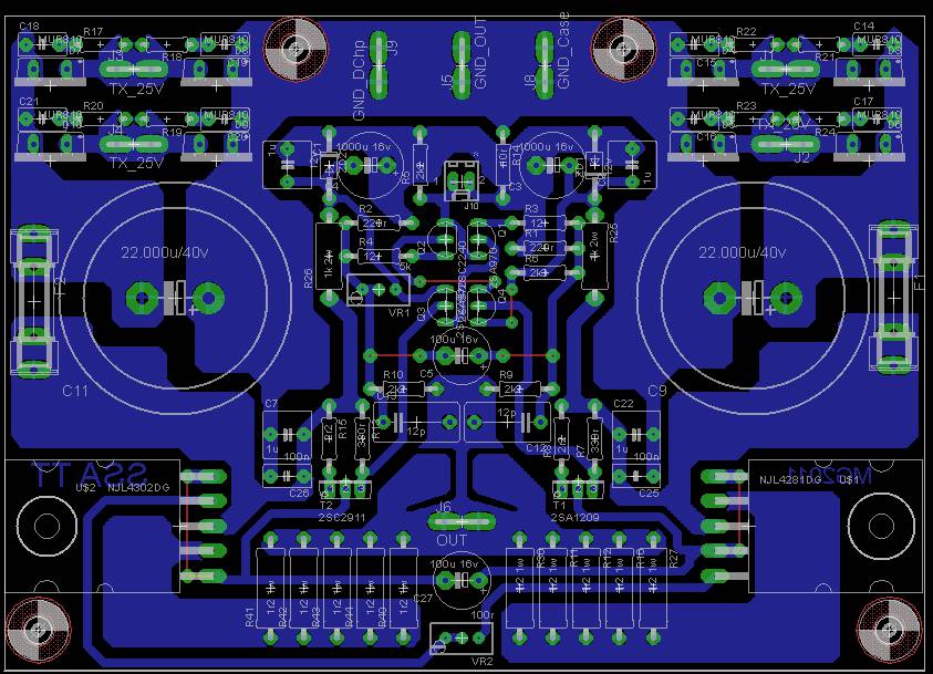

Today I finished the SSA BIGBT HP PCB layout & routing, so the files will be send to mine PCB manufacturer tomorrow morning. Only one question remains and still bothering me: which coating colour should I choose green, blue, red, white ... mhmmm

Compare both schs and add some decoupling caps if needed, otherwise I think your version is OK. Anyway, please post your latest sch suited to your last PCB version and I can comment.

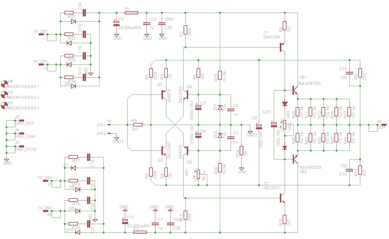

Anyway, please post your latest sch suited to your last PCB version and I can comment.![]()
Here they are....
Hi Idefixes
It will work with 2,2 kohm input impedance the same as with 10 kohm, depends only on your preamp's output current capability. Every value has its own benefits so you choose the one suits you the most, there is some room to experiment to get the best sounding solution in your system. I would certainly put two LEDs on board just to clearly see the normal operating conditions and/or fuses breakdown.
Input offset trimmer is almost a must if the amp is input DC coupled, so it serves to calibrate input offset (bases DC potential balanced to zero) when input is unconnected, so there is no change in an output DC offset if you short clamp the input or connect the zero DC low impedance source drive. We are speaking of some mV difference but anyway here's a possibility to trimm-out input DC offset completely to absolute zero conditions.
If you will use input coupling capacitor I have to inform you that it should be of high uF value at existing 2,2 kohm input to GND resistance. Just for an example input RC like 1 Mohm (input resistance to GND) and 1 uF (input coupling capacitor) means something like 1,6 Hz/-3 dB high-pass margin.
Also I would move 1 uF/0,1uF decoupling caps closer to the collector pins on PCB layout, just to prevent any HF ripple/oscillation loops over the supply rails. This is very important, cause I checked it just for the test purposes with my latest SSA HP VAS (small protoboard pictures) connected with 20 cm wires to the output stage. Immediately when I removed 1 uF decoupling caps near the outputs I got clear 17 MHz sine oscillation of several Vpp. This was also acid test cause I deliberately ran fully uncompensated amp on long VAS to output wires intentionally just to provoke all kinds of possible negative stuff to get the solution before PCB is made, so called stress tests.
All in all make small adjustments to PCB before going into production, now it is the time.

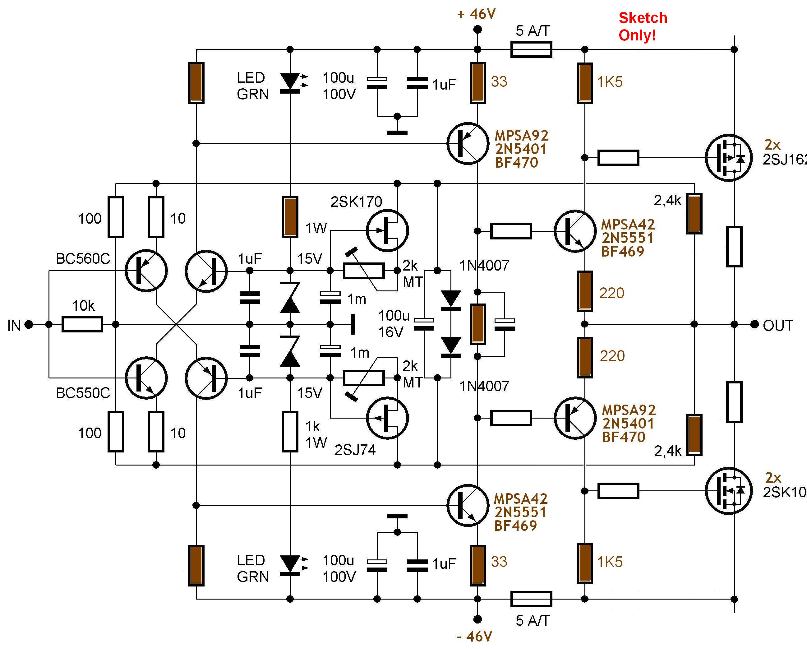

Hi guitar
You can find all requested info in attached schematic. This one has all capacitors and other features needed for real world realization.![]()
Thanks LC for the reply, but seems more things are added (as well as complexity)
what is the left top portion used for ? (Haven't saw such circuit before) and another set of voltage could be hard for me to achieve.
Could I ask why the you add another pair of 2.2k and 5k VR ?
The circuit main supply is written +-35V, is is compatible to +-40V too ?
What is the component labelled '5 A/T ', is it a fuse ?
I guess there are no special requirement for LED (even i can put RED, isn't it ?
Do we need a input capacitor ? (seems most of the amp design have it )
If I were to make an power supply for it, at 40V how much capacity of reservoir should I prepare ? (asking for the power rating of this amplifier too)
So for those without voltage/power rating, I use above 50V & 0.5W is fine/sufficient ?
Just asking for fun, I have tons of BC550/560, could I make one SSA with all those ? (provided make it small output about 1W-5W)
Hi guitar
Quick answers:
- I am apologizing for that, no complexity, just well dressed TT version
- input DC offset nulling
- look very carefully +/- 15 V already present on both zeners
- fine adjustment for both halves - info on wikipedia
- it is
- 5 Ampere/Time lag fuse - info on wikipedia
- green LED colour means regular - normal operation, RED the opposite (alarm, faulty conditions, warning etc.)
- not mandatory
- calculate the Joules (energy), than calculate the Farrads (capacitance) - formula on wikipedia
- power ratings in Watt - formula on wikipedia
- different standards some 63 V, 0,66 W etc.
- yes you could
- BC-s are here because of their low noise, high hFE, high fT, etc. performance, not Watt-age, but you can try and smoke some plastic

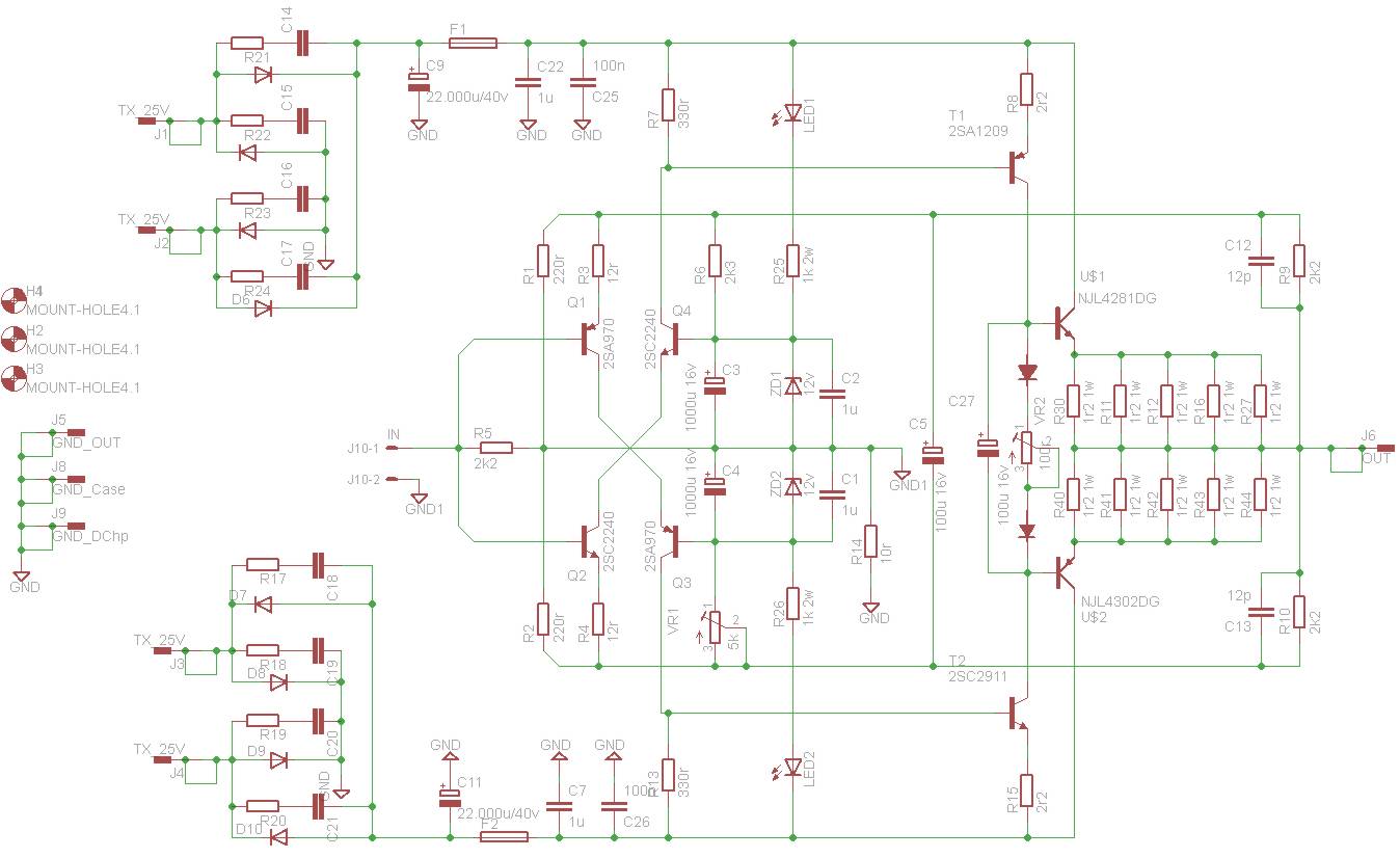

Please repost all-corrected sch for the last inspection, regards, Andrej![]()
LC
I opt. finally for this Basic - MosFet version of the SSA-Bal. If You think there would be anything to add to this chosen final, for better and more natural sound of Yours basic SSA-Mosfet version, than I would be more than happy for any suggestion, otherwise the "masters" confirmation is on the wish list.

- What is "TT" stands for ?
- So should the +-15V of "DC input offset nulling" connect to point between zener & 1k 1W ohm resistor ? (each respective half )
- What is the maximum RMS of this design without much distortion ? So that I could give adequate reservoir.
- fried plastic sounds special.
Regards, Yang

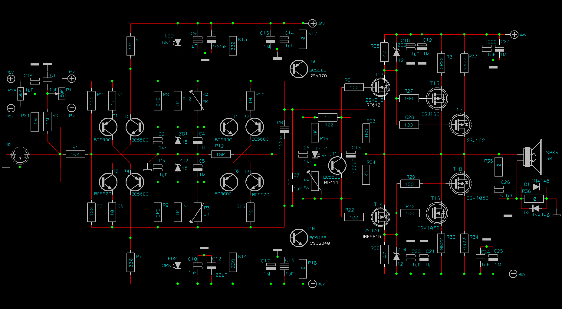

Hi SOUND_Rays
I finally found the time to look over your sch and here are the comments:
- T1 should be BC560C
- input offset trimmer's +/- 15 V is provided by the existing two zeners, if the tracks on PCB will be longer than 2cm than you should also decouple +/- 15 V DC rails with 1 uF caps close at trimmers side
- I suggest you to supply front-end with +/-45 V regulated PSU to make max efficiency from the output stage swing according to supply rails
- in this case change R10, R11 to 1,5 kohm/2 W
- driver's gate DC voltage is app. 8V, so I suggest to change R19 to 2,2 kohm and P4 to 1 kohm
- VAS loading impedance is very high, there is practically no fT limitation by the load and most probable point of local oscillation, amp is also without any freq compensation, so I suggest you to put in small local feedback compensating capacitor (10-22 pF, will be practically tested) between collector and base of T9, T10
I think now you're good to go.
