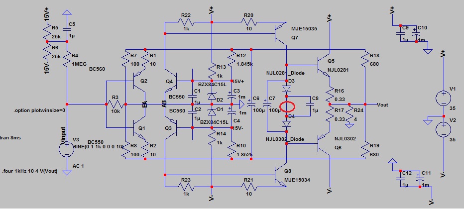

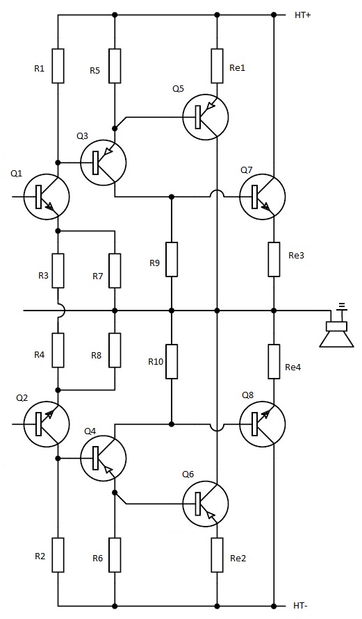

The attached picture is the circuit i'm going to build (ultra low gain), could you help me see any problem/lack in it ? I'm going to construct based on that.
Planning to have 14mA on MJE pairs, and 27mA on NJL pair, is it ok ?

This SSA circuit is perfectly functional and can achieve decent distortion levels at low output currents, but if you intend to drive 4 ohm speakers at full swing, than I would suggest you to insert mosfet driver transistor in the output stage. In proposed version output current reverse influence is very high, so all transistors will be dramatically affected. VAS gain transistor is also very important, instead MJE15034/35 I would rather take 2SA1478/2SC3788 or similar high hFE, high fT, TO-126 case transistors and IRF610/9610 for the drivers.

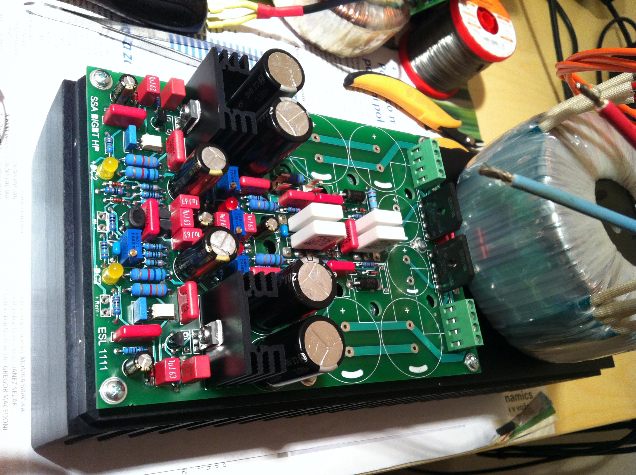

Very professional. I would say world class.
Thanks Nico, greatly appreciated.
It took a lot of effort to design the PCB of exact dimensions according to my plans of how the amp will look at the end. Unintentionally also has, as you've said, "world class" touch hehe.

Andrej, nice board you have there ! My creation is such a mess X.x I already built and tested, seems not to my standard(maximum volume) So I configured to higher gain (FBresistor 340 become 680 ohm) and remove the 2k7 resistor, let the VR do the job alone. In the new arrangement, I bias VAS to 8mA, OPS to 15mA. Is it fine ?
Also tested and listened, seems no problem except the heatsink aren't large enough. (I lack of heatsink, so i took one from old computer processor's )
I have a separate heatsink for output and driver. The driver tend to heat up very slow, and the VAS' Iq rise very slow. (about 0.8mA). So as my output's Iq rise slowly from 0.33mA. It takes VAS to heat up to optimum about 1 hours (Iq reach 8mA) and OPS seems heat up fast enough(few minutes) if I play music maximum (computer source) but not VAS.
Is it better to do this way, or put them together ? (then i have to find larger another heatsink)

So you've experienced the taste of SSA's sound, nice.
Look, the main reason for VAS temperature to rise so slowly lies in slow thermal response of the VAS transistor/heatsink combination. VAS transistor probably has too large heatsink (big thermal inertia), so it takes so much time to stabilize at certain terminal temperature. Until it gets there, VAS current is slowly changing accordingly to the temperature slope. I suggest you to use smaller heatsink which will allow temperature to stabilize much faster.

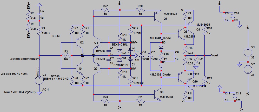

Lower part of your output schematic has to be corrected. Emitters are connected correctly, only you have to change Q2 to PNP, Q4 to NPN, Q6 to NPN and Q8 to PNP.
Upper half is correct.
Proposed output sch would work, the only problem I've experienced, because I tested exactly this topology many years ago, is with Q3 and Q4 to be bipolar transistors. Their base currents are added to the emitter currents, thus causing unsymmetrical voltage drop at R5/R9 and R6/R10, resulting in non 50/50 output current (both, quiescent and operational) split between Q5/Q7 and Q6/Q8.
If you replace Q3 and Q4 with mosfets, you will get perfect symmetry between Q5/Q7 and Q6/Q8.

I said output current reverse influence not reverse current influence. Big difference. It simply means that the output load current fluctuations/variations strongly affects all previous stages, causing higher percentage of alteration of operational currents value in VAS and input stages than if there would be one more stage present ie. driver transistor (more current gain). Usually we are using the term "VAS current insulation", meaning we are not affecting front-end voltage gain stages (input + VAS), by any means, with output load currents variations. Hopefully I explained it satisfactory.

8 mA VAS current at 50 Vce results in 0,4 W idle power dissipation. That is nothing for MJE15034/35 you are currently using. They could easily handle 0,4 W without any heatsink at all, since they have TO-220 case.
Would like to add one, but my current board have no spaces for that Any good arrangement you would suggest for driver/predriver ?
Standard combinations of pre/drivers: BD139/140 and MJE 15031/15032, MJE340/350 and MJE15034/15035
Suggested: 2SA1478/2SC3788 and 2SA1930/2SC5171
Mine usual: BF471/472 and IRF610/9610

hm..... I guess i will just use my MJE15032/33/34/35 for driver. Could you help me edit the schematic roughly how i'm going to incorporate the driver ?

Well done board, LC. It looks great on that heatsink Have you gotten to listening tests for this prototype by now?

There can be several reasons for HF distortion or clipping like sounds: too low initial bias current, not enough current gain from all three stages, HF oscillations, bad wireing etc. You certainly have to investigate further the scope image of the output signal to find out the cause of the problem.
huhu, i don't have a scope anyway X.x
But I found out another situation, so I quite have a conclusion.
When I just start it up again the second time, it distort alot even i'm using the external soundcard. Then it is getting better, so I try at laptop's integrated soundcard, result is approx same sound.
So I deduce that it is problem of bias and temperature..... I guess need to let VAS to reach stable temperature first...... Any other way than using thin heatsink ? any other solution ? (If i put starting Iq too high, when it reach optimum temperature, it will be too high temperature for too high bias, becoming too hot)

LC, i'm just thinking that, the bias should be almost ideal (same condition as BE) since the Thermal Track Diode is responsible for the voltage drop, then remove the potentio VR which for bias.
The voltage should be exact enough for just turning on the OPS ? (But in simulation, although the THD is almost same, but the phase and
Just like 1st schematic.

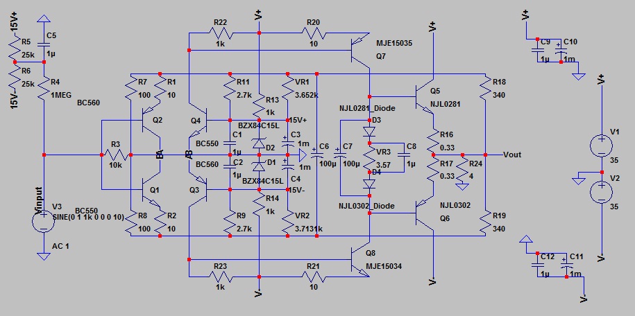

On another side, i'm thinking building another based on different OPS, which is CFP(Sziklai). The another schematic is attached, could you help me to detect anything for compensation or improvement. ?
The posted one is at low gain, but i would like to make it to higher gain. (wanted high performance.
I saw alot said the thermal should stick at driver, instead of output. I was also wondering which category of transistor suit which respective places.(as driver and output device)

HI guitar89
First sch: the amp would certainly be in a B-class since sensing diodes have lower forward voltage than Vbe. Crossover distortions with underbiased outputs in this sch configuration would dominate the sound. This kind of simple topology is best sounding with more than 150 mA of output's bias current.
Second sch: more adequate way of an output configuration for lower, 4 ohm impedance loads, very strong local feedback with R16,17 in this position. I would rather put them to emitter-rail connection of the outputs. Also lower the value of R9,10 to 33 ohm and certainly change VAS BJTs (predriver) Q7,8 to high performance TO-126 transistor I already previously suggested.

Means that move the R16/17 to output emitter, do there still any resistor between two half ? (I saw some books recommend to put 1 more individual emitter resistor for each transistor at OPS, without moving current configuration.)I would rather put them to emitter-rail connection of the outputs. Also lower the value of R9,10 to 33 ohm and certainly change VAS BJTs (predriver) Q7,8 to high performance TO-126 transistor I already previously suggested.
About the VAS transistor, which should I take ? (I had some selection here)
