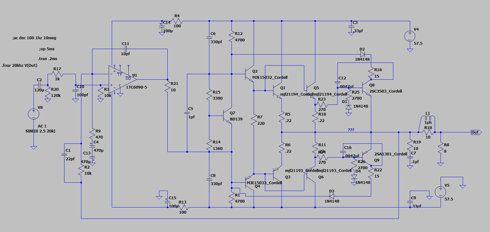

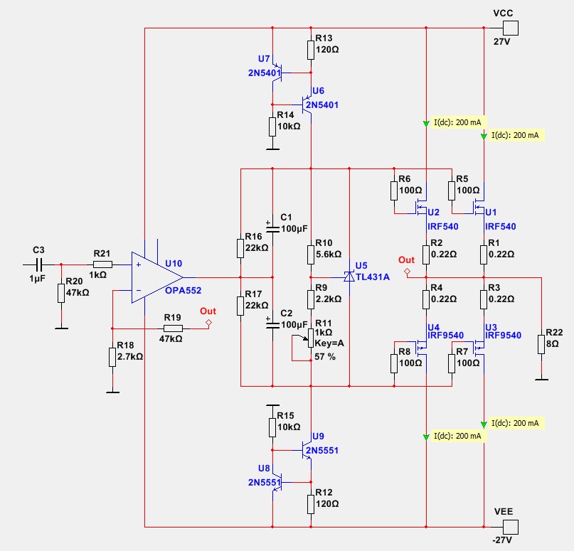

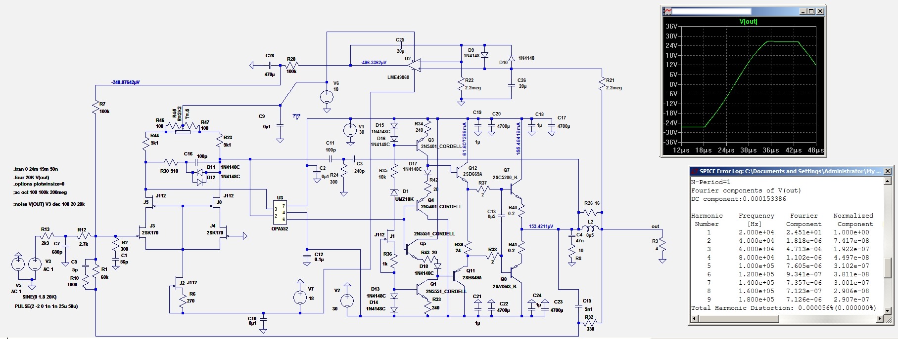

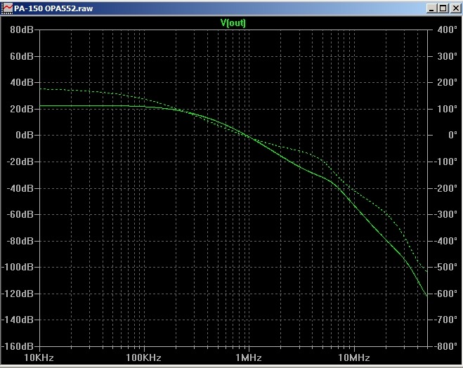

I tested with OPA445, too. It can take +/-50V.opa445 can get really expensive 🤣
But it did not test well. For example the upper bandwith was only 100kHz.
OPA552 has better results.
In my diagram it does not say, but the idle current is 100mA per transistor.
Gives a total idle of 200mA.

Here is the PSPICE Model i used.* OPA552

yes almost all of my projects the opamp/integrated circuits used socket instead of direct soldering ... as i could easily replace them should any of them get damagedThere are several topologies that allow an opamp frontend to avoid high voltages or high slew rate of the rest of the amp, for instance using current drive, so most of those limits can be eliminated. As for linearity that's simply not the case, opamps with <0.0001% THD are readily available (semiconductor shortages aside!). The more complex frequency compensation of these topologies may well be limiting, that I do agree with, and failure modes can be problematic. Mind you if the opamp's in a socket that's handy for repair!
i think OPA552 should be sufficient as i am building this amp at target of 30W x2 for my monitor speakers ... time to replace the TPA3116D2 to see it sounded differentI tested with OPA445, too. It can take +/-50V.
I have used LTC6090-5 with good success for higher power appications.i think OPA552 should be sufficient as i am building this amp at target of 30W x2 for my monitor speakers ... time to replace the TPA3116D2 to see it sounded different
Besides the voltage limitation, you have a current limitation if you only use one stage of emitter follower. Most op-amp are limited to less than 10mA output, so 10mA times a gain of 100 gives a 1 Amp peak max, or +-8V into 8 Ohms. Darlington transistor could be used but the integrated resistors in Darlingtons are not ideal for linear amplifiers. Mosfet transistors would be better but two things: 1. They have a ~4V threshold so you can lose 8 Volts of swing to the idle bias unless you drive the bias network from the middle instead of the ends. 2. Any large transistor, MOSFET or BJT, has a ~Miller capacitance of about 1nF which requires current to drive at high frequencies.
Then you can bootstrap the op-amp supply rails, and LV has a thread about his circuit that does this. If the rails are less than 2x the op-amp supply voltage range then the feedback can be normal, but beyond that, you have to add positive feedback to keep the op-amp inputs within their common mode range, and mixed feedback is tricky.
The bottom line is that a simple buffered op-amp is good for headphones and a couple Watts output. More is very possible, but it is no longer simple, and it is easier to just go with discrete transistors. If you want simple and power, look at chip amps like LM3886.

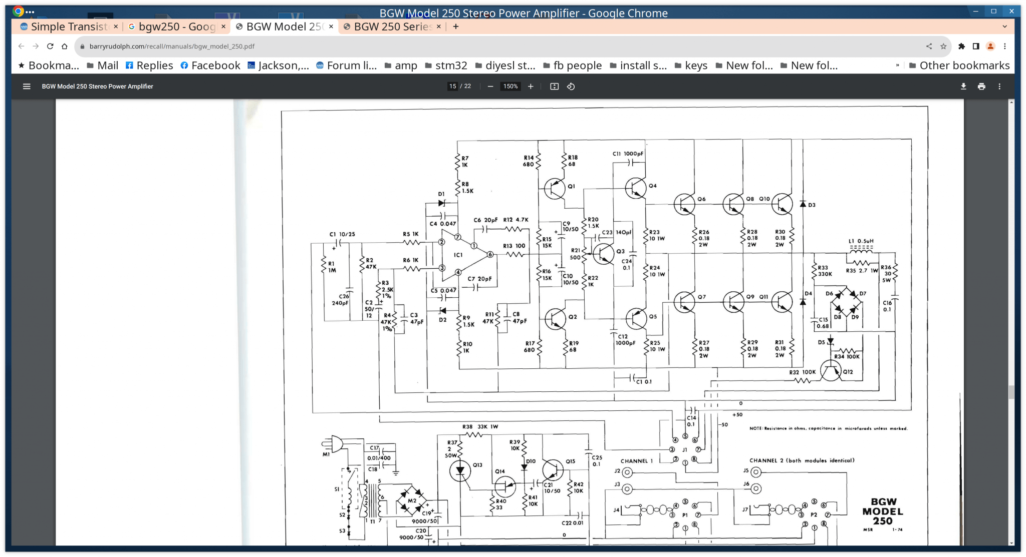

The BGW250 uses a similar topology.
I have this amp and it sounded great for years unril I blew one channel, still have it sittin on a shelf
https://www.barryrudolph.com/recall/manuals/bgw_model_250.pdf
Here is a version I made a few years ago, I am going to build this again and put them on a PCB this time, it was a great little amp you could run the output in to Class A region as hot as you want, but you are still strapped to only the voltage swing that the opamp can produce in this configuration. 😉
https://www.diyaudio.com/community/...-supply-what-could-happen.244818/post-3693072
and here is the schematic( also shown below) ,
https://www.diyaudio.com/community/...-supply-what-could-happen.244818/post-3695968
FWIW 😉

I have made a few changes to my circuit.i think OPA552 should be sufficient as i am building this amp at target of 30W x2 for my monitor speakers ... time to replace the TPA3116D2 to see it sounded different
The main change is the idle current now with 200mA in each IRF540 in output.
This gives a lot less THD distortion.
This circuit gives 33 Watt with good data.
The BGW250 is very different, ie the op-amp does not provide the VAS and operates at a modest voltage. The BGW250 VAS is Q1 and Q2. This VAS circuit is vulnerable to supply noise, but the noise is (somewhat) cancelled by the complimentary pair.The BGW250 uses a similar topology.

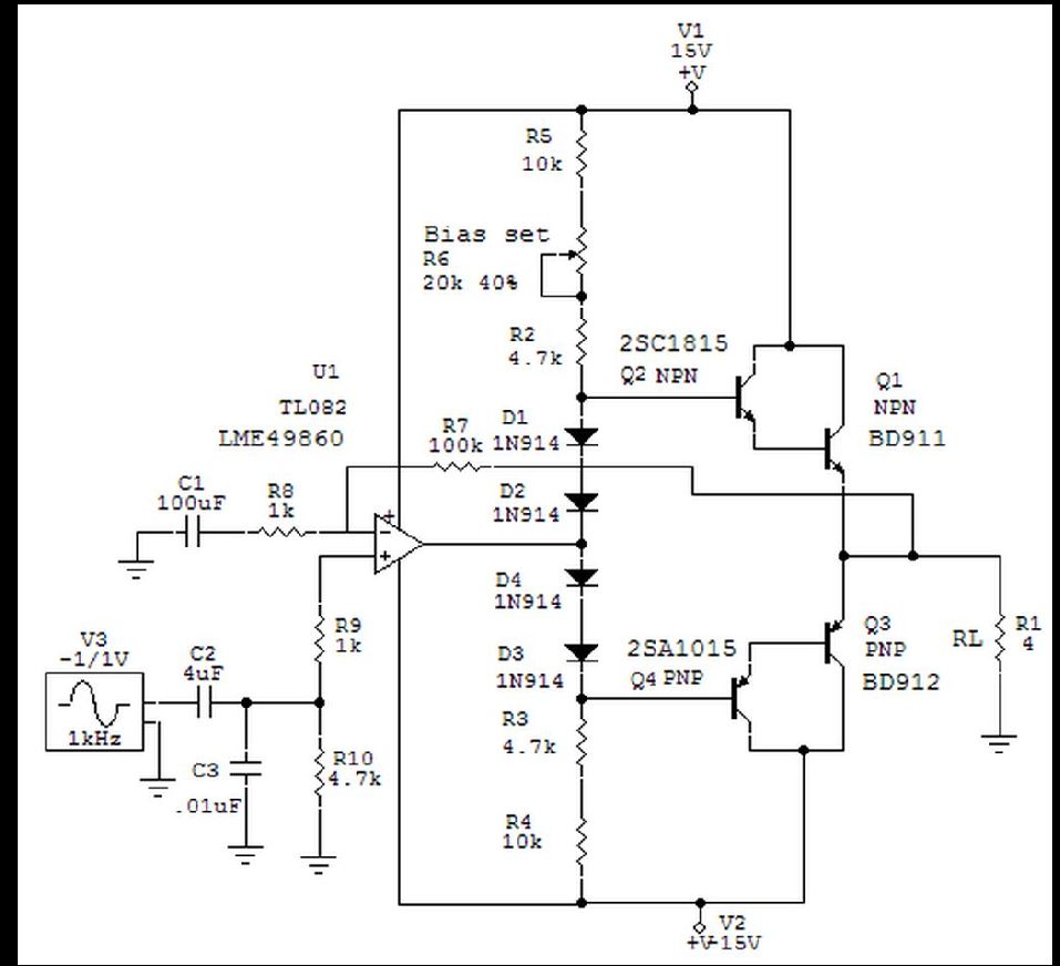

These high voltage op-amps are not extremely expensive, but they are proprietary, so the design cannot be used with an alternative op-amp. This means potential supply issues and no possibility of an upgrade path. That's not a problem for hobbyists who only build a single unit, but a real concern for professionals.
Cascading an op-amp with another VAS creates two ~dominant poles, which is difficult to stabilize the feedback. The only saving grace is that an op-amp that is stable at unity gain will tolerate more phase shift at 30dB gain, so an op-amp with an EF buffer is still stable. Using a discrete IPS and VAS is simple, cheap, the highest possible AC performance and problem free, so there is rarely any point using an op-amp.
Check out these threads:
https://www.diyaudio.com/community/threads/unusual-amp-from-1987.357369/
https://www.diyaudio.com/community/threads/latfet-amp-based-on-philips-ah578.367494/
https://www.diyaudio.com/community/threads/hexfet-amp-based-on-philips-ah578-and-lmk.373773/
All have op-amp at the input
- Simple Transistor Amplifier using opamp as input stages
