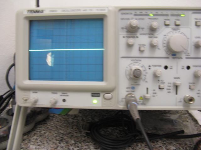

Today I did some testing on the SSHV2.
Nothing I can see on my 20Mhz scope.
It is not with a dummy load, but feeding a ll1660 transformer.

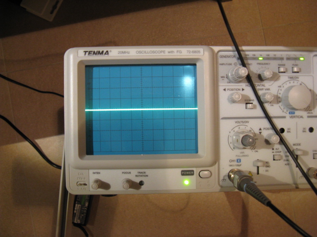

One more picture of the SSHV2 on the scope.
AC max gain 5mV division.

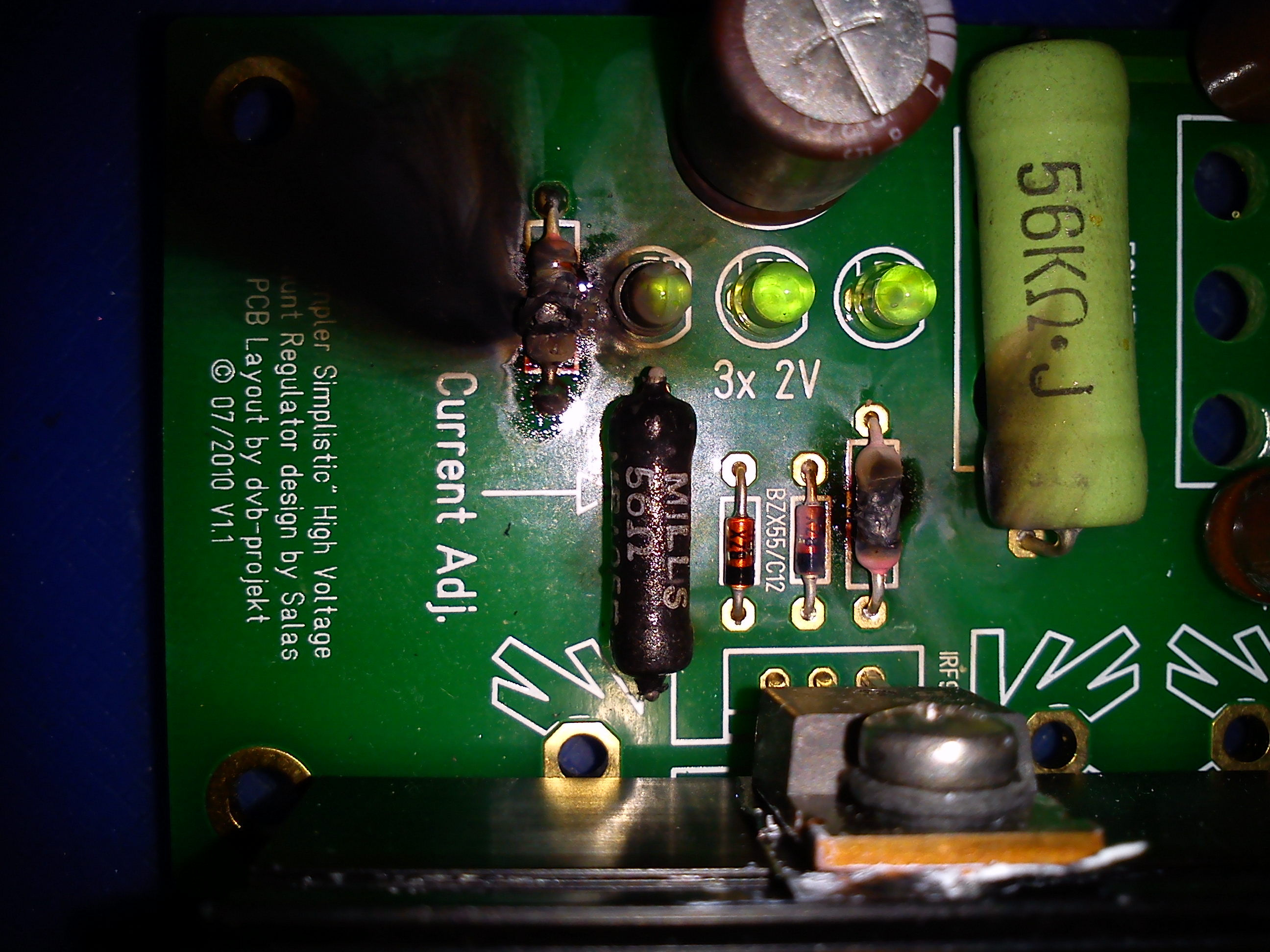

Phillipe, did you test the regulators with dummy load, say 15K first or you put them on the circuit?
Also it' s good after a fault like yours to remove and test all the semiconductors. You never know what can get burned.

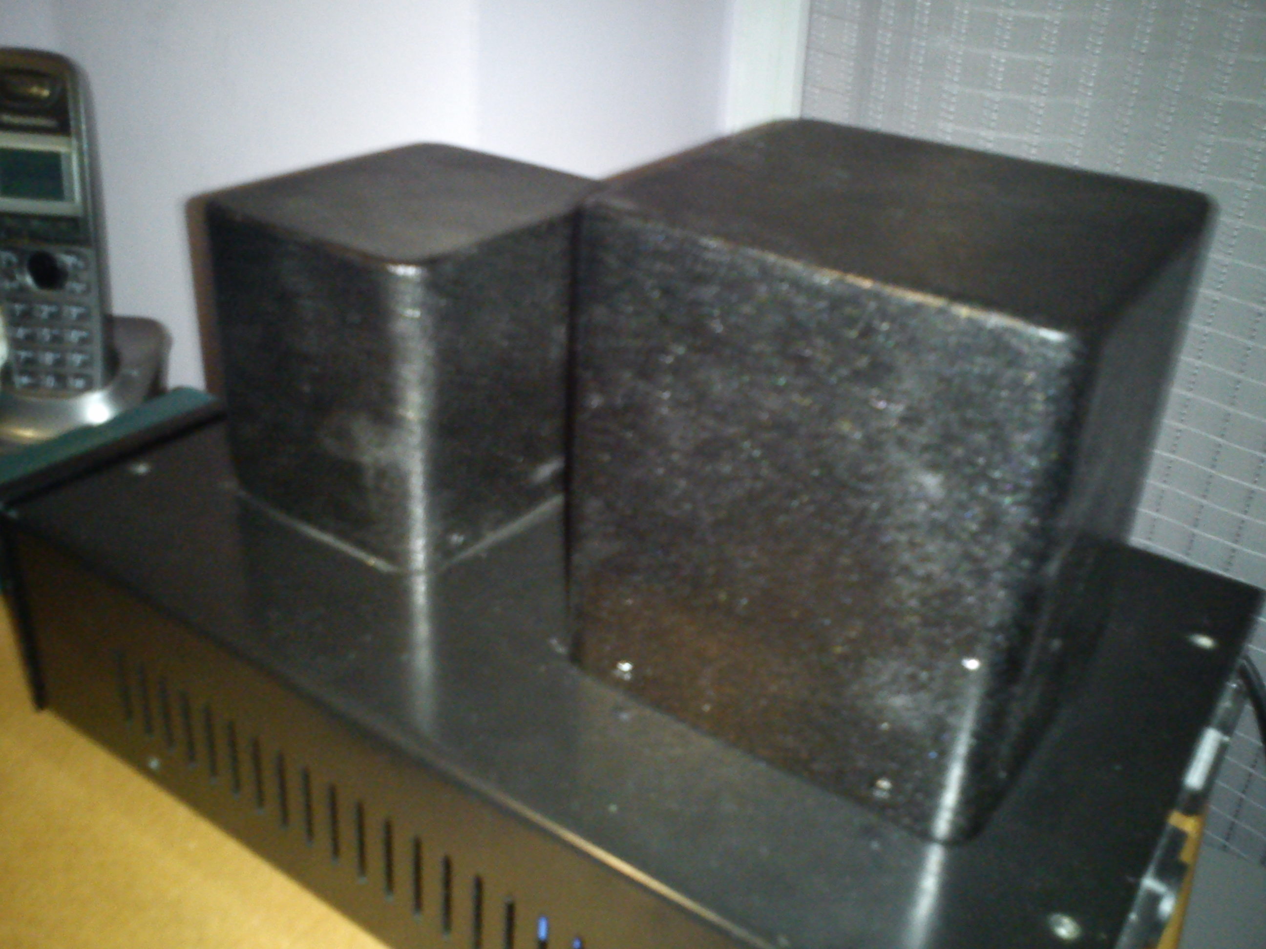

I have CLC, tx is Bartolucci 200VDC choke is Bartolucci 10H 100mA, all caps are lytics C1 660uF 450V & C2 300uF 350V
