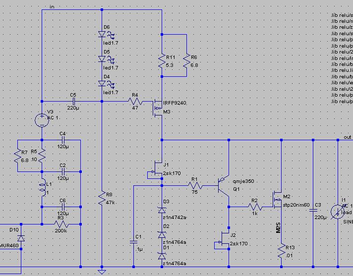

Sorry salas I didn't get back to you with details. I attached the circuit that is currently plugged in and works. A number of variations also worked, started safe without jfets, also with bc560 bias, etc., and when it worked I got bolder and arrived at this configuration. I have rebuilt the power supply for this one; perhaps something in my older psu reacted very badly with previous shunt attempts. I'm still thinking that the regulator sinks probably to little current. I know for sure that the tube circuit draws about 109mA, which leaves another 100mA or so for the shunt, since the total draw is about 210mA. I know you recommend to have the shunt draw about double.
I have listened to it a little bit, but I cannot tell the difference yet. I have a bit of buzz in the circuit, buzz which comes from the tube amp, so I have to take care of that before I can say more about the sound. I think I'm still a bit far from the finish line. I do want to take this opportunity to thank you again for your support. It can get really tough when things keep on going wrong, and parts keep on getting zapped.

Edit: forgot to attach the schematic.

So that is the V2 from email (with LEDs) plus the JFETs CCSs from V1. This mix is a really low ripple, fixed voltage shunt. Is C1, 1 or .1uF? 1uF gives a bit of a slow start, nice if stable. Also is R13 a virtual resistor? Did not need a tad degeneration in the end? I guess there must have been something really strong in that 680uF 2H 1360uF computer cap pre filter, maybe too much inrush plus inductance in caps, it was always bugging me. Now you use low uf CLC and RC? You will never need too much pre filtering since the gm*load impedance of the driver BJT gain loop is very strong now due to local Jfet CCs. Can you show, its simulated ripple rejection, output impedance and step?

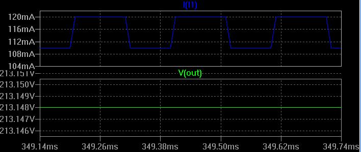

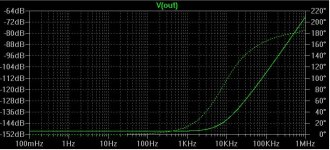

Yes, this one simulates a flat line for output; no ripple out, with a 5V ripple in. C1 is a 0.1uF polypropylene cap. I decided to stay safe with a small value. In the real circuit R13 is 0.2R resistor. The regulator seemed stable without it too, but I wanted to try it and then just left it there. Let's just say this is not the final version.
The filtering now is just as shown in the schematic, CLCRC, perhaps too much. I'll post some sim results soon.

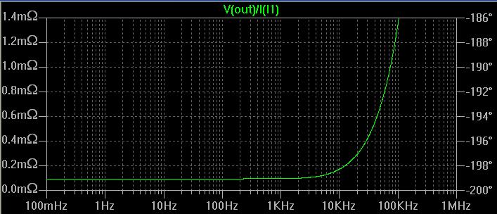

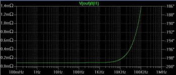

Output impedance attached here.
Edit: forgot to attache the result of the transfer simulation (in spice, .tf v(out) v1):

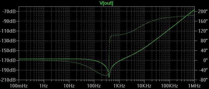

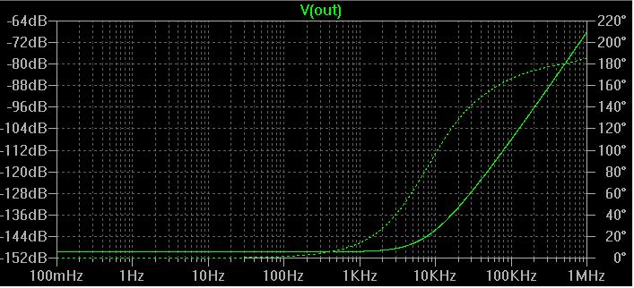

Salas said:Do you think that this notch can be there for real? How can it be compensated in sim? Some pF cap on some semiconductor? Or is it the pre filter? The rejection in dB range is fantastic. It will be just great if it manages 40% worse in reality with layout, cabling etc.
Unfortunately I don't have the equipment to measure line regulation in reality and plot it like that. Not using the bootstrap cap gets rid of the notch, see attached image. I have also been experimenting with small value caps (33-100pF) between the base of the driver pnp to ground. But that worked only for the non-led version.
Edit: oops, attached wrong image; fixed now.
I prefer it without the bootstrap. Or with another value of bootstrap. I think I did not have a bootstrap in the Leds V2 I emailed. Ripple rejection is great anyway, there is pre filtering, I know that smooth phase sounds more open. I trade numbers for smooth trends any day. ![nod :nod: :nod:](https://files.diyaudio.com/forums/images/smilies/nod.gif)
