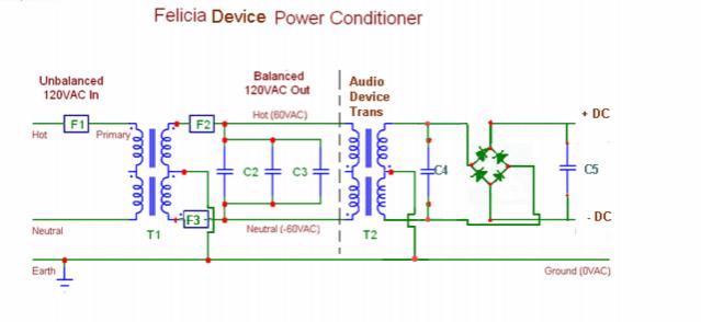

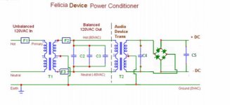

Balancing power/conditioner
While looking at building a PSU, I came across a design by Occam on Audiocircle: the Felicia balancing powerconditioner.
Another member produced this alternate circuit (schematic below) that I thought might work with either the SSHV and SSLV reg's. (Felicia Balancing PowerConditioner Constructor's Thread).
More on the original cct here:FELICIA - A DIY Balanced Power Conditioner
Salas, do you think this might be a worthwhile improvement to either of the reg's or there would be no significant advantage using the balancing power/conditioner.?
