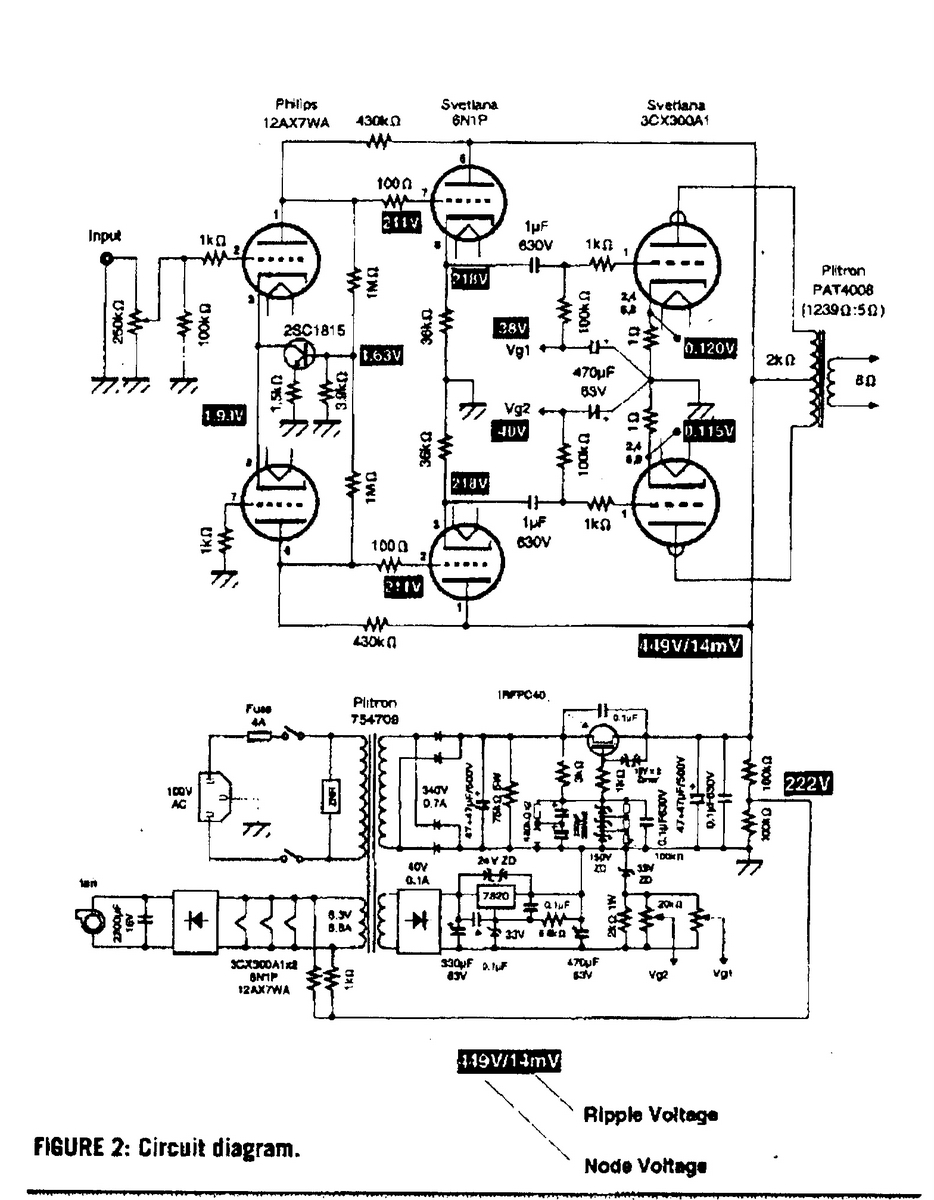

Mosfet ripple filter
HI.
I built a 572b amp the out put transformer was so big could not fit a choke to the box.
Does not have any hum even on 100+db horns but I would like to fit a mosfet regulator/ ripple filter.just for the driver tubes about 40-50 ma
I found the circuit for a mosfet ripple filter in AudioXpress Jan 2001 for a 3cx300 amp. circuit attached.
3cx300 amp runs at 450 volts about 240ma; mosfet only drops a few volts. i have 630 volts.
Do you think this circuit would handle 630 volts at 60ma; I have a irfc60 and some 200 volts 5 watt zeners. Would any one have a pcb for this circuit?
Phil
diyAudio Chief Moderator
Joined 2002
Its a series design that its dissipation is going to be what voltage is across the IRFPC times the current it passes obviously but I don't think anybody has shown it in this thread before so to expertly tell you if it scales well or needs some modification.
