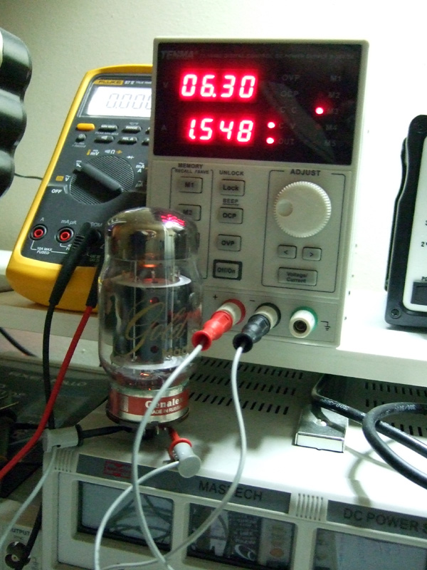

Just for fun I lit up a KT-88 Genalex (Russian reissue). I set the bench PSU at 1.6A CC mode & 6.3V. Those numbers are in its spec-sheet.
It does as expected. I.e. it lights up gradually by dipping the voltage until it meets 6.3V in 30sec and its fully lit & stable in a minute. If I don't set a CC limit it kicks at 2.4A instantly and comes down fast while the voltage is always 6.3V. It takes about the same time to fully shine through the plate holes and stabilize at ~1.550A as in the first case anyway.

I did not say that in such refined case it would not work. I think if you got some directly heated tubes or a bunch of several smaller or different-current tubes - you can easily reproduce the problem (I did it for 4x 12AX7 + 2xKT-88 with such problem).
According to your experiment: the current/voltage was stable in 30sec in first case and "almost instantly" in the second. The amount of energy passed was definitely much lesser in the first experiment for "about the same time" of lighting. It means that something was wrong in the experiment.
Poty, nothing could be wrong in such a simple demonstration. Its only natural.
When we set a current limit to the tube it will just pull back on initial transient energy. What workload is to be done for the heater turn on cycle its just done in longer time.
The peak is momentary and the decline rapid. So "about" has an impact.
If it could be done with auto data log it sure will show the same energy spent in two different curve/time cycles, else it would not end up with same constant voltage and same current draw.
For mixed current draw heaters system you mention, constant current drive is not applicable, and constant current limit is to be tuned experimentally when using one. Its understood that we talk CC limit and not CC drive in the experiment.
Real example. 12AX7A marked as Lafayet has room temperature resistance of 3.3Ohm in the 6.3V mode. It's current after the stabilization is 290мА@6.3V (resistance is 21,72Ohm).
Powering by 6.3V regulated PS we have initial current of 6.3/3.3=1.8A. It further drops to 290мА.
Powering by CCS with nominal current of 300mA we have initially 0.3*3.3=0.99V. After the stabilization we have slightly more than 6.52V.
This REAL case shows us that:
1. the constant current supply is far from natural;
2. the energy passed to the heater is higher in the constant voltage mode (always higher up to stabilizing point) than in the constant current mode (always lower up to stabilizing point). Salas, your assumptions are wrong. It seems you confused energy with power (the amount of energy consumed per unit time).
3. if the amount of power radiating to environment is more (at initial stages) than the amount of supply power you'll never have the heaters lit.
Continuing the example: different flawors of 12AX7s can have from 270 to 360mA of tolerance margins. Using CCS we'll have as much as 7V to 5,25V difference. Is it normal?
By the way, relating KT-88. Sovtek KT-88 has nominal current of 1.7+/-0.1A, GEC KT-88 - 1.6+/-10% (+/-0.16A). So, the real current consumption of KT-88 can be 1.8A - this will dry up your planned reserve of 0.2A fully.
Even simple demo should have proper explanations. In this case you chose wrong indicators of stabilization and make the conclusion that both methods led to the same result (in time periods).
In your experiment it means the same.
