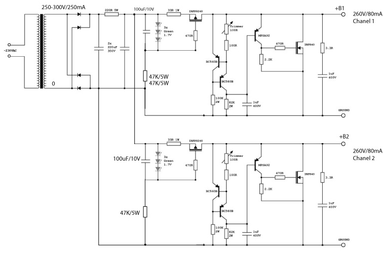

Hi Salas! thank you you help me!
I want to ask him about the principles of operation of this circuit shunt regulator ???
You can show me the parameters to be measured by the R out of the shunt regulator??? Noise and Humm
I need one circuit for the pre with voltage: output 260v / 80ma one channel, and can adjust the voltage out! With vi in 300V to 350V!
You can give me one cricuit for my pre!
Thank
You can see the cricuit ! how The value and C- R-C befor shunt regulator???
All the principles have been discussed in the thread. If you have read the thread and you still don't see how to scale it, clamp it, start it, calculate the voltage drop on its CRC pre filter etc. then, I am sorry I don't give targeted circuits on a plate anymore to members I have no record of their contribution here after what happened in the DC B1 group buy thread. I am sorry, its not you, its recent abuse of open fixed application info. I have already given you some idea for the 260mA you asked for.
