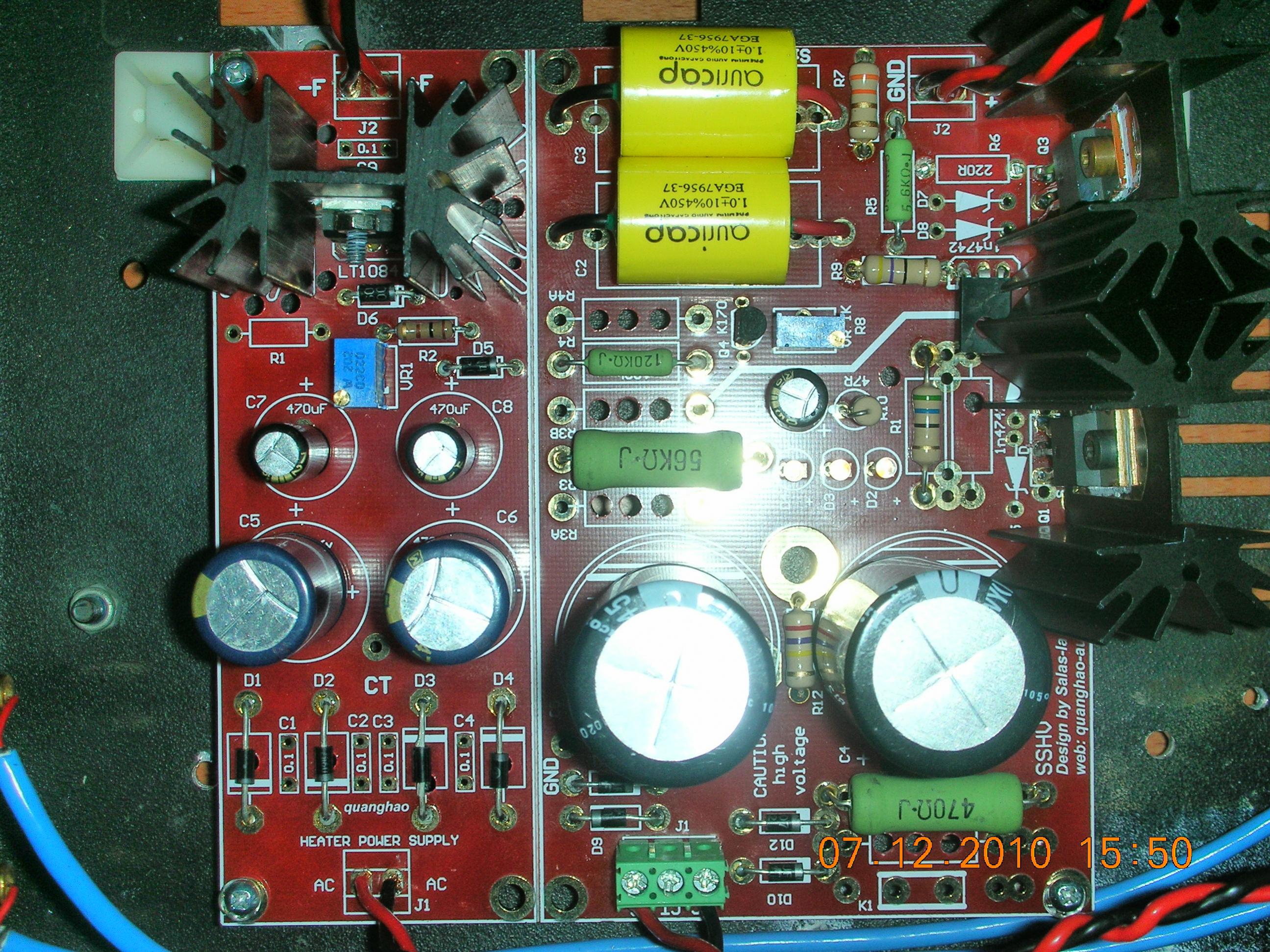

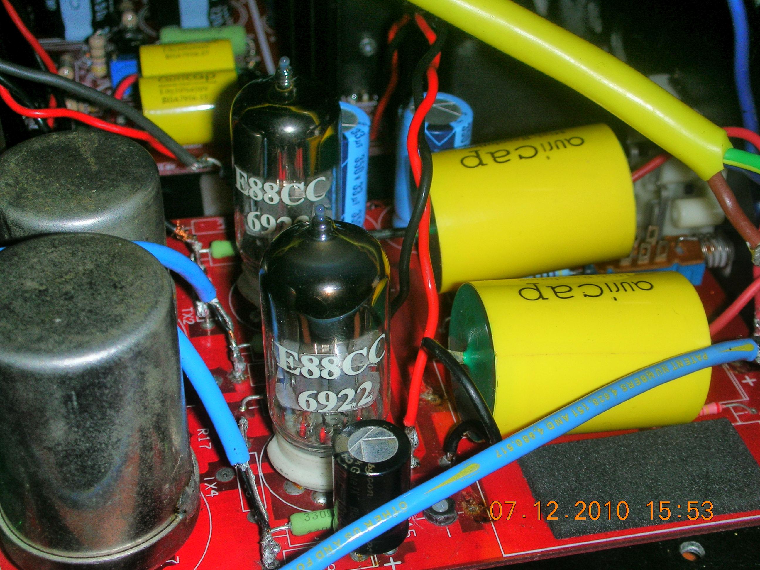

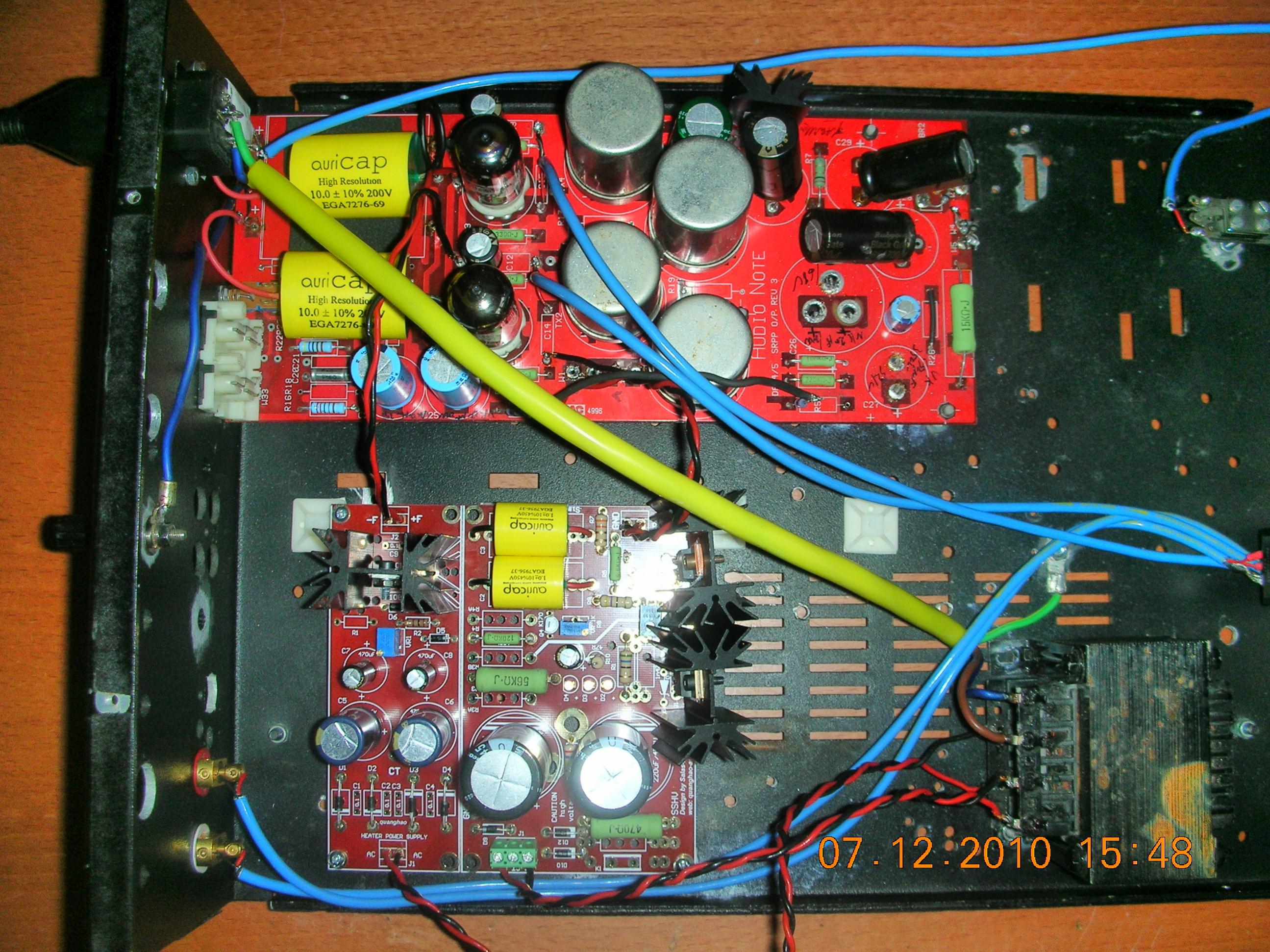

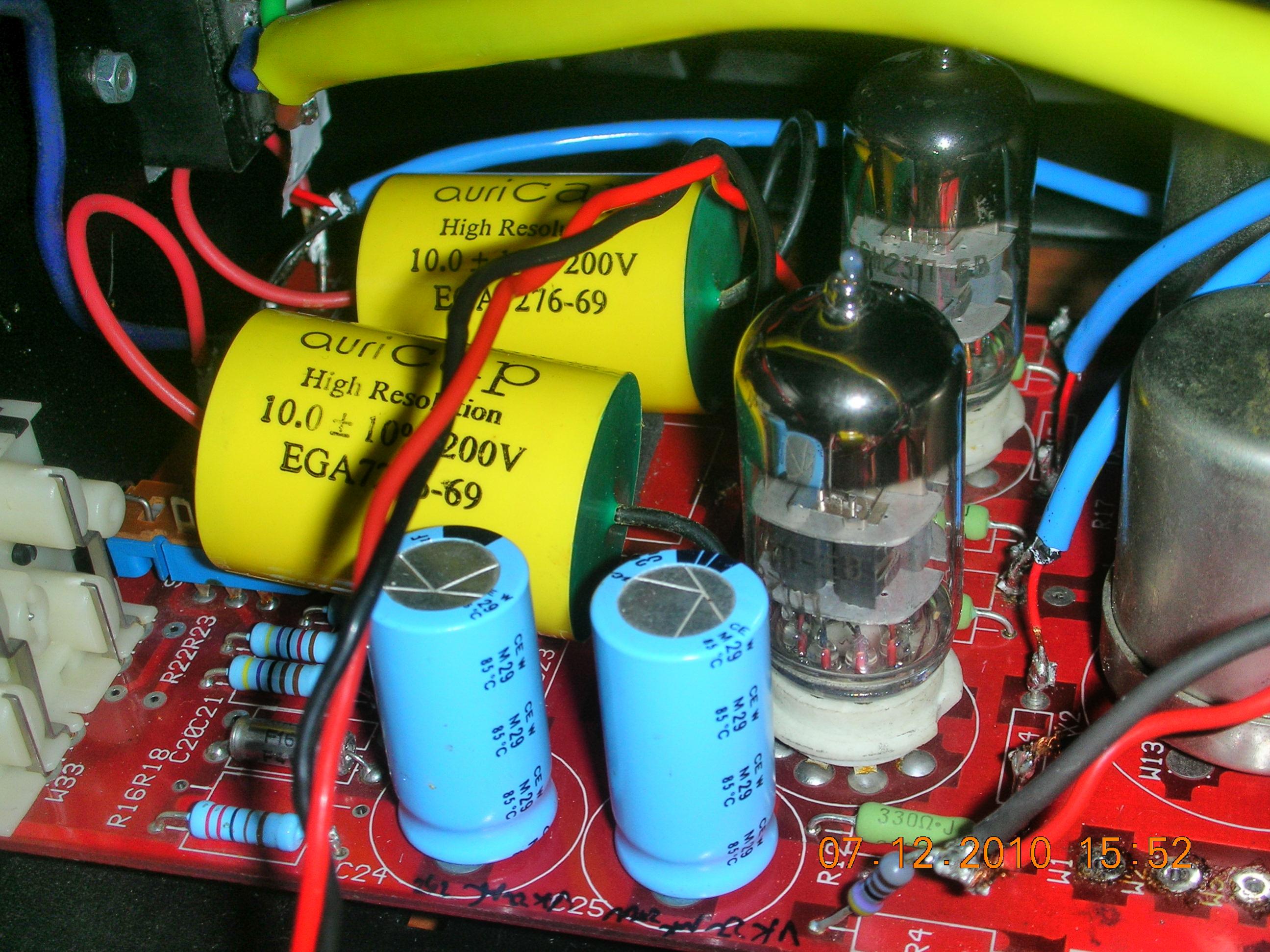

Yes I never suspected this kind of change using a shunt regulator for B+ (you can see I'm newbie), application: pre-amp SRPP 6922, mains Tx custom made secondaries 240V & 8.5V far better than Audionote, about reg. nothing special it's a Quang Hao SSHV pcb, about components useds:
PSU
UF4007 diodes
Nichicon UVY2W221MRD 220uF / 450V caps
1W carbon film
5W Kiwame
REG
1W carbon film
2W & 5W Kiwame
1K trimmer Bourns
100uF 50V Pana FM
1uF 450V Auricap
MOSFETS & TRANSISTORS
IRF9610
MJE350
IRF840
JFET
2SK170BL
Chassis wire: Cardas 17,5ga
Potentiometer Noble 100K or 50K I have both but surely will be definitive 50K.
