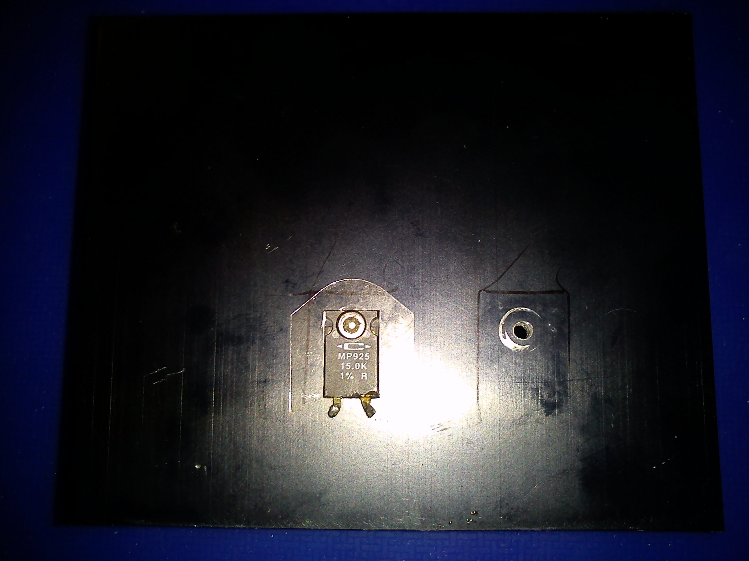

If insulation pad on Mosfet's back fails by heat one time in the future, having the box as a sink its either spectacular HV short to ground when with a grounded box, or DC electrocution hazard for anybody touching the box if ground is not present or faulty. This is high voltage. Don't take it lightly. A 22K 10W will be good for dummy in your case.
Catched the info about dummy load:D

I have on hand one Caddock MP925 15K with heatsink will be enough as dummy load?
