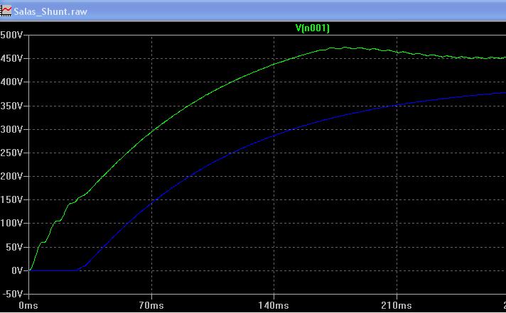

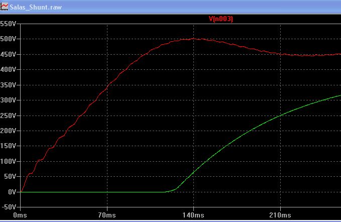

Question - PS turn on surge and the IRFP9240 maximum Vds
I have a power supply that when steady-state, is about 465V. however, at turn on, it's just around 500V. It runs the plate supply, I also need to run the Salas shunt HV from this. I have modeled it in LT Spice. The Shunt output doesn't start ramping up until around 70ms, while on the source pin the supply is already at close to 500V. I'm using a CLC filter. Previously, I used a Maida Mosfet with no problems.
With a Vds of just 200V, I'm assuming that even for these few hundredths of a second the device would vaporize. Has anyone else had this issue, and what can be done?

I had shown a 150V 5W clamping Zener across it. But it must be short pin directly attached to it. Another solution is a 500V depletion mode CCS DN2540 Supertex. A bit drier sound, but less parts also.
Ok - thank you Salas, that worked out fine.

What you show in the sim result? The addition of the clamping Zener? What parts you refer to, the enhancement mode CCS scheme parts?

The simulation shows the addition of the 150V zener.
1 other question - the 1N5383 has a resistance of 330ohms. The 1N5378 (100V) has a resistance of 90 ohms. Would this be a better choice due to the lower resistance?
