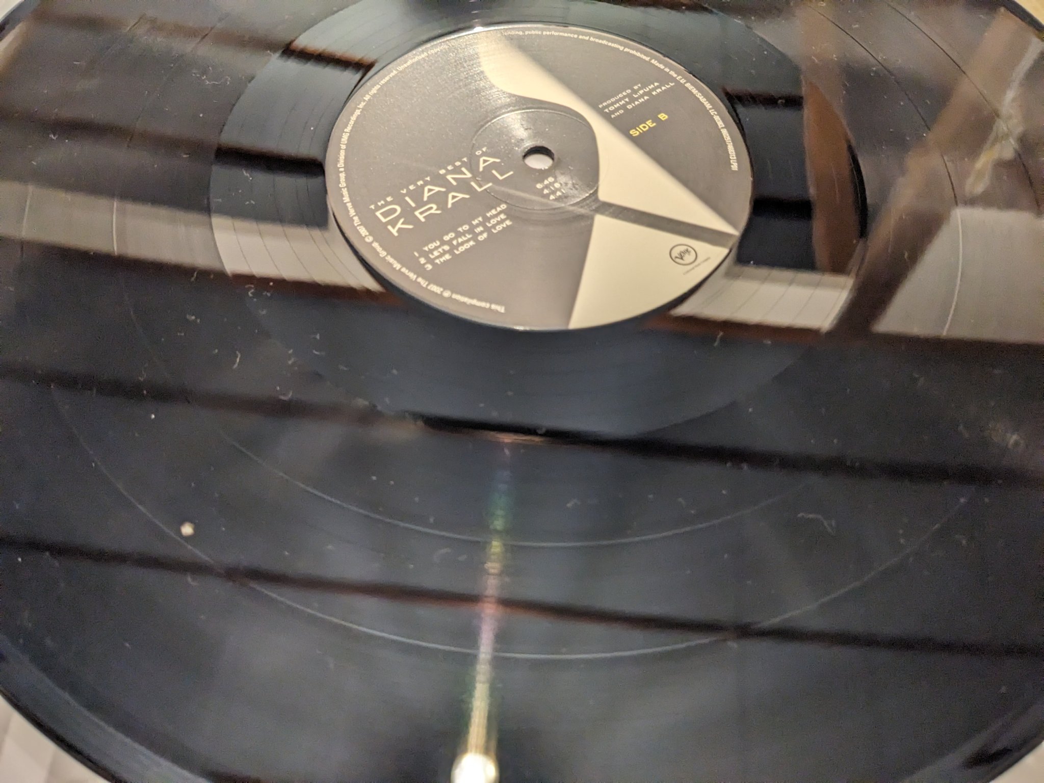

It's 2 vinyls set Diana Krall best album.
One album has noise on one channel and the other one has small white dent also have white spot on the other side.
