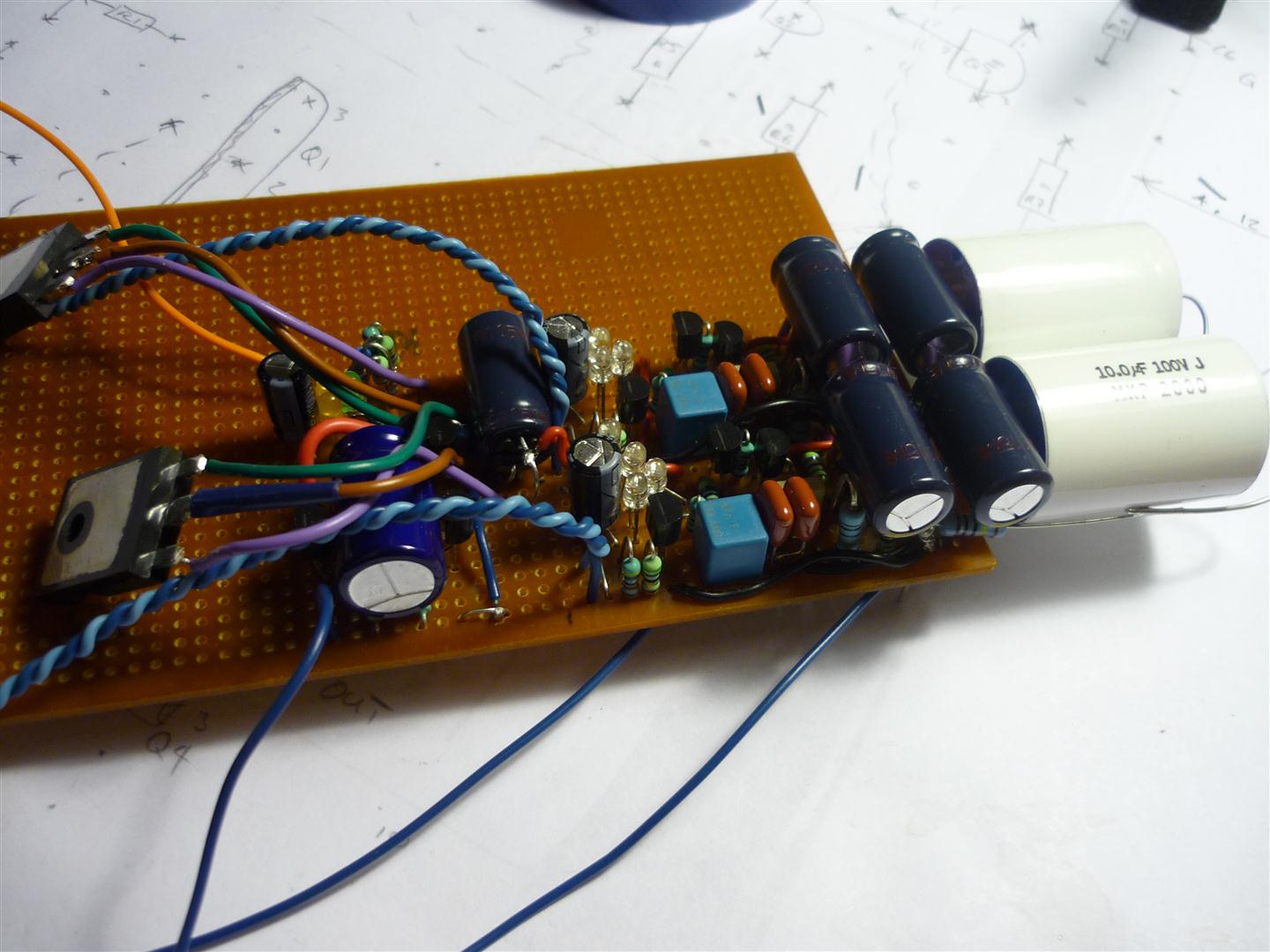

My Salas Phono-Pre
Hi People,
I have been lurking around the DIY sites for quite a while now and the time has come to post something... hopefully one day I'll have something to contribute... until then, please go easy.
A very brief summary of my goals: I am out to build a truly great sounding DJ console and small club system, starting with the mixer. Given I want a mixer better than anything commercially available, past or present, I figured I need to start with a fantastic phono preamp. So I start I did...
I have built an ESP P06, a mini-tube kit K282 from Oatley Electronics and I have just completed the Salas Simplistic: MM version with Shunt Reg, all as per psgr's PDF document from months ago.
My setup currently:
- Denon DP-DJ101 turntable
- Ortofon Concorde Pro carts
- BlueSky ProDesk MKII active studio monitor system (currently at MKIII so online doc is not so relevant, but system is in the upper end of pro-sumer studio grade and can be seen here)
- Apogee Ensemble audio interface
- Vestax PCV-275 DJ mixer (Don't even bother with specs and sound :down:, despite it being considered one of the better units, though certainly not best)
I'll be moving towards getting Technics 1200 series turntables with tone arm and power supply upgrades (as the 12xx's are so standard in DJing and I have heard great things about this TT with upgrades). Carts are likely to be Concordes or Shure M44-7. This is another area I am looking to expand capabilities, though options are low in good DJing carts and I'm sure that none come close to audiophile offerings. Any cart suggestions are enthusiastically welcomed, however back cueing (yes we spin 'em backwards) and high tracking ability are a must. I doubt that these are design features of a sub-millivolt MC, unfortunately.

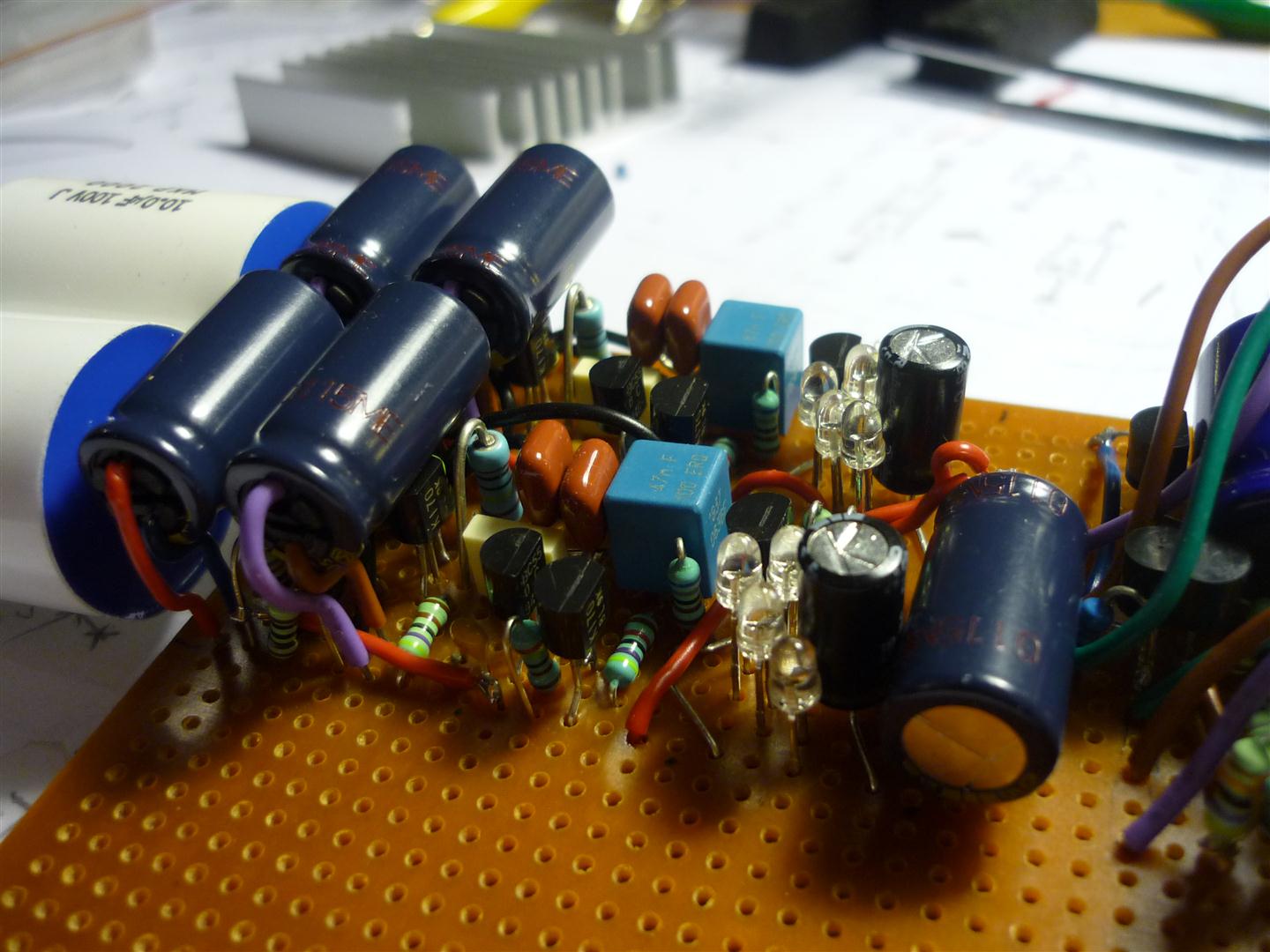

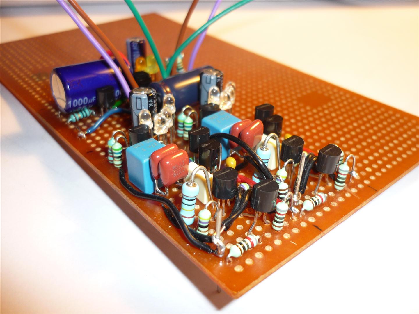

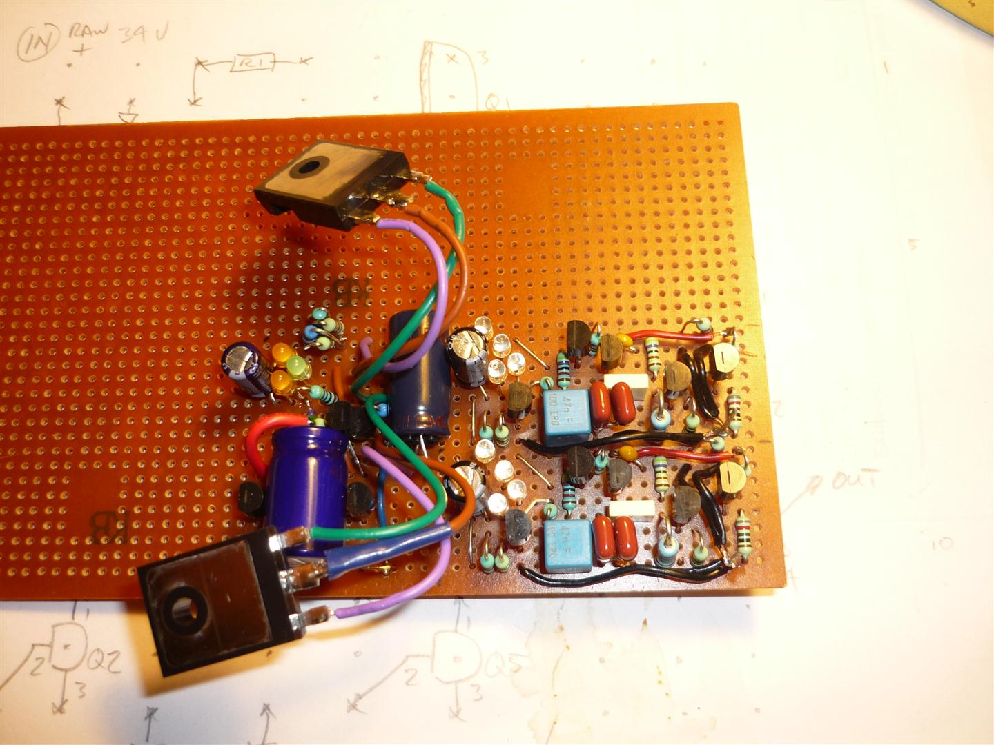

On to the Salas. I'll reduce the ramble and state the obvious... it's the best so far in my very simple (yet revealing) listening tests. Mine has been constructed with rather basic parts on cheap perf-board using an under-sized EI traffo and crappy hook-up wire... I have attached photo's of my modest effort.
While I am not to keen to spend countless hours tweaking (mainly because the whole project is so immense that I can't afford too much time on each component) I am keen to practically get an unprecedented sound from a DJ setup, so I must hone each stage somewhat.
With all of the above insight to my goals, could you please apply your massive collective knowledge to help me through some key improvements over my build to get more out of this great phono-pre. I have found some posts regarding recent circuit developments and hundreds regarding component rolling... I guess I'm looking for an overview of developments that are well worth trying out in my unique situation.
If a specific BOM used helps, I'll put it up. The post is already so long I won't add to it right now.
Many thanks to everyone here and I look forward to getting more from my records.
Tani.

diyAudio Chief Moderator
Joined 2002
One simple improvement would be to change the reg's Zener to a resistor (I will give you the value if you tell me your Vout and mV across the 10R under the 2SK170 at Zener's base), another is to tweak your C3 capacitor's value on the phono to your best HF alignment liking. But if you find the tonality OK in your system and you have no buzz or hum you are basically done. Don't you sink the Mosfets BTW? Using R1 10R in the regs? Also cabling to them Mos is not good, at least apply the 220R gate stoppers directly on their G pins.
I'm posting from work :) so can't measure now, but I'll come back with these. Yes, the MOSFETs are sinked, just not in these pics as it was still under construction. As for 10R, I'm trying to remember the schem in the pdf, but I know that the lowest Vout reg used a 6R8 compared to 10R for the higher output reg's... I used 6R8 here.

Shunt's R4 in the Psgr's pdf is the one I want the mV measured across. Measure your reg's output voltage too. R1 is the one that sets the current. Yes, it was 6R8 in the MM since it could run more current which is beneficial and save on dissipation due to lower Vout than for the MC circuit. Is it no buzz, no hum in your system, and is the tonality OK from bass to treble in your system? You did not tell me. Because there are Pro carts involved which have quirks with the capacitive load and HF, I wanna know it ties OK as a whole. Because by tweaking C3 it can be ironed out in case of wanting something.
Ok I'll check these values, thanks.
The capacitive cart load is yet to be installed and I understand that this will affect the sound significantly. Your particular attention to this point further highlights it's importance to me. I will install this and adjust before commenting further on the sound in this regard (though as I said, I'm happy so far... the highs are already much more involving and full of life than with the others I have compared your pre to). On the matter of capacitance, I deviated from the schem by placing 10.0uF output caps in... simply because I had them. Increasing output caps with a given output resistance will simply reduce the low-cut corner freq, won't it?
The system doesn't buzz but I have hum. However I didn't comment on this as there is much shielding to be done and it will only worry me if the hum is still present after wiring and shielding properly.

Reduce the output capacitor's value if you ever buy an Obbligato down to 2.2-3.3uF if your next stage isn't lower input than 20K Ohm. Not having to pay for 10uF that will allow more infrasonic rumble on top of the expense. Maybe your carts are already loaded well with what the TT cables and residual input capacitance provide. In any case for an MM two things can help you nail the final system best HF balance. One is to substitute the Rload input resistor to ground with a 100k trimmer wired with its middle pin and low pin together to ground. By tweaking that, the cart's HF change. Another way is tweak C3, is the HF riaa cap. If you will feel too much treble, add value, if you feel soft treble reduce value. 15.3-16.1nF play should give enough trends. Maybe there is more in the TT and carts to tune and listen to even better although it may be ''wow'' already. Hum is normal in a non boxed phono. Buzz could be a loop. Use shielded coax for signal and keep the trafo outside. You got a tight perfboard layout and that is good.
