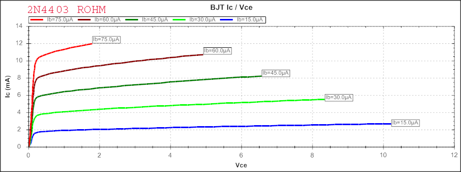

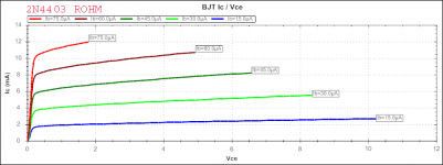

It will only be valid in same circuit cell emulation as to be finally applied.
The full picture for a device would include measuring all DC parameters plus self noise sample selection and curve tracing. Too much for building stuff, nice for lab thoroughness.
IDSS matching and maybe Vp check should be more than enough for all practical purposes.

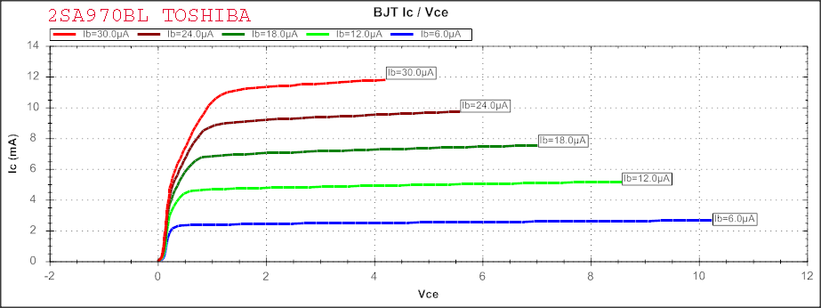

The A970BL is not likely to be in his stash. So I mentioned a plain vanilla common alternative (different pin order).

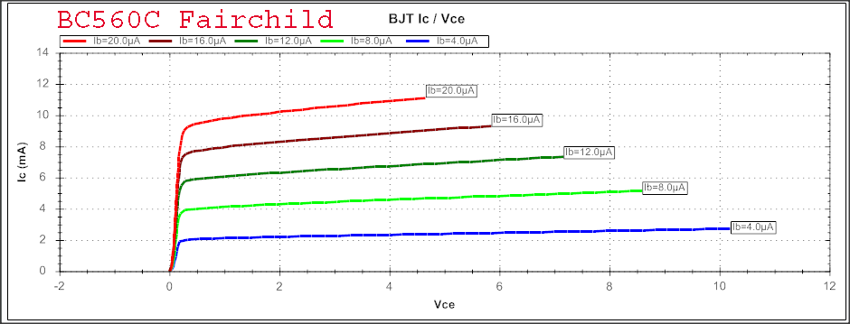

I prefer the A970BL slightly but a high HFE BC560C is too near. Maybe just my idea there is a bit silkier rendering for the Japanese BJT. At 2mA 4V bias point its only little more linear while it will not go much over HFE 400.
