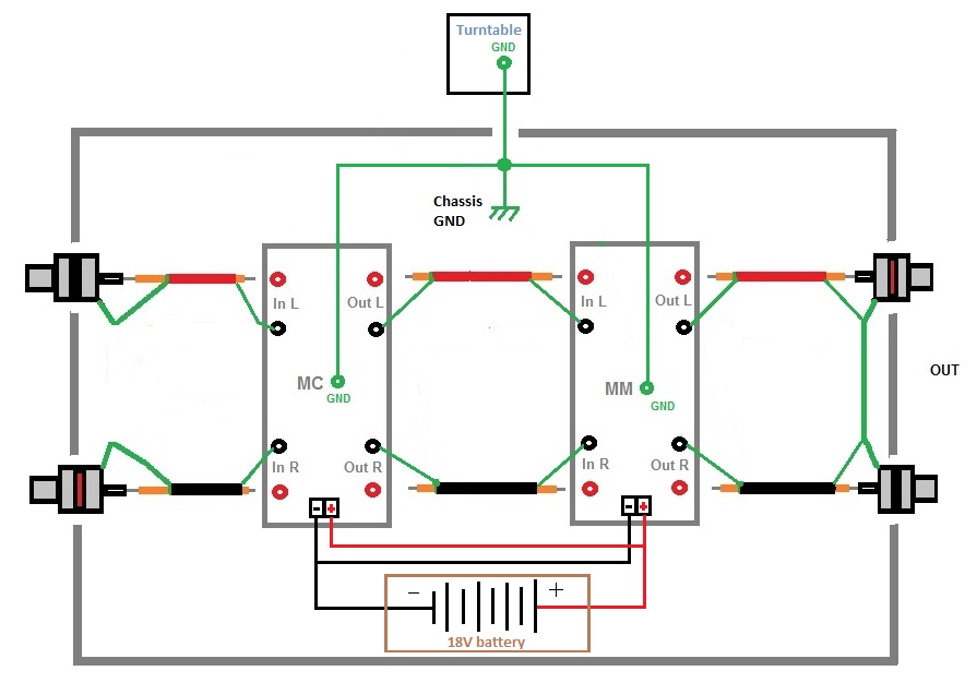

to minimise the loop area of that long loop
if one connects the returns at the Source and one also has the returns connected somewhere downstream, then one has created a very long loop. That loop is very likely to have problems with picking up interference.
Recently I can across a dual coax with the screens in contact. That would be one way to minimise the loop area of that long loop.
I have never seen any project describe how to avoid this stereo source to stereo receiver loop.
There are a couple of papers that describe methods of reducing the current in these loops.
This is what I made for my BHL Phono amp. Please correct my drawing if you see something wrong in it.
Please note, this is not a Folded Simplistic.

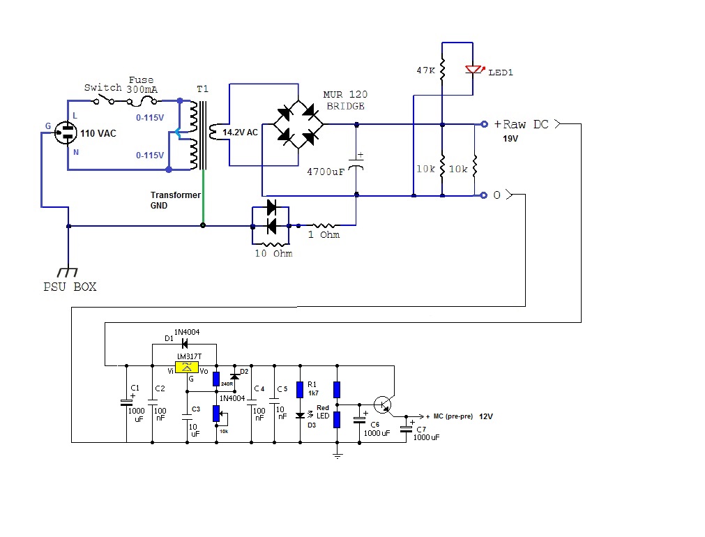

I did not care since a capacitance multiplier followed in that pre-pre case, so the 78xx was chosen for simplicity. LM317 with adj. pin AC decoupling cap is superior to 78xx when alone. But what it has to do with the quoted post?
Some difficulties making the kmultiplier work with the usual 4 pole smoothing caps (oscilations maybe)... I tryed with "normal" Elna 10000uF and found no gains relative to my "normal" RC concept.... the V12R are quite good in psrr so I will keep it simple now 🙂
It was my mistake to include that quote.
Can you explain what BC550C is doing there. What it is for?
If I use LM317T, then do I need to add that transistor to the circuit?
If yes, can I use BC547C instead (I do not have BC550C)? It is the same beside noise is little higher.

Its a pre-pre and that transistor has a capacitor there that multiplies its value by the gain so to filter the regulator's noise because its a very sensitive signal level and there is no cascode. BC547C will do fine.

I made BC547C addition to my LM317T PSU with 2 Elna RFS caps, but noise got increased. Please see attached schematics. Did I make mistake somewhere there?
