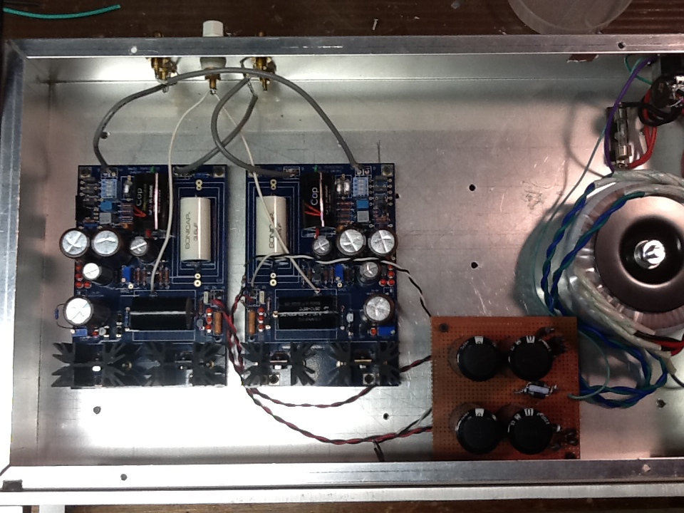

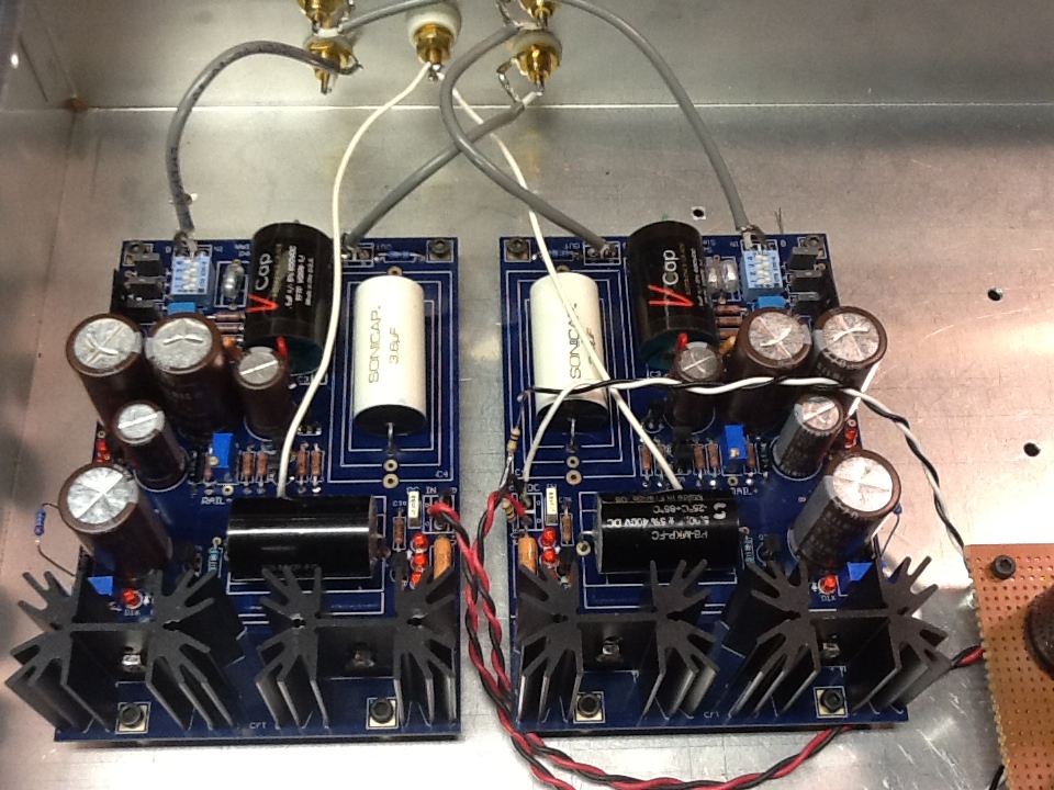

Congratulations! And thanks for the feedback. You are the first to report a GB PCB build and I am happy nothing went wrong. Was it all clear with the guide? Tell us a bit about the system it plays in if you like.
*I attach your pictures here because they did not show up directly in your post.
Joined 2004
Not sure why I'm having problems with the photos today.
Anyway, here is a photo of the system. 845PP transformer coupled amps driving my horns with W subs on the bottom end.
The Guide was great! Big improvement over commissioning the point to point version. I did have to tweak R3x to get the reg in the correct range, per your guide.
