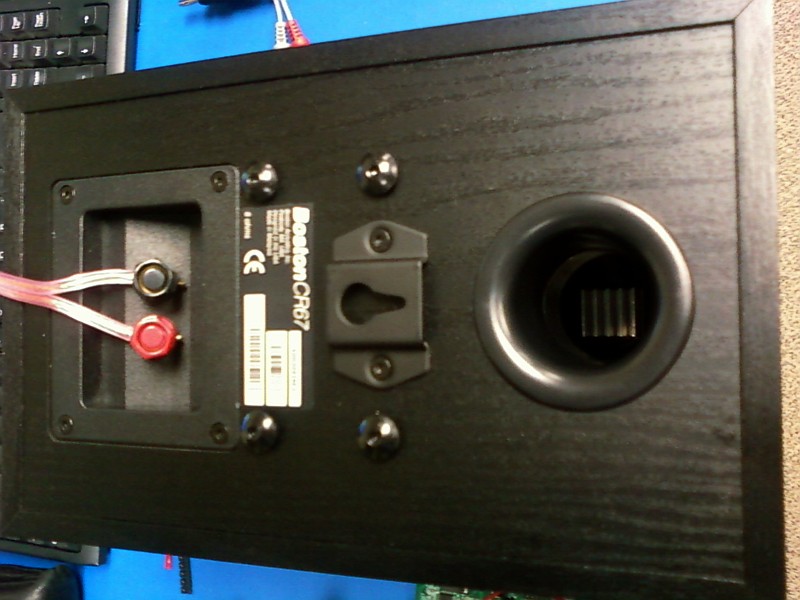

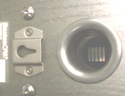

Boston tweeter heatsink I was talking about (barely visible thru port tube) . My camera phone has no flash...
Hello kenpeter
I have work a bit on your photo, here we can see more the tweeter heatsink.
Bye
Gaetan

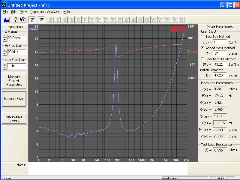

You won't need a tweeter, but you will need a woofer... And I don't merely
mean "sub-woofer". You are gonna have to roll those wizcones in fairly high.
Like maybe 400Hz. There is a terrible Q peak that will rise to above 200Hz
after you stuff it into a box like that...
You might Zobel out electrical component of that peak, but the mechanical
will remain. Only avoid completely by crossing...
Like I said: these are no Fostex... But do sound better than they measure.
WT3 only measures from the terminals, I have no measurement of what it
sounds like in the room.

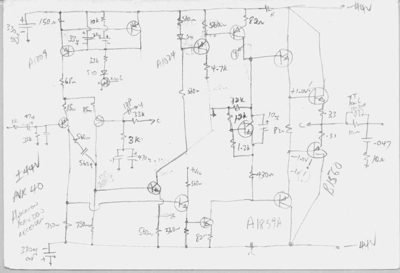

i figured that much..but was too sleepy to try to attempt any sort of removal..![headshot :headshot: :headshot:](https://files.diyaudio.com/forums/images/smilies/headshot.gif)
..anyway...here it is anyway.
Maybe you can see them fine, and therefore don't realize anything
went wrong...
Thanks, Poojita. Strangely, that schematic doesn't look like the same circuit I saw in the manual.

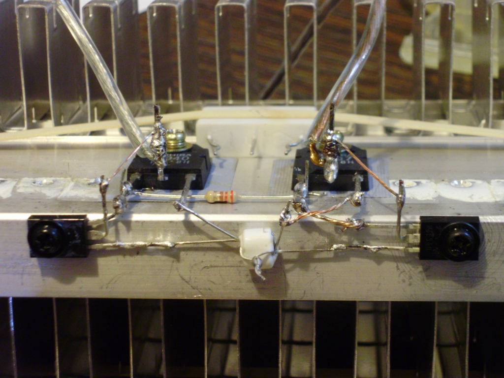

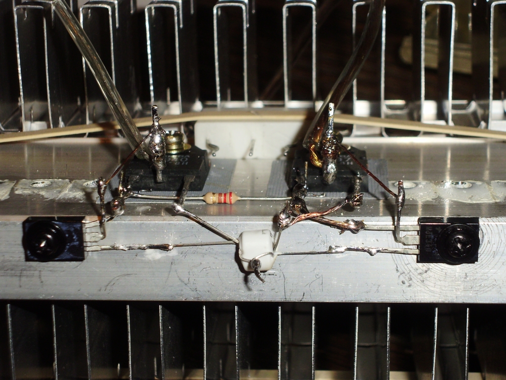

Well, in my free time I've decided to "test my soldering skills" on the Allison.
I think it looks nice! Two pictures are provided since the camera couldn't make up it's mind about flash...
The white thing is a 5771/5769 pair stuck together with heatshrink. The only thing I have yet to add are the bias resistors, which I am at a loss for. I need highish watt 1, 2, and .5 ohm resistors, which I can get locally.
The soldered together leads sticking out from the white thing is the input. The dual resistor is conceptual, theoretically the output will be the middle pin...
- keantoken

You have a pair of 2 ohm wirewound slidepots rated 25W each.
These are in little blue Clarostat boxes. Have you opened and
taken a visual inventory yet of whats in side the smaller bags
and boxes?
You have plenty of 0.12ohm wirewound resistors intended to
help bridge the voltage gap between output emitters. Those
were 2 or 3 watts. I wrote it on the bag, but can't recall now.
I gave you enough to fake any reasonable value in series.
Was thinking ahead Allison style when I selected those parts.
More big resistors are coming, but I think I sent you enough
already to more than cover whats requested in post above.
You just might have to get creative with parallel and series...

Whats behind the MJE340? And I'll assume MJE350 though I can't read the number?
I recall the backs of those (collectors?) as bare exposed metal... They can't both
be shorted to the same sink now, or can they???
You are going to have Micas. And wire aplenty, mostly 20ga solid in various colors,
which is also about right gauge for protoboard... I'll send thicker stranded wire too,
but the only color I got extra of is Red, and maybe Black... Hookup type wire with
the tough hard to melt jacket, not "speaker" zipcord style...

I realized I had those after I turned the computer off. I've already soldered one on (you included 4x2 ohm wirewounds, not 2). Though I worry about balance because my meter doesn't read such low resistances well (either the resistor is way out of tolerance or my meter has problems).
I'm using MJE350/340, ironically, to drive a pair of 1940/5197. This time in Darlington configuration (Last time it was CFP...).
Some time ago, I breadboarded a CFP allison using 2 pairs of 350/340 per rail with .6mA bias current... I hooked it up to my 3" shoebox speaker and by accident, the LTP input stage was horribly off-balance. To this day, that was the most beautiful sound I've ever heard. Crystal clear, not muddy at all, I heard things I never heard before. The harpsichords sparkled and guitar was heavenly against an instrumental background. Those speakers aren't large but they are the best I have. Only one of them still works, something I regret greatly. They came from a broken $30 CD player...
Yes, I've looked at everything in that box, and it all got home safely.
I've seen those 6.5" drivers, but I don't know how long it may be until I have that much money again.
I am going to solder bootstraps next...
