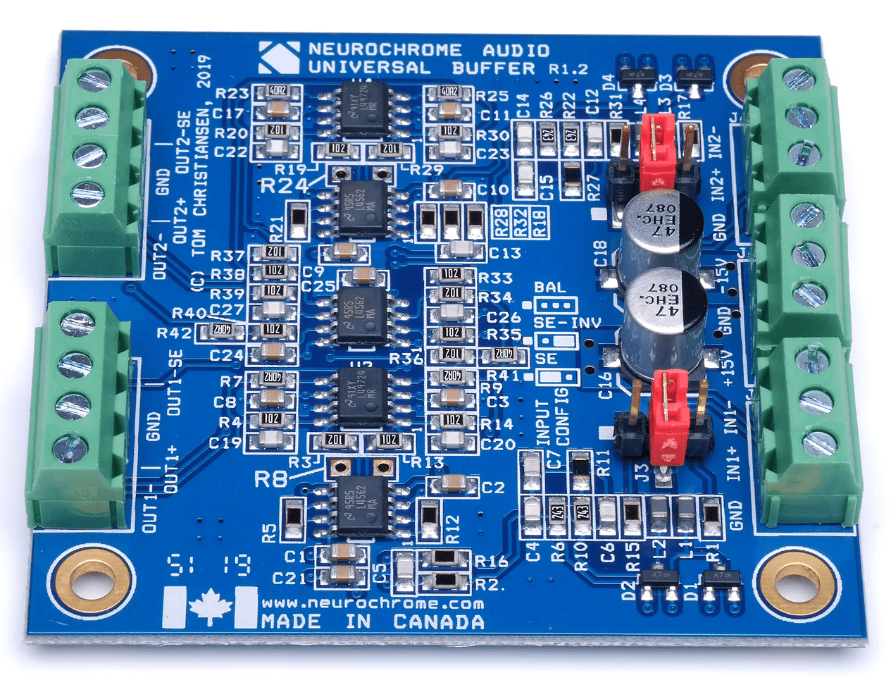

@Few ,
Check out Neurochrome Universal Buffer , you maybe able to power it directly from your 1000ASP's +/- 12.8V auxiliary lines.
It can be configured single ended to balanced with optional gain.
I am considering one for a 1000ASP subwoofer project of mine.
Hope this helps.

Hi.
AMB laboratories also have one balanced line stage. You can choice gain, operational amplifiers, ........
https://www.amb.org/audio/alpha24/

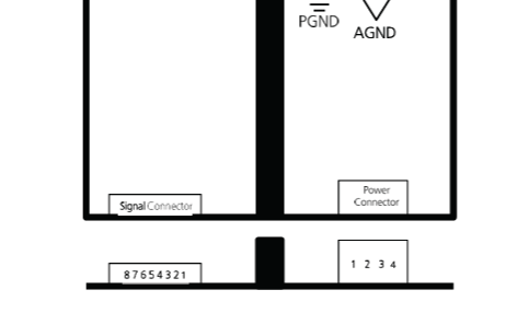

Well I finally tested my wired up Ice Power 1000ASP and 1000A modules. I first tested the 1000ASP alone (that's the module with the power supply) by connecting it to speaker driver and sending in a music signal (single ended). All went fine. When I connected the 1000A to the 1000ASP, and used the 1000A output to drive the speaker driver, instantly a ton of magic smoke poured out of the driver, and it no longer works properly.
I thought I had been over-diligent about checking my wiring before testing, but---unless I'm mistaken---I got tripped up by an inconsistency in the Ice Power documentation. I used the manuals for the 1000ASP and 1000A modules to figure out the connections, but it now looks to me like they give conflicting instructions. On the off chance someone else might run into the same trouble, I'll point out where I went wrong. Follow the 1000A manual when wiring up that module!

If you instead look at the 1000A manual, the diagram on page 4 includes:

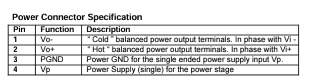

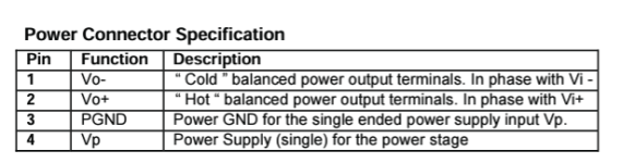

where the bottom portion shows an edge-view of the 1000A board. The four-conductor connector has pin 1 near to the aluminum bar in the middle of the board, and pin 4 near the edge of the board. On the next page, the pins are identified:
Pins 1 & 2 are the speaker outputs, pins 3 & 4 are the power inputs. That means the power inputs (3 & 4) are near the edge of the board, and the speaker outputs (1 & 2 ) are near the central aluminum bar. So the locations of the speaker outputs and the power inputs are reversed compared to the 1000ASP manual (at least as I interpreted the various diagrams).
Bottom line: following the 1000ASP manual's diagram fried my speaker, switching to the assignments in the 1000A manual worked fine, or at least they made music when connected to a speaker. I haven't busted out the ol' oscilloscope yet. My multimeter also supports the 1000A manual's approach.
Perhaps I'm just suffering from undiagnosed dyslexia, and nobody else will have this trouble, but I thought I'd share my experience in case it allows others to keep the smoke contained. Now I can move on to the buffer board and see if I can use the full dynamic range of the modules.
