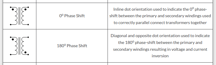

Are you talking about the phase for individual gain stages, ie. each tube, or the whole circuit?
In the end, a transformer can correct the phase by shifting the phase output (usually planned in advance and taken into consideration during manufacturing) and if possible reconnecting the 4, 8 and 16 Ohm wires in correct phase and order, but to be exact, your transformer symbol is missing those phase dots, it's often left out and assumed "everyone knows it", see attached picture.

Ok got it, but isn't that undesirable, unless I guess you switch your speaker wires around?

Thank you, I knew I wasn't going crazy with what I was thinking. I'm probably not explaining myself very well.BTW if you want the output be in phase with the input, just swap the secondary terminals of the output transformer.

The whole circuitAre you talking about the phase for individual gain stages, ie. each tube, or the whole circuit?
As is shown in the diagram, the whole circuit is inverting, and you normally don't want that.
Reversing output xformer secondary connection would correct that, yes.
But it's very unlikely you'll hear a difference, unless you know what is playing at any time ;-) .

It all makes sense now, as mentioned in one of the previous replies, a lot of these schematics assume the phase will be corrected (via transformer or input signal).
But because a lot of these schematics don't indicate stuff like this made me question if people build stuff and ignore the phase.
I believe the speaker will move in opposite directions with the phase inverted compared to the original studio recording. This may or may not be ok, of course it would be best to get the output phase correct in the first place.
