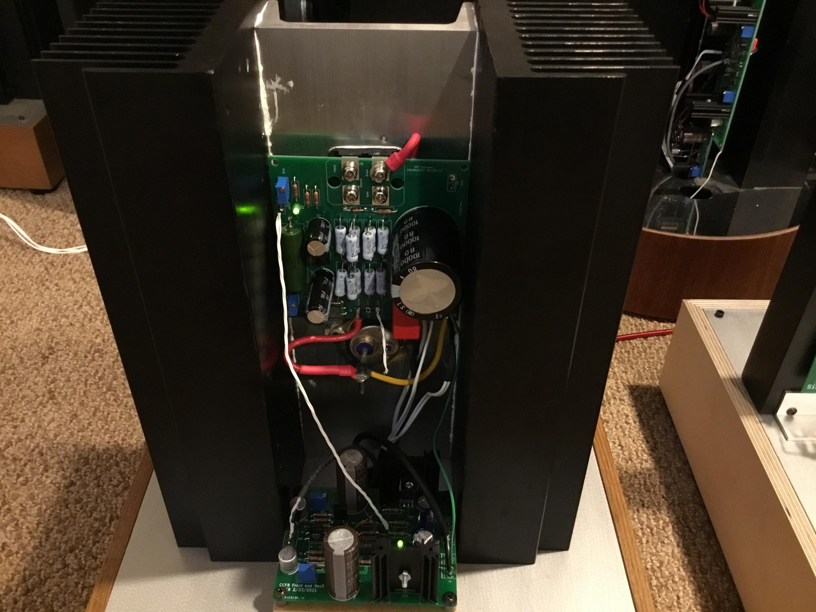

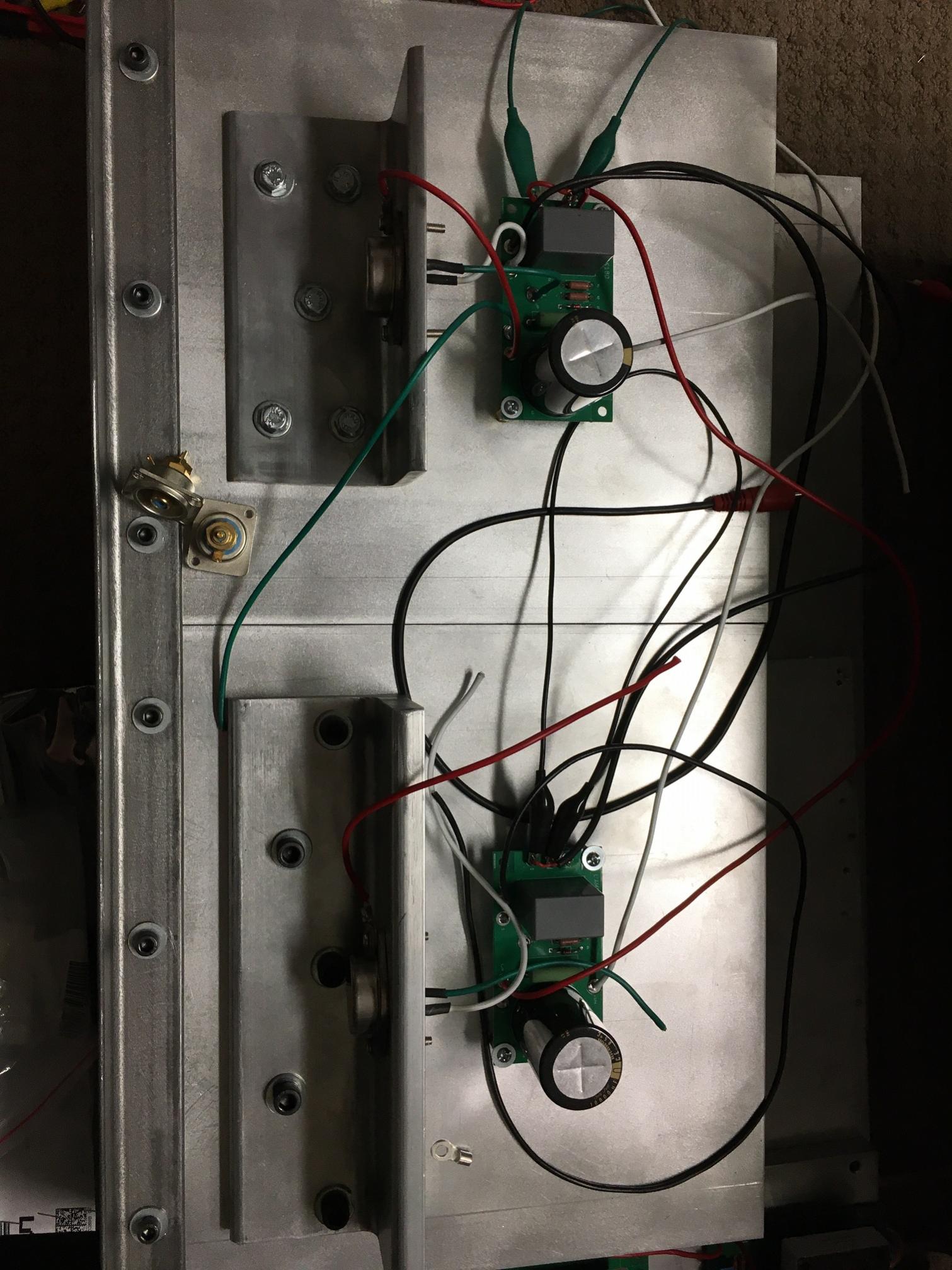

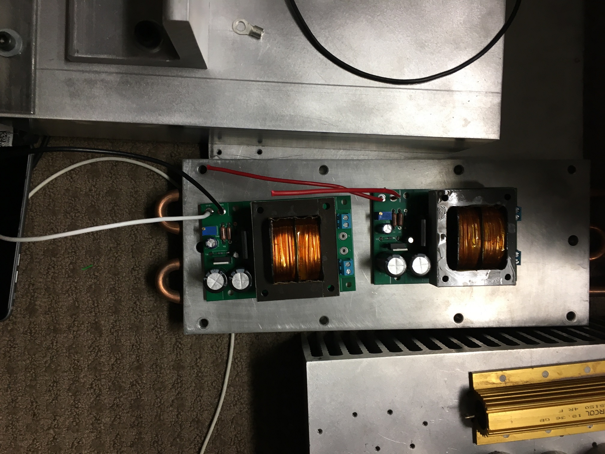

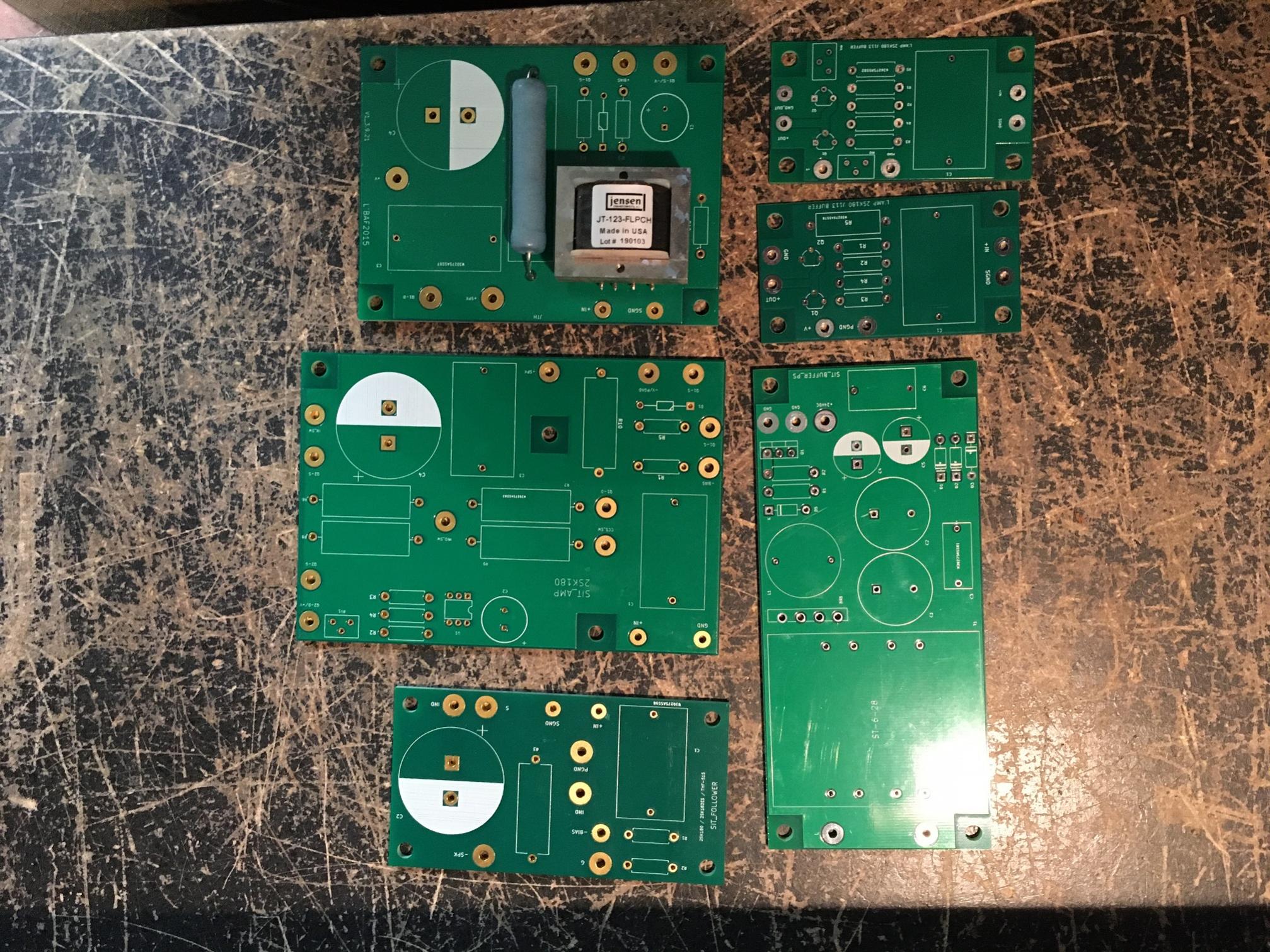

Build them all, thats my motto. I've been following Ben down this rabbit hole. Only way to keep up with him is to build an open chassis so things can be swapped out with ease. Had boards made to make the process a little cleaner.
J113 buffer with PS
SIT Follower with Inductor
SIT Common Source with Inductor Load (the one in his initial 2SK180 thread)
Even did a BAF2015 with Inductor Load
separate -bias PS
SIT with Mu CCS
J113 buffer with PS
separate -bias PS
SIT with Mu CCS

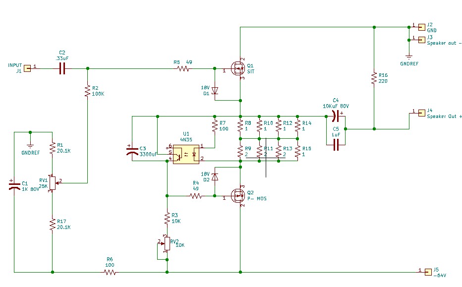

Here is where I'm at as I work for a similar follower output. I'm starting out with a CCS and can change to a Mu easily.
I'm keeping in mind that I will need to play with the VDS and Bias to find the distortion profile I'm looking for.

Hi Botte,
That is fundamentally the same as my circuit except mine has the mu output connection and yours is straight CCS. One thing you should consider is the gate leakage current of the Tokin. Your R2 100K may be too large if your Tokin's gate leakage current is high.

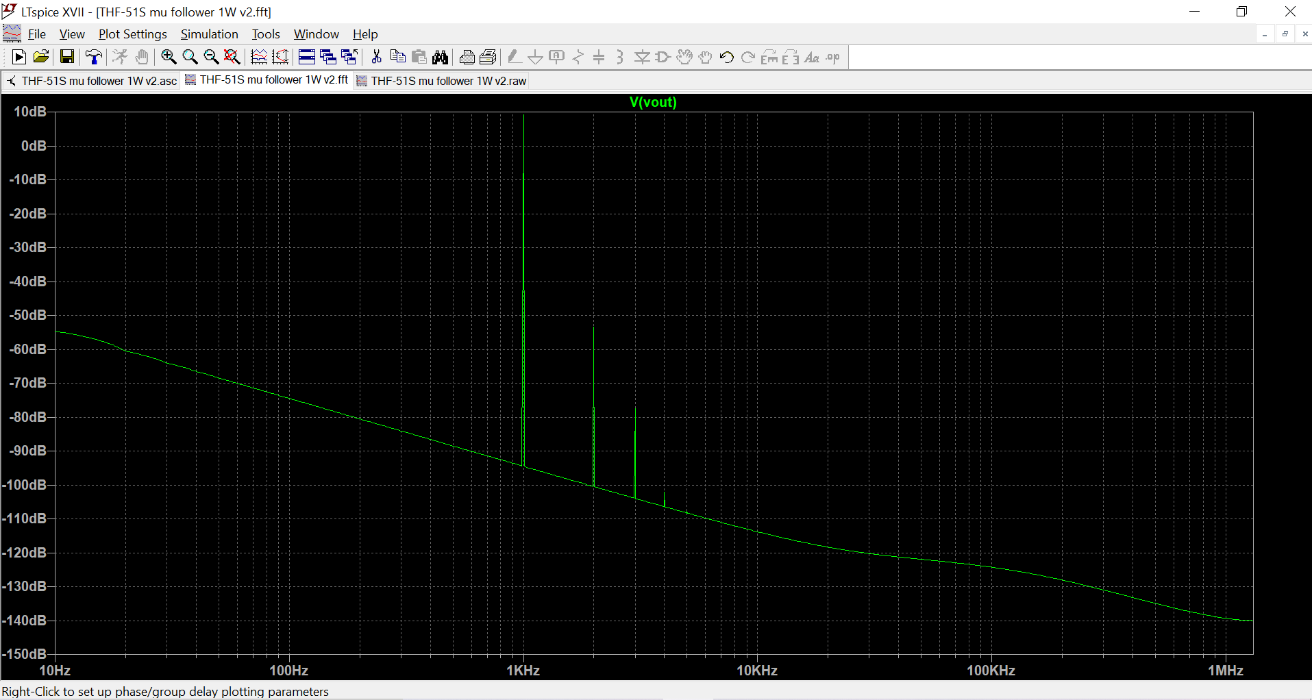

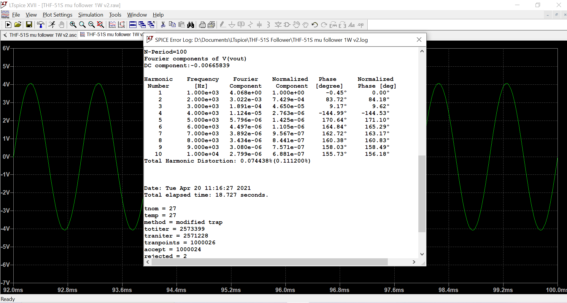

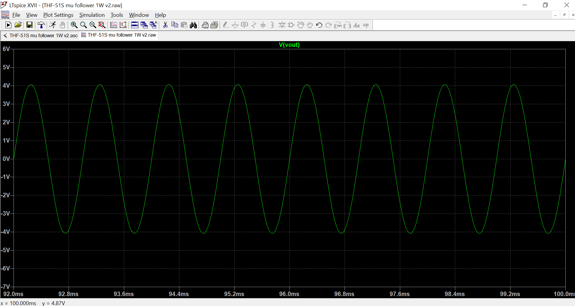

I posted the simulated 45W distortion results previously. Here are the simulated 1W distortion results for comparison:
I'm getting micro amp level Gate currents in testing, and I always check the DC
across that resistor. So far, not a problem, and a little drift is not a big deal.
I have been using a 10k resistor in all my VFET/SIT builds after reading Michael Rothacher's L'Amp posts on the subject. I have to admit that I just did it and never measured the actual gate leak current.
So yesterday I got curious about the gate leak current of the 2SK180s in my 2S180 193V follower amps. First I looked up the Tokin specifications and they specified 100uA maximum at Vgs=-40V. Then I took some measurements over a span of several hours. The results are here:25W Single Ended Hammond 193V Choke Loaded 2SK180 L'Amp
What I found was that the gate leakage current increased during the time that I was monitoring it and it got as high as 143uA (1.43V across 10k resistor). So in common source mode it had a significant affect on the bias voltage.
I think I was just unlucky to get these two misbehaving 2SK180 Tokins.

I have my version of the big VFET follower up and running.
Adjusting has been fun. I started with a CCS and found that the second harmonic was just about canceled. So I did what you did and changed to a Mu follower. I’m at just about exactly what you had. 50/50 split and with that I’m running the VDS at about 29v with a power supply of 65v. This gets me about .1% at 1W.
