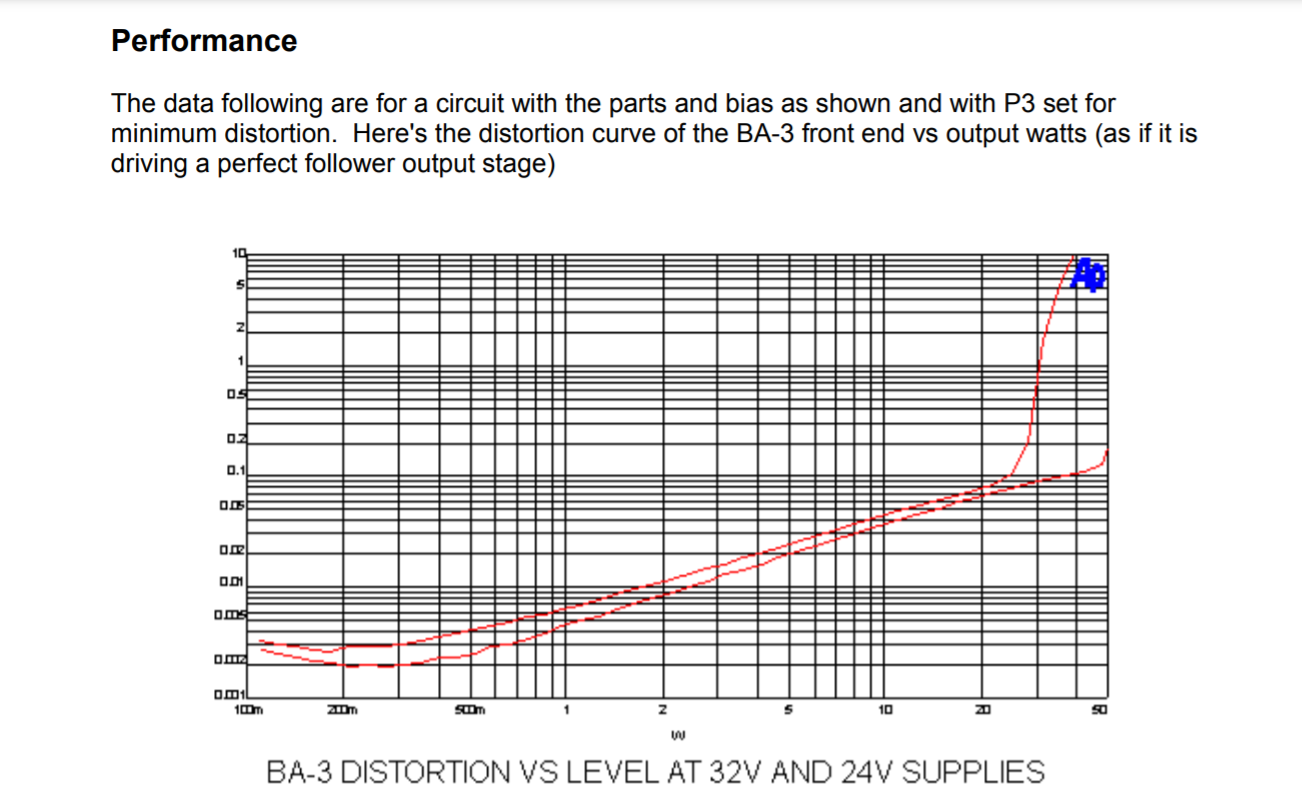

The BA-3 front end with +/- 32V power supply seems to have just enough voltage output for 50W.
From https://www.firstwatt.com/pdf/art_ba_3.pdf
BA-3 front end will work - see post #145 above.

I have very sensitive speakers (102dB) so I do not need the full 50W. The Luminaria outputs enough voltage for about 40W from the amp, but that is with about 5% THD from the preamp/power amp combination, with the Luminaria adding quite a bit of distortion at its maximum output. But I don't need that much power, probably using less than 1W most of the time so the THD is probably much less than 0.5% at that power level.
The amp with a clean input will probably do 50W with about 2% THD. You can check my previous posts for various distortion measurements.
If I need more input voltage, and I don't, I would add a voltage gain stage between the Luminaria and amplifier. I think the BA-3 FE would be a very good candidate. Since I have more than one common drain amplifier, I would build it standalone so that it can be used with all of the amplifiers.
Another option is to use the BA-3 FE as the preamp, eliminating the Luminaria. It's just a matter of preference - a bit more or a bit less distortion.
