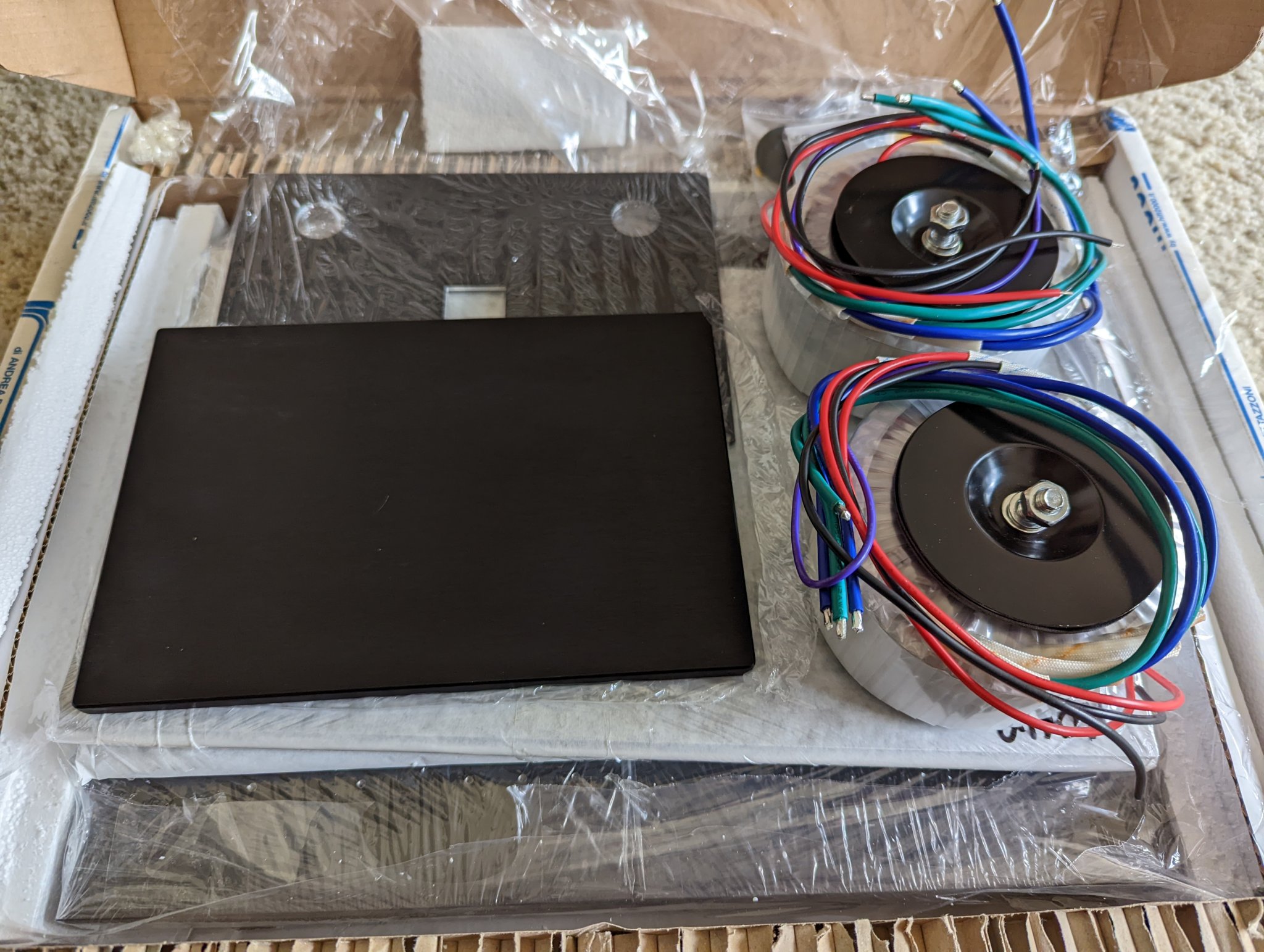

The new Modushop Monoblock chassis arrived today, as well as my two Antek 300VA donuts. It may be a tight fit with everything stacked in there, but should be worth it to not take up more real estate.
This thing is also not going to be light. Chunky boi.

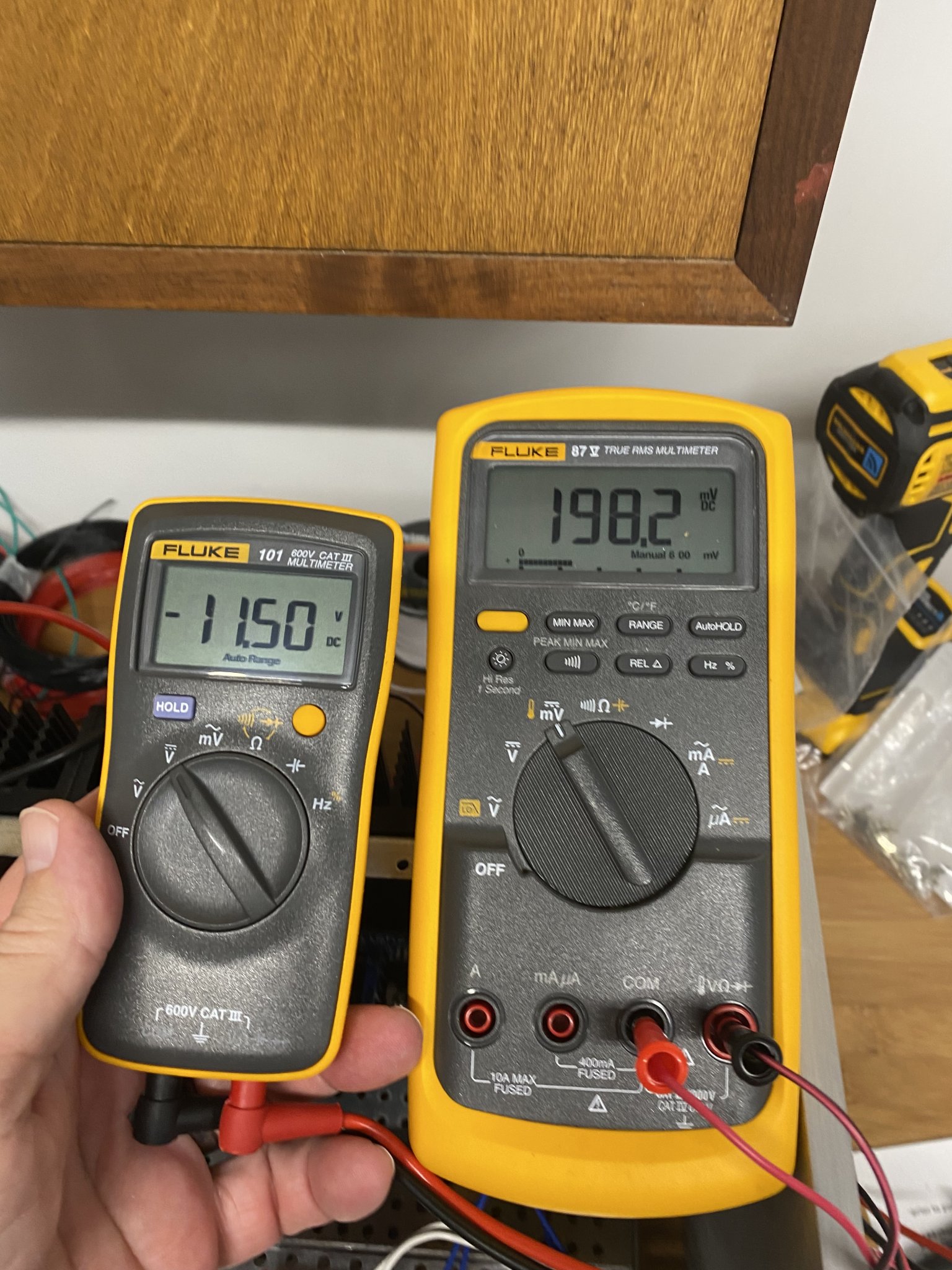

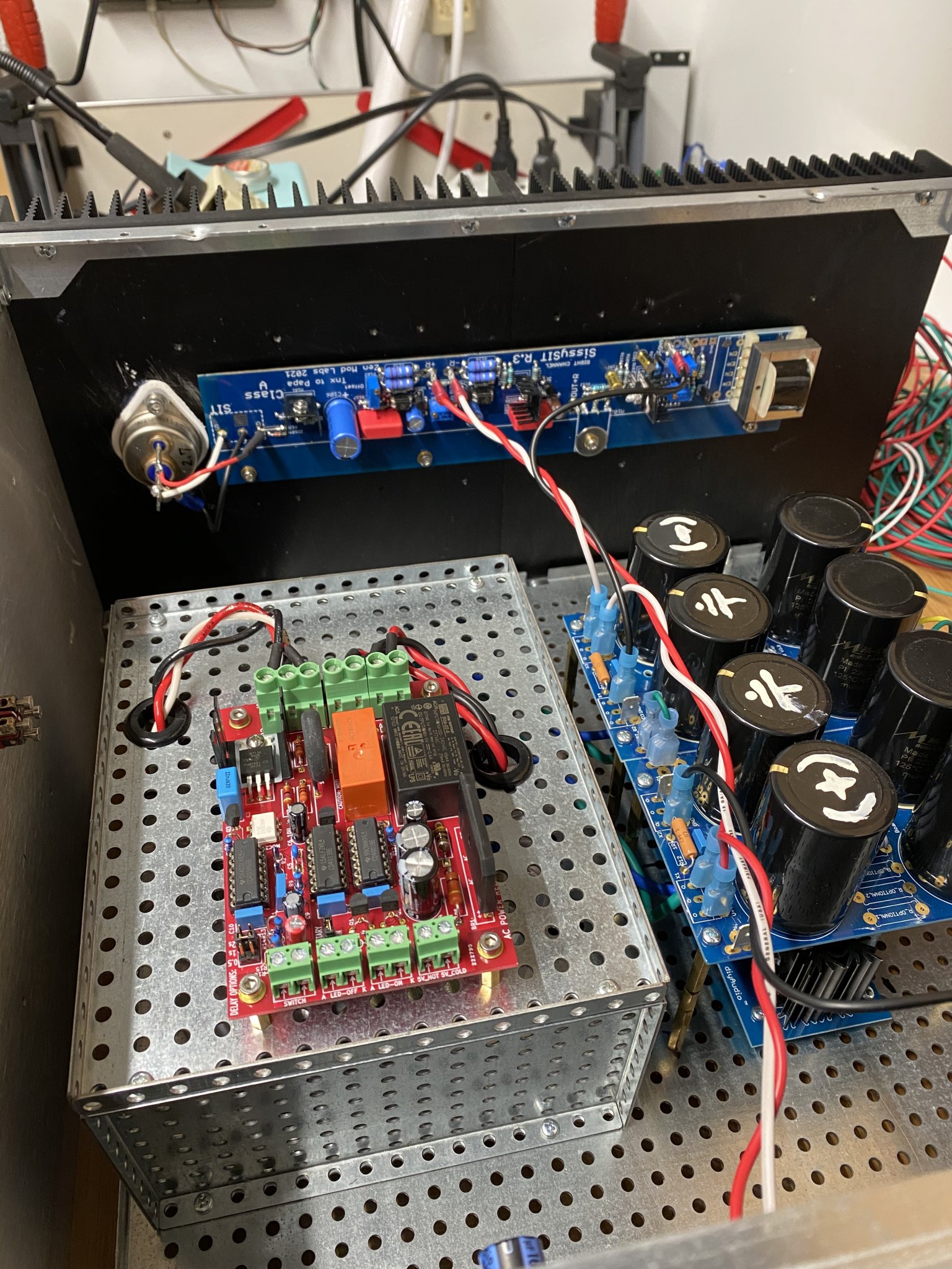

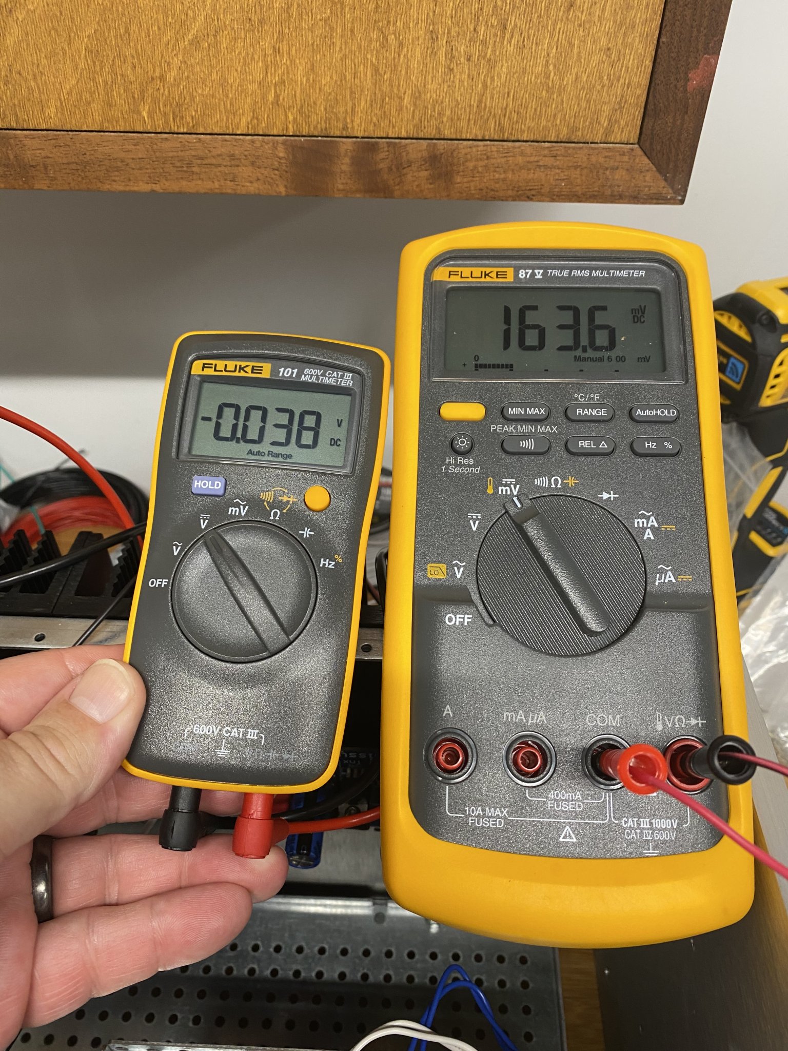

Wired mine up (finally) today.
New switch board working fine, to sure about the LED in the bulgin momentary switch. I can get it to come on with the wires either way. Power on, with delay, and power off fine.
1) first board I could get 160 mv fine, and finally got DC offset close. FE set fine.
2) Other board set up nicely. 160, DC good, FE good. Biased up to 198, with 0 DC offset.
3) Back to first board, Bias tops at 194 mv. DC offset stuck at -13.x volts, and does not move with the pot.
verified both boards getting 22.3v under load.
Suggestions?

SissySIT R3. THF-51S from watanabletomoaki (roughly matched)
I never got bias up over 160mv across 0R11, and that DC offset went under 2v. When I returned from doing the second scanner, I figured the voltage drop from second board hookup might smooth it out, but it got worse instead.
max Bias is 164, not 194 (my mistake above), with offset -13v or so, and unchanged by turning to offset pot.
