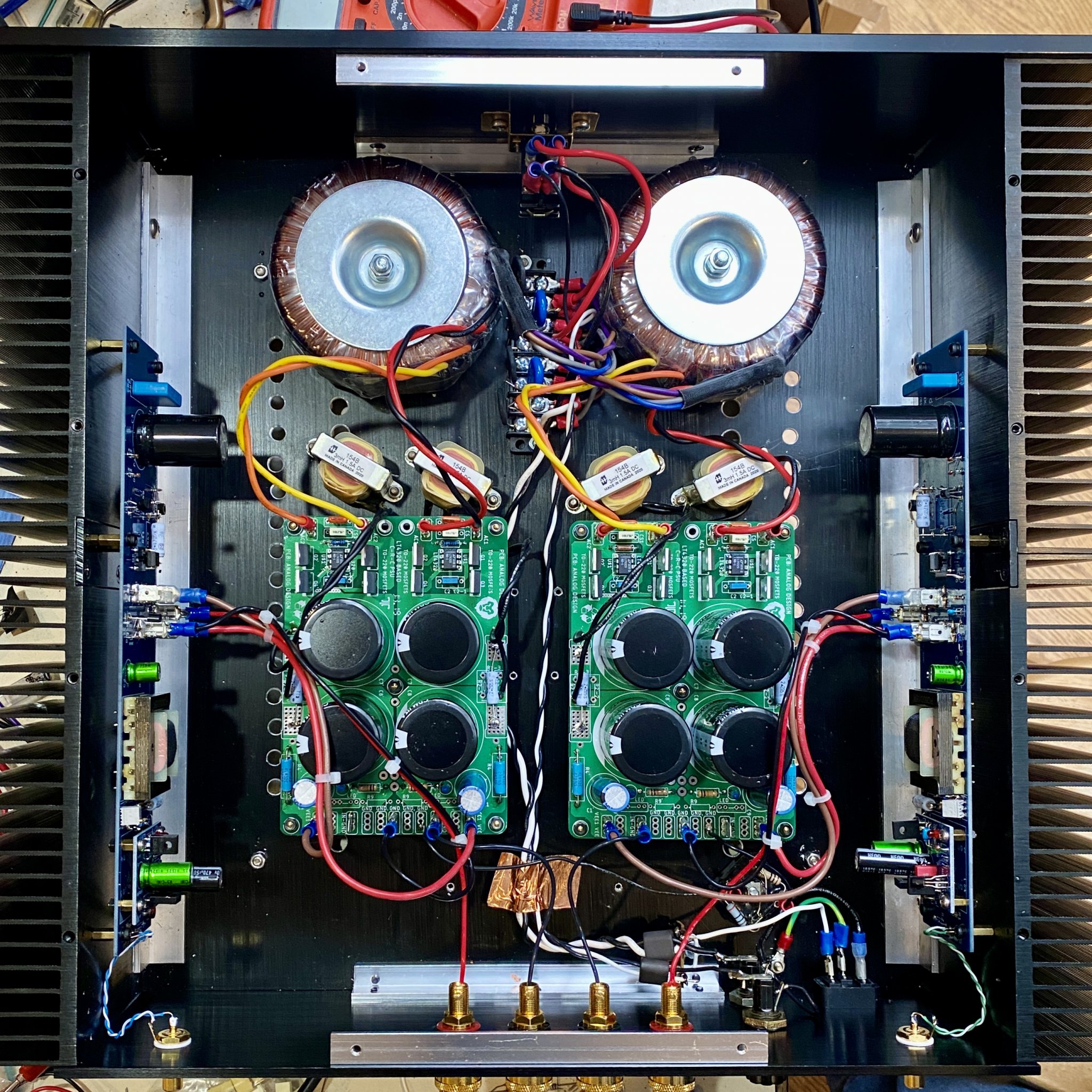

It is certainly possible to build a CLC supply that will work well for various First Watt and related amps. Dual-mono is the way to go. For ease of reuse, the supply will probably be best in a separate chassis, with a carefully built umbilical power cord to supply the amp.
The chokes do need to be chosen carefully, and will end up being some of the larger components in the supply. Look for inductance around 2.5 mH or larger, and DC current capacity of 2A or greater. Chokes that are rated for DC filtration will be Ok running close to their rated amperage, and may exhibit slightly reduced inductance when run at higher current.
I have included a picture of the recent supply that I built for my M2x. This was remarkably quiet with speakers of average efficiency, but showed some slight hum pickup when I switched to higher efficiency speakers. The hum was due to coupling between the power transformers and the Edcor signal transformers.
Reactions: ranshdow and cwlo

@TungstenAudio, nice build. I have standalone synchronous rectifiers aswell, and will reuse them.
Could you tell me the purpose of your two 3W resistor? I imagine one of them being a bleeder, but the other one?
Regarding the iron, I don't have Trafomatic guys next door, but I may break the bank with our friend Alexander, the crazy winder, for some fancy chokes that give better sleep 😎
