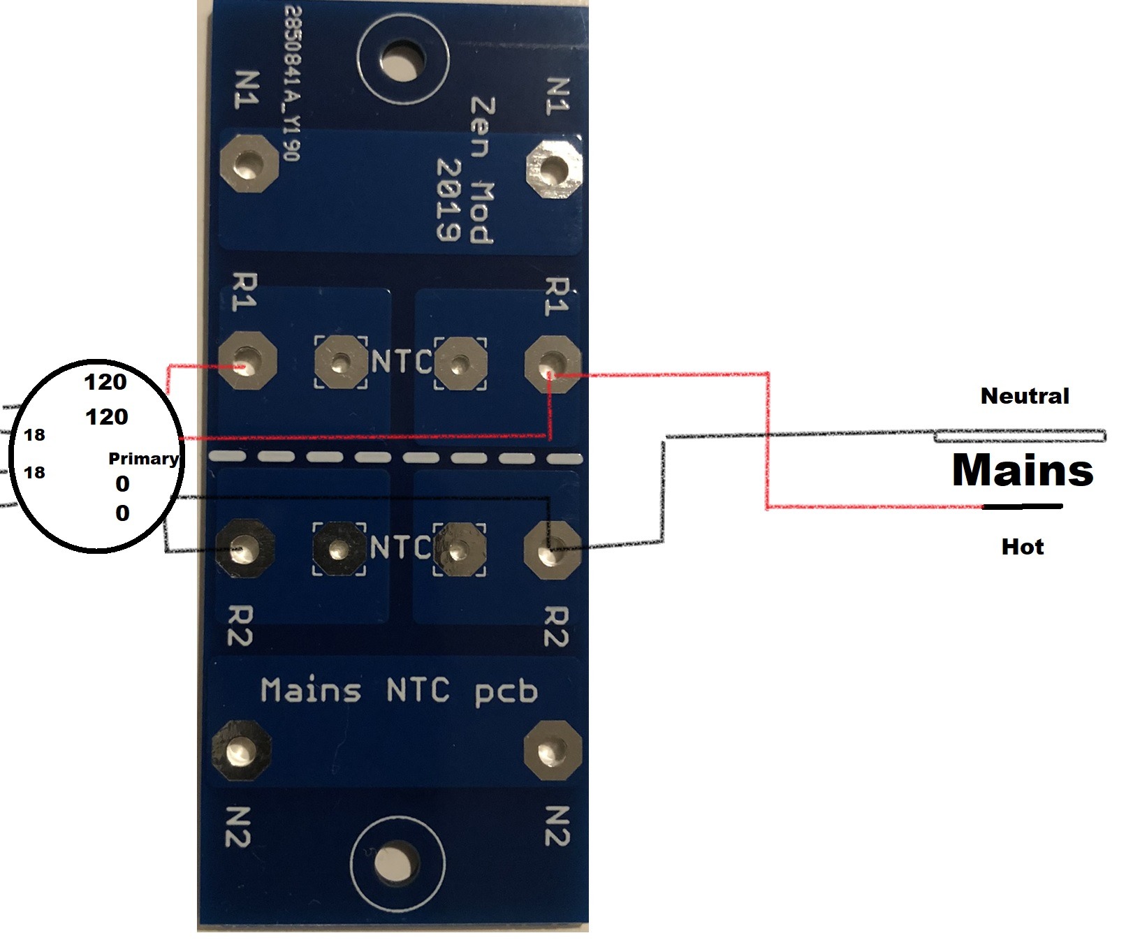

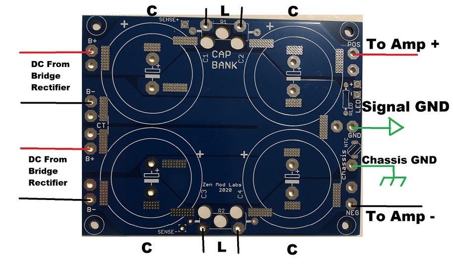

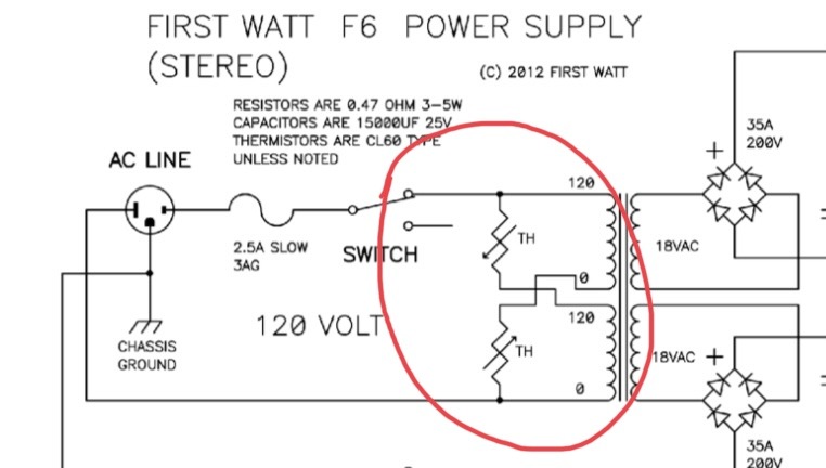

While I'm waiting for caps and monoblock chassis and other stuff to arrive, I thought I would start sketching out a wiring plan using the boards Zen Mod provided with the SissySit R.3.
I am going to implement a CLC for each monoblock using 33mF Caps and Hammond 159ZJ chokes. I adapted the Mains NTC boards to work with the F6 PSU diagram, which uses 2 CL-60s from the Mains to the transformer.
I banged out these pictures quickly in MS Paint, so they are crude. After I finished I realized I could have drawn the Mains NTC wiring without having to cross wires on the picture - it's not worth going back to correct
Is there anything tragically wrong with my layout?

This makes sense, thanks for redrawing this! The drawing I found (and now can’t find) showed an NTC on both the 0 and 120 transformer taps which is what I attempted to duplicate using your boards.cap bank pcb is OK, NTC pcb is tragic
see:
Si amigo!it is irrelevant on which side of primary you put NTC, as long you have intended number of them
illustration - if you have series RC combo, it is pretty much irrelevant is it RC or CR
comprende?

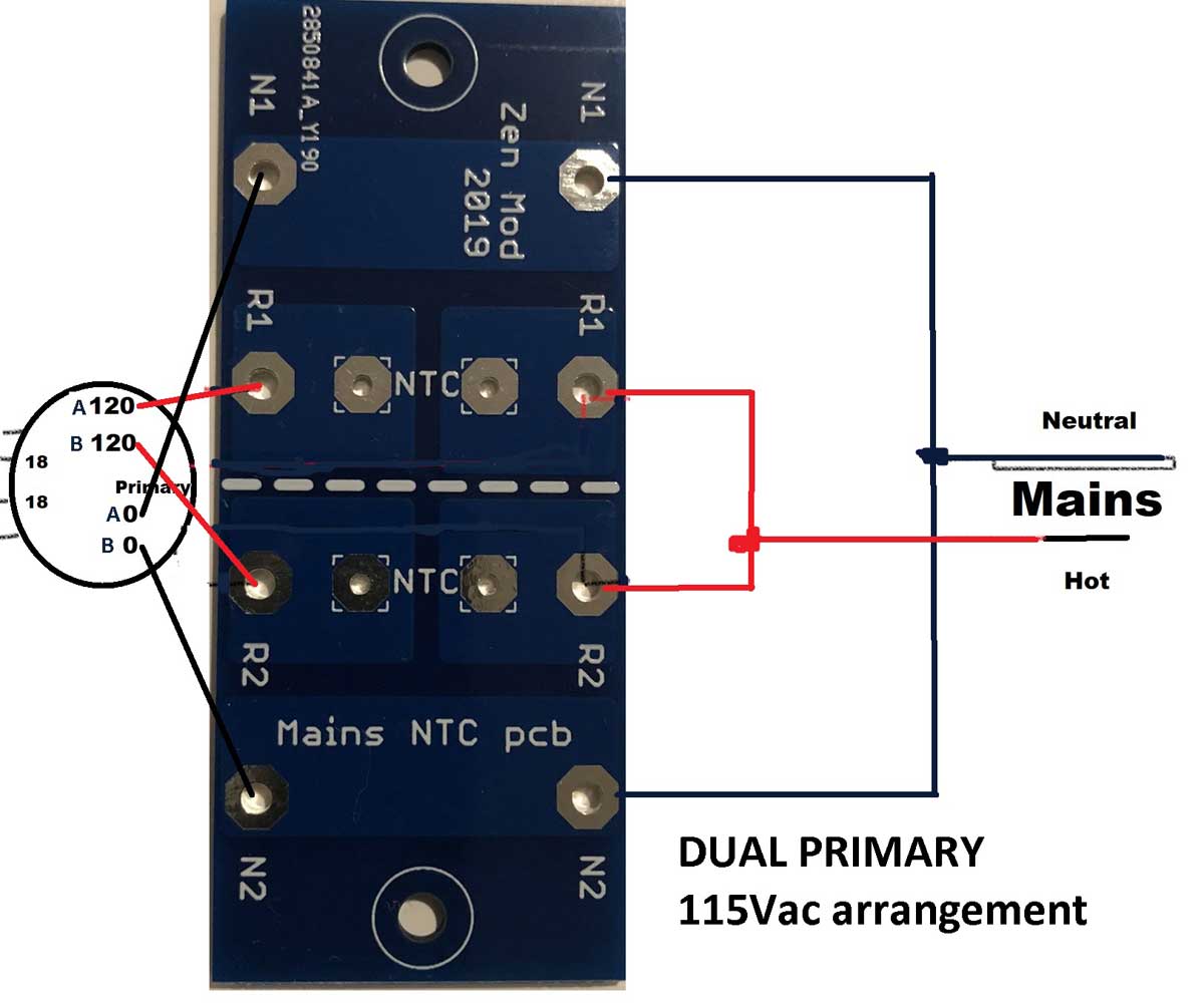

update: I found the picture. I edited for clarity. This is what I attempted in my illustration…
![572A4D7C-802D-4727-AEA0-49D1EFDA6D97.jpeg 572A4D7C-802D-4727-AEA0-49D1EFDA6D97.jpeg](https://www.diyaudio.com/community/data/attachments/1004/1004064-d2f29f15427609f6280285f273095f6c.jpg)

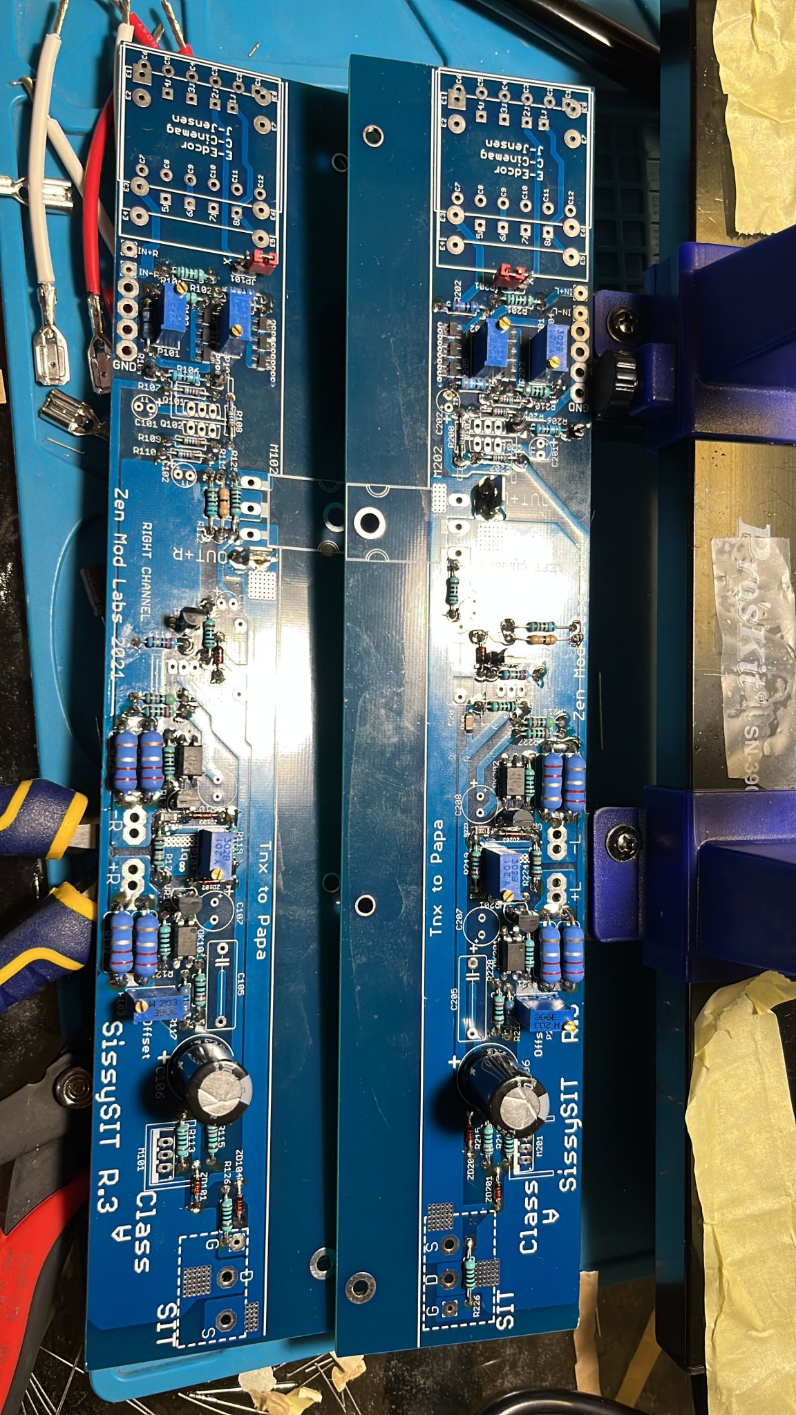

Before I start stuffing the amp boards with the parts thought of creating a BOM of all the parts included in the kit based on the schematic. Here is the excel sheet for both the channels that I could find on the schematic and I am yet to reconcile this from the kit of parts that mighty zenmod shipped in the package. I believe his kit is top notch with all the parts exactly per the schematic.
I hope I have not done any mistake with the qty and part numbers.

I think its a LT3092 instead of 3062 based on schematic
Wouldn't worry too much about qty, you'll find a place for all the parts, and all the holes should be full when you're done.
Oh yes my eyes need to be blamedyup, LT3092, it's written loud and clear
@Zen Mod need a clarification with the kit that you sent me, I see that I got 22uf/16v Silmic caps instead of the schematic 10uf/16v for C104/204. I hope 22uf is good enough in this position. Also the C107/108/207/208 schematic says 470uf/16v and I got a slightly different value in the kit. I hope these replacements are good.

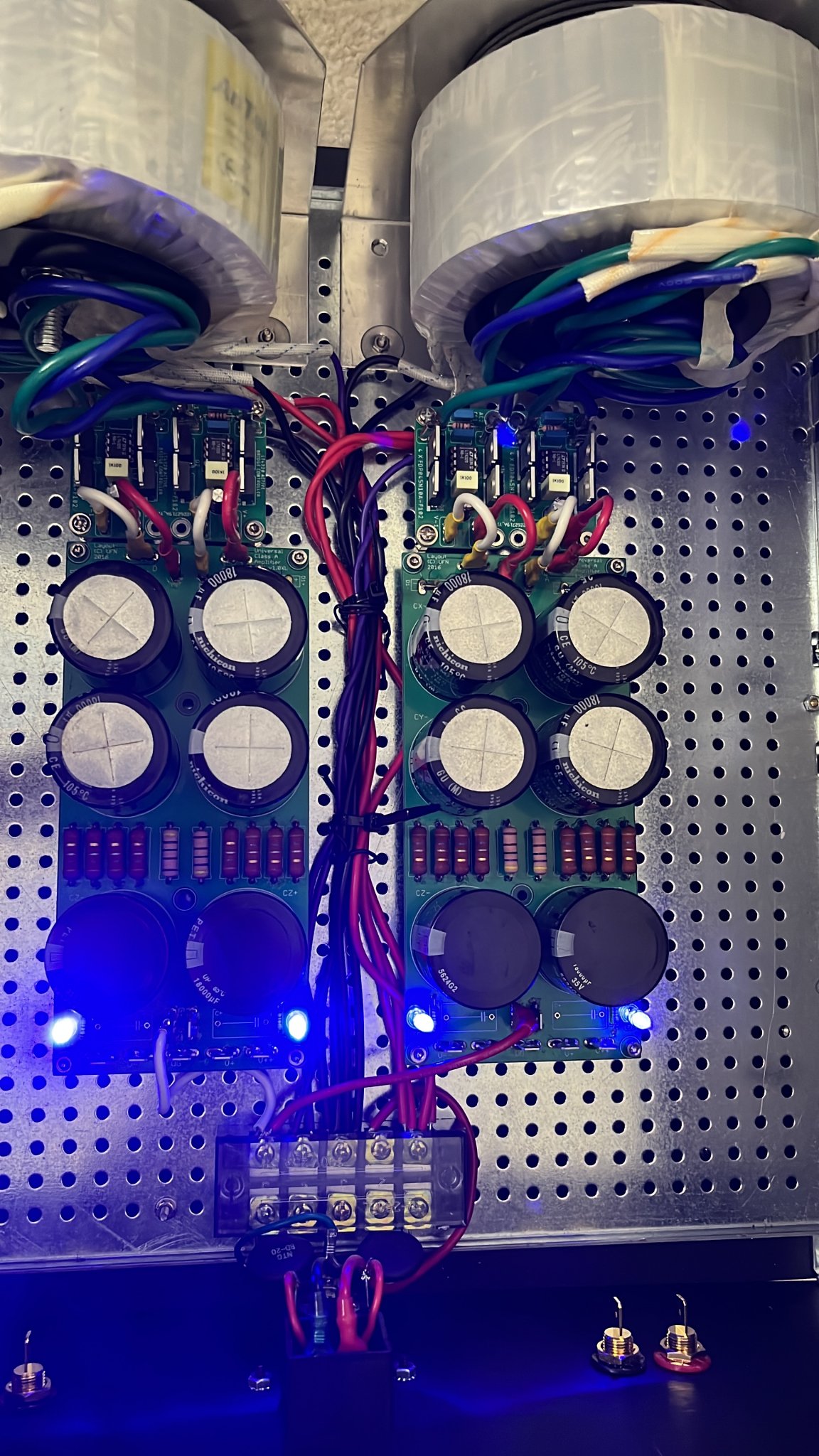

Little more progress on R3 today -
Made some cables for the bridge rectifiers to the PSU boards and tested the output voltage with all good so far.
input Silmic - more the merrier; when I was ordering them I saw that I can get 22u for same price as 10uF, so why not
caps between output gates - whatever I sent you is OK, going from 330uF to 1mF, voltage 6V3 upwards
