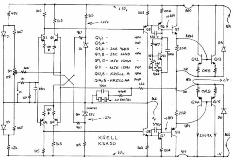

Is it a coincidence that the Krell KSA has similar initials to SKA and the schematics have a lot in common ?
On the bias issue, I believe owners have found the higher the bias the better the sound, with the main limiting factor being that the older designed boards (pre 0.15R's being added) had more bias fluctuation so builders had to be careful that bias didn't run away. With the R's added you can be more adventurous, I believe (I only have the older design at the moment).
I was thinking about the front end, the complementary LTPs with constant current tails and complementary emitter follower buffered VAS; similar dc-offset adjustment scheme. After that they're quite different as you say but if you look at them through your bad eye then there are still these similarities. Terry said his GB150 sounded more like his Krell clone than any of his other amps.

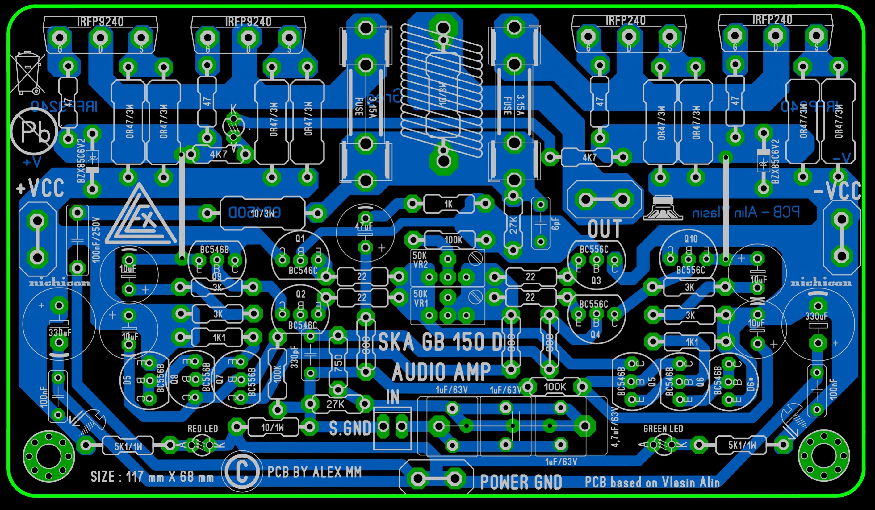

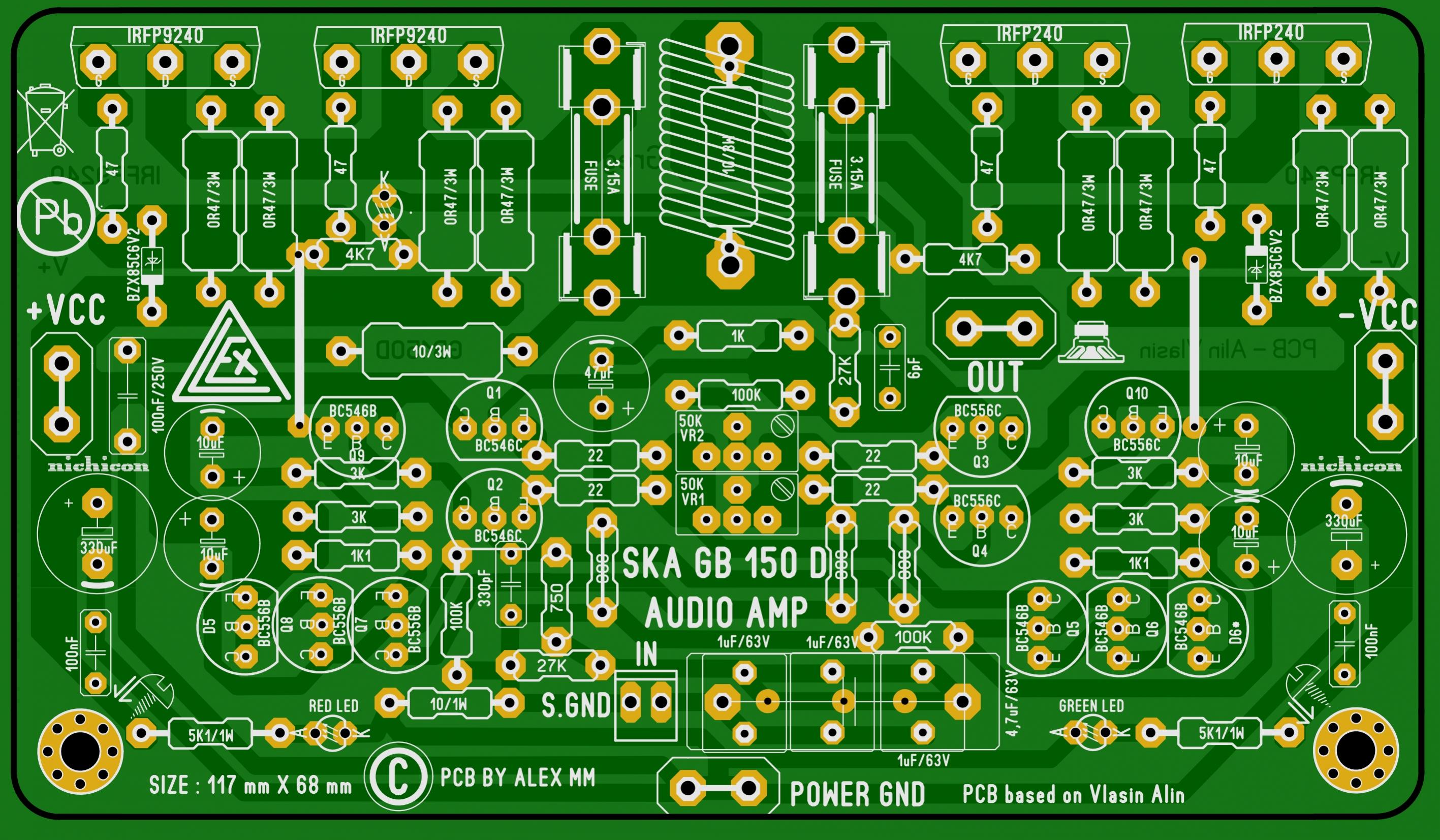

Hi SKA builders!
The PCBs from JIMS Audio have arrived, it's time to build this wonderful amp. I already have a +-35V, 500VA toroid and a power supply board with 60k mF elcos. I wanna build the amp as cool and as compact as possible.
Dear PaoloPT!
There are a few questions for you, if you allow.
I checked the loudspeaker portection on pix, what you've uploaded in builders thread, and it seems to work without external PS.(?) What protection do you suggest?
Is it worthwhile to order matched output fets from ebay?
A have tons of BC546 - 556 already. Could I use them in LTP's? (twisted and isolated legs, of course) or are there any reason to avoid them in JIM's PCB?
Thank You for your answers and congratulations for your amplifiers.
Cheers
Alex
Hi egra,
My speaker protection is powered by the transformer's secondary winding, 0-35V AC.
Any speaker protection will be fine, you can check the one at DiyAudio store.
Yes, you have to match the output IRFP's at 10mV VGS or better. This is very important!
Absolutely! For better results use the "C" grade ones - BC546C and BC556C.
Be careful when soldering them, they have EBC pinout and pcb was made for the 2SC/SA which have a BCE pinout, so you have to twist their legs.
