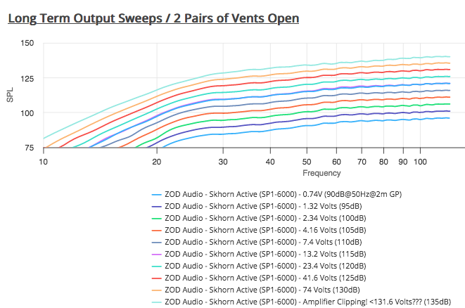

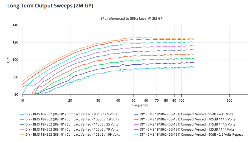

The BMS 18N862 in a 7.6 cubic foot (215L)gross has similar output per liter as the Skhorn, 24cubic feet (679L) cabinet, both with 25Hz Fb. Add 9.54dB for three cabinets- which would fit in the space of one Skhorn.
The 1x21" SKRAM has less slightly power density than the 2x21" Skhorn.
Two meter SPL add +6dB for one meter equivalent:
BMS 18N862 20Hz 108dB, 25Hz 114.5dB, 30Hz 118.8dB
18N862 x3 20Hz 117.54dB, 25Hz 124dB, 30Hz 128.34dB
Skhorn 2x21"B&C IPAL 20Hz 116.5dB, 25Hz 124dB, 30Hz 128.5dB
Building a bass reflex with blockable ports is much easier than a complicated cabinet like the SKRAM, and multiple cabinets allow a lot more placement flexibility, and the ability to do cardiod arrays.

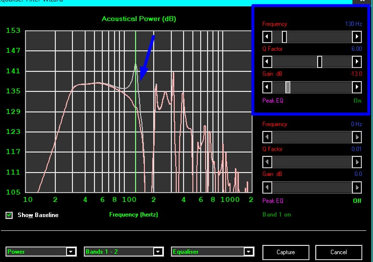

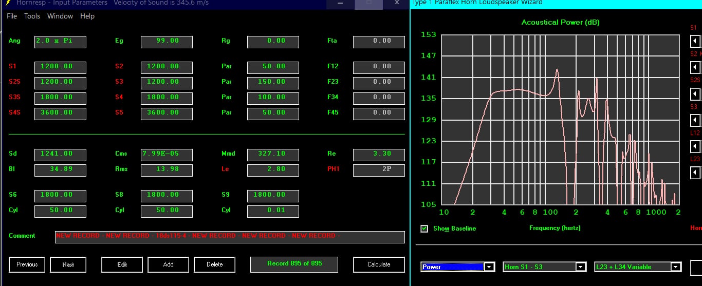

Rediculous (huge) parallel pipe designs with 18ds115-4. It interesting how well it ‘behaves’ in a pipe 1/2 Sd ?
Maybe there’s a way to downscale this? And/or Get rid of the big series exit section that flattens it out so nicely
