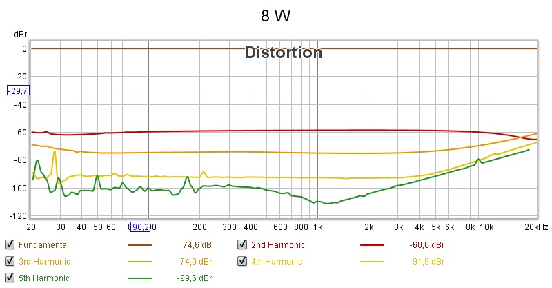

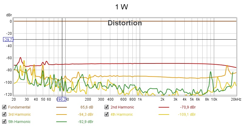

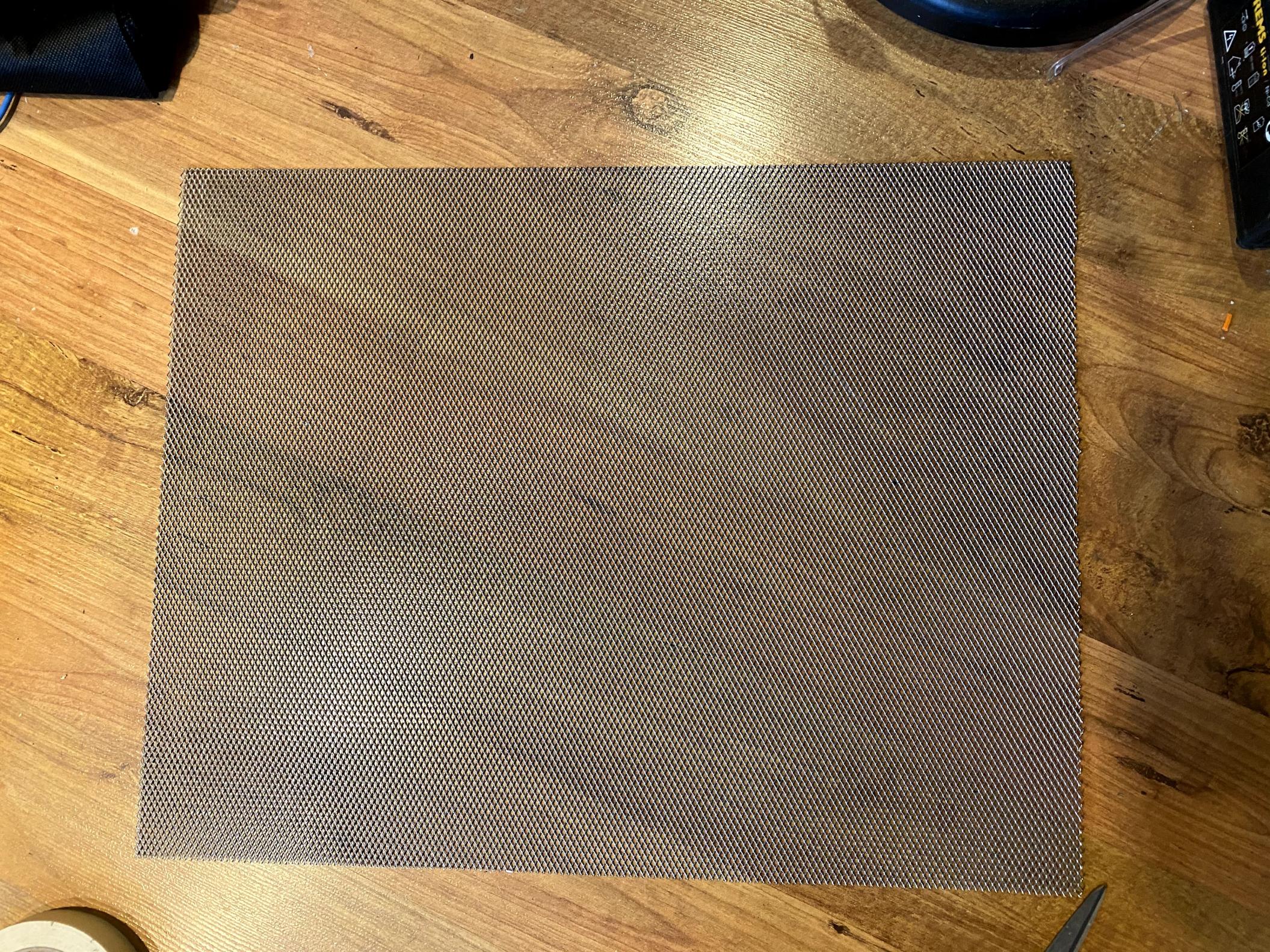

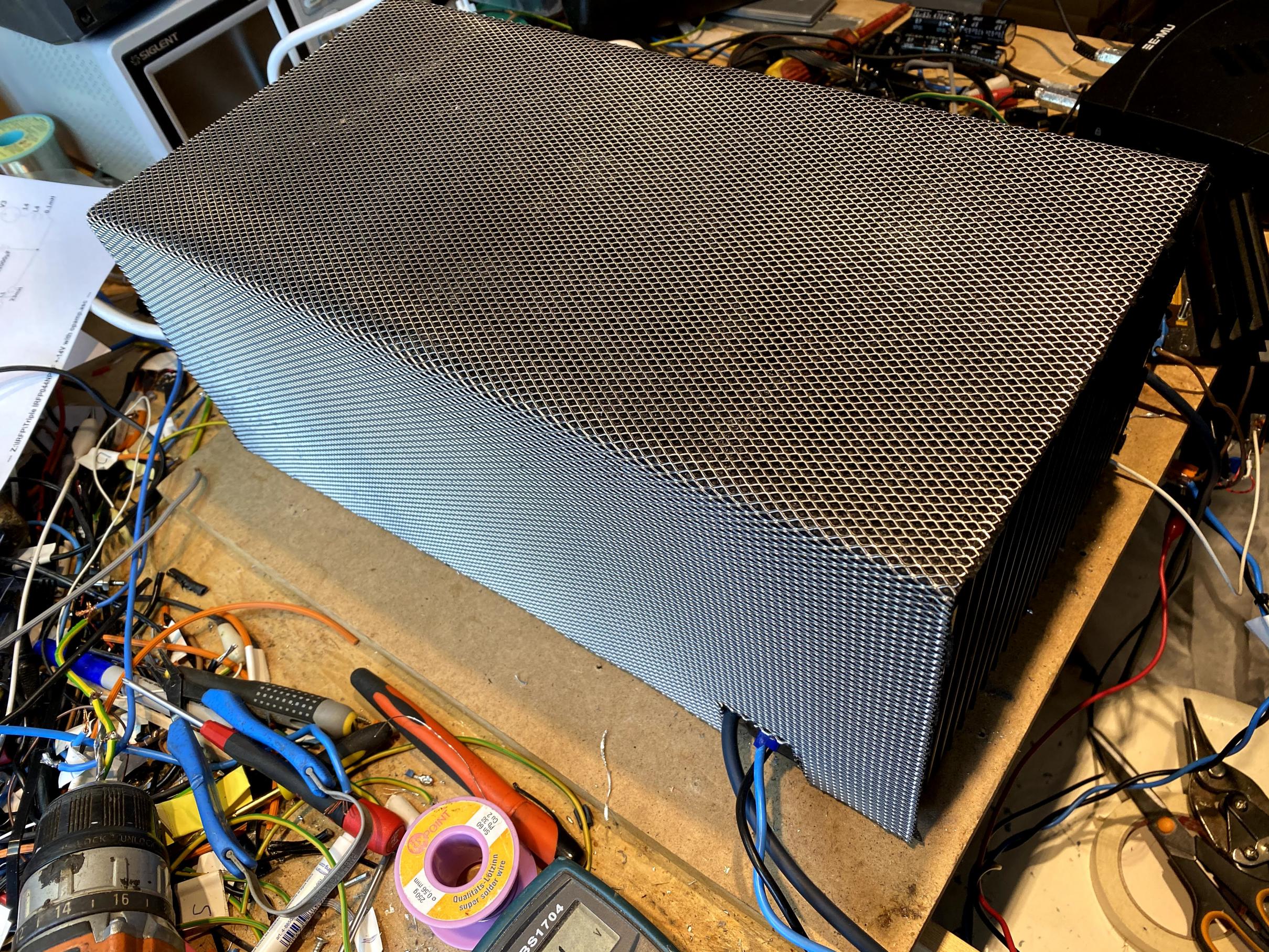

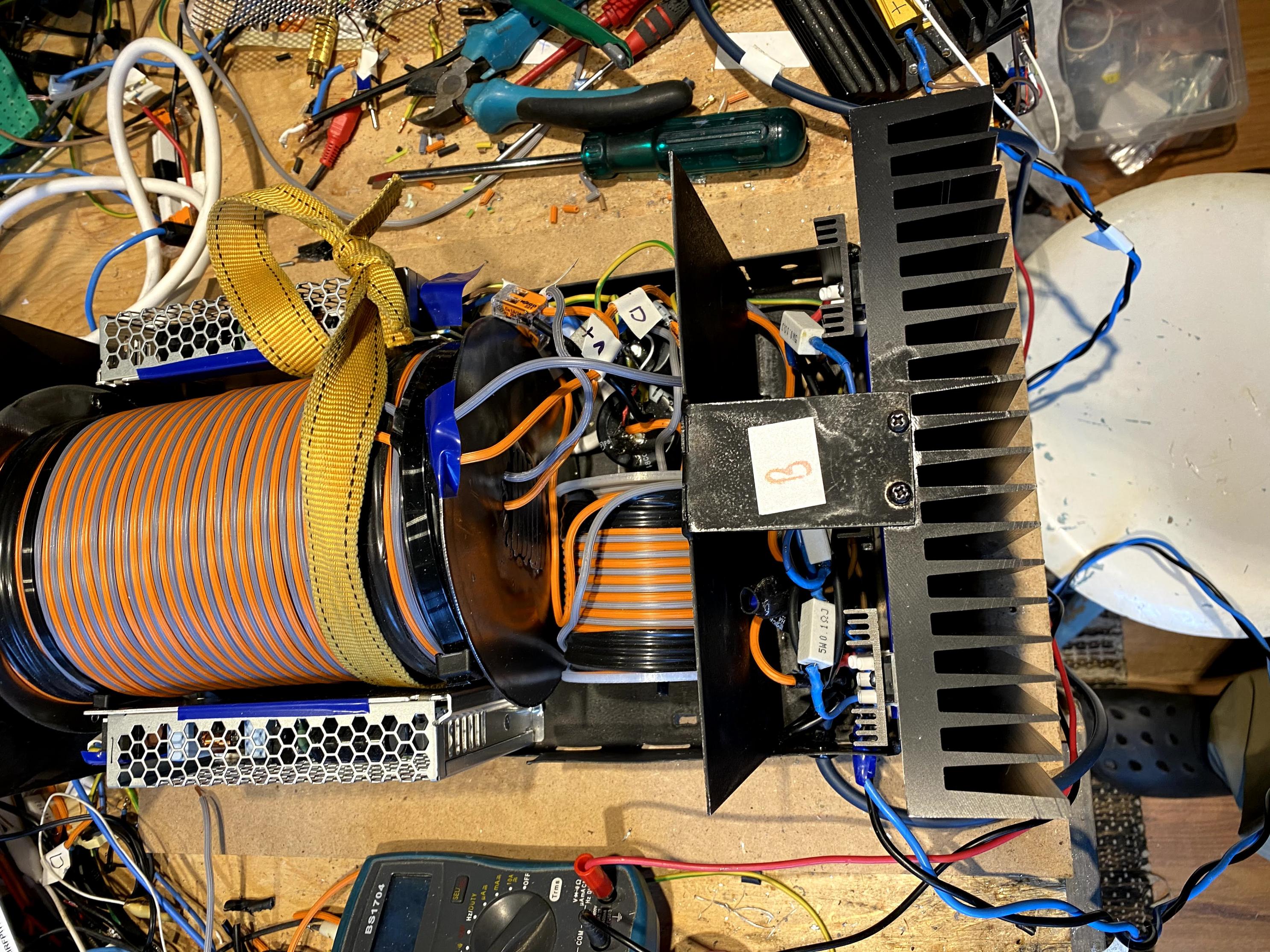

Made the SLAPS coils with iron core, put the whole thing into a box and put on a simple mesh metal cover.
Included is also measurements with this SLAPS for SLAM! at 1 W and 8 W.

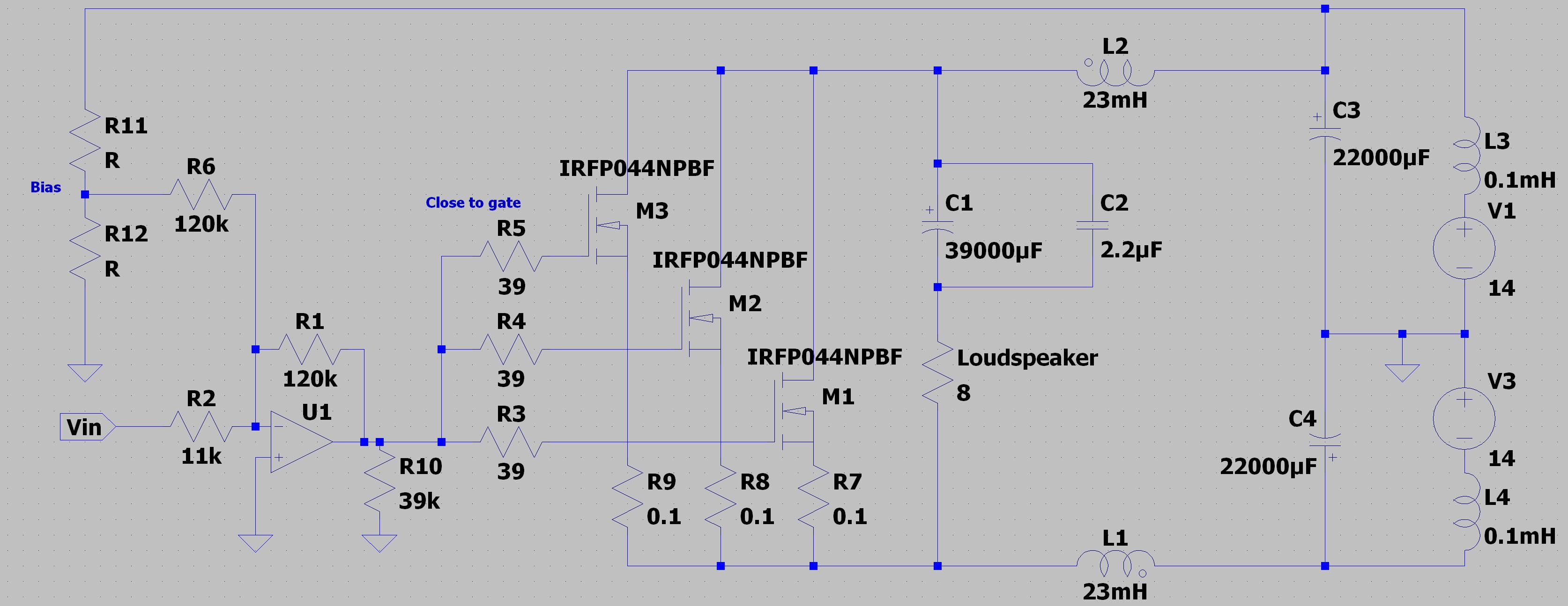

And the final schematic.
To investigate is the 3rd and 5th harmonic relative high distortion levels at 9 and 18 kHz.
Perhaps it is only a measurement system's artifact.
Three more SLAPS for SLAM! are built, just need to make the covers.
Then I can finally start to listen to music again.

I really wanted the transconductance of one, but at that resulting current (some 6A or so) it will not last long.
Having several at a lower bias will add up to that transconductance and thus share the current; the devices will last.
I still have to dissipate the same heat though.
Form factor: I wanted a heat sink as wide as the SLAPS coil and then three what was fitted in without heating each other and still effectively dissipating heat.
Perhaps it is one too many though.
Input capacitance of one (IRFP044) is 1.5 nF, so it'll add up and affect the frequency response.
I'm not sure though where the limit is though!
Perhaps four or more of them will measure better and the heat sink still can dissipate the heat (the current in each will lower) and the added input capacitance will not audible affect the frequency response.
I can at the least test a prototype with two heat sinks and six devices! (Thanks for the inspiration!)
