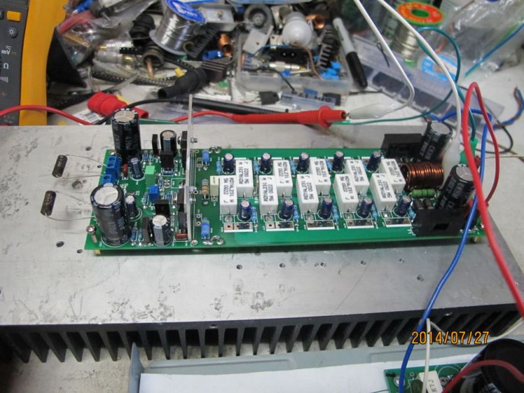

Hi Jason, i just don't want to clog up the thread but running into some trouble with the OPS. I used 15kR across V/PD, ND/-V. I could not get any measurement at RE(0.22R). R113 (68R) measured 5.67V!!!, R110 measured 11.2V. The pre-driver HS toasting hot with alum plate.I used all parts as per your schematic. BTW IPS(CFX-3H) is good and ready to go.

Well, 15k should do for most testing purposes with respect to running the OPS on its own. You say you have tons of bias in the pre-driver / driver but none in the outputs? What are you running for rail voltages?
You have connected the two G2 points with a wire under the board?

Thanks Jason. Yes i did connect the ground together and connected 114/115. The rails are +/- 67VDC. I measured across 0.22R but got nothing despite adjusting the bias. The R113 (68R) measured >5V, R110 measure 11.2V.
Quan
I could not adjust the bias at all. Just a couple of pictures. I suspect may be one of the trannie are position incorrectly.
