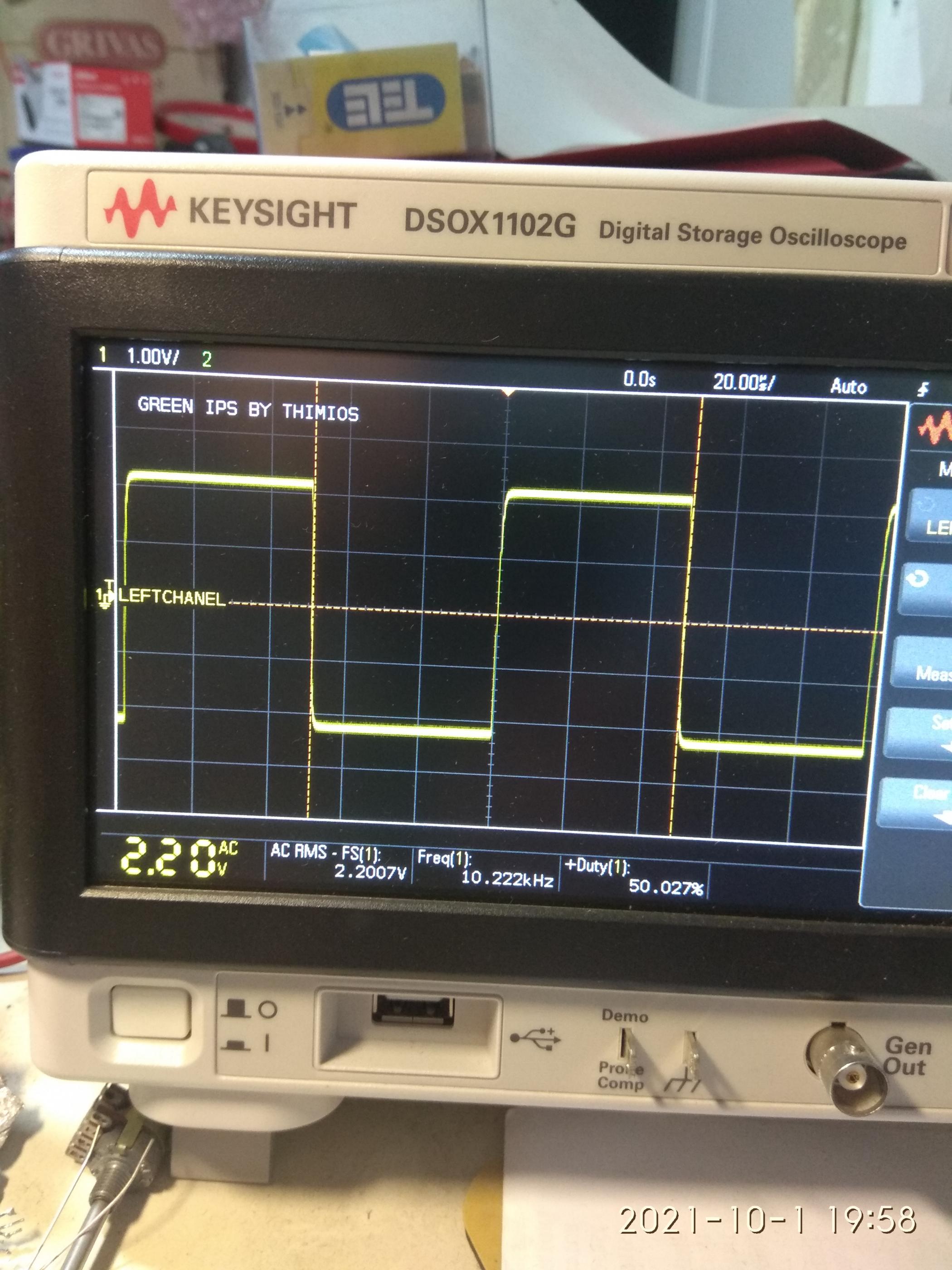

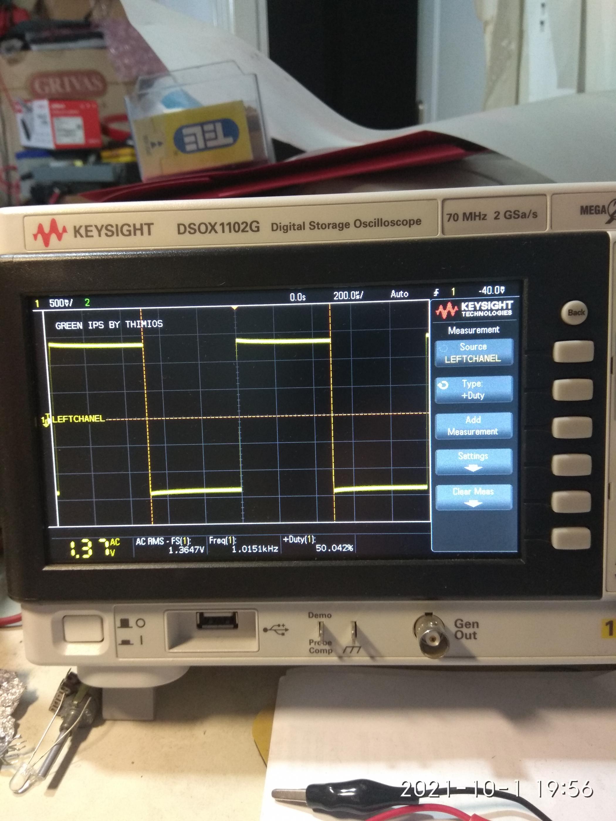

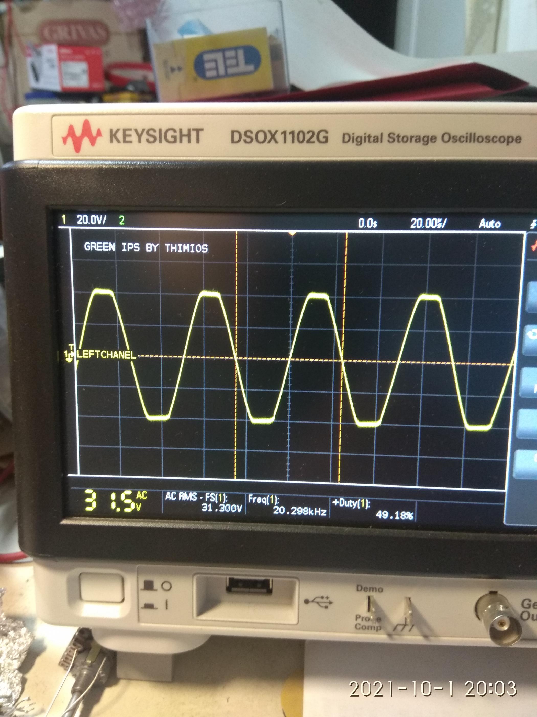

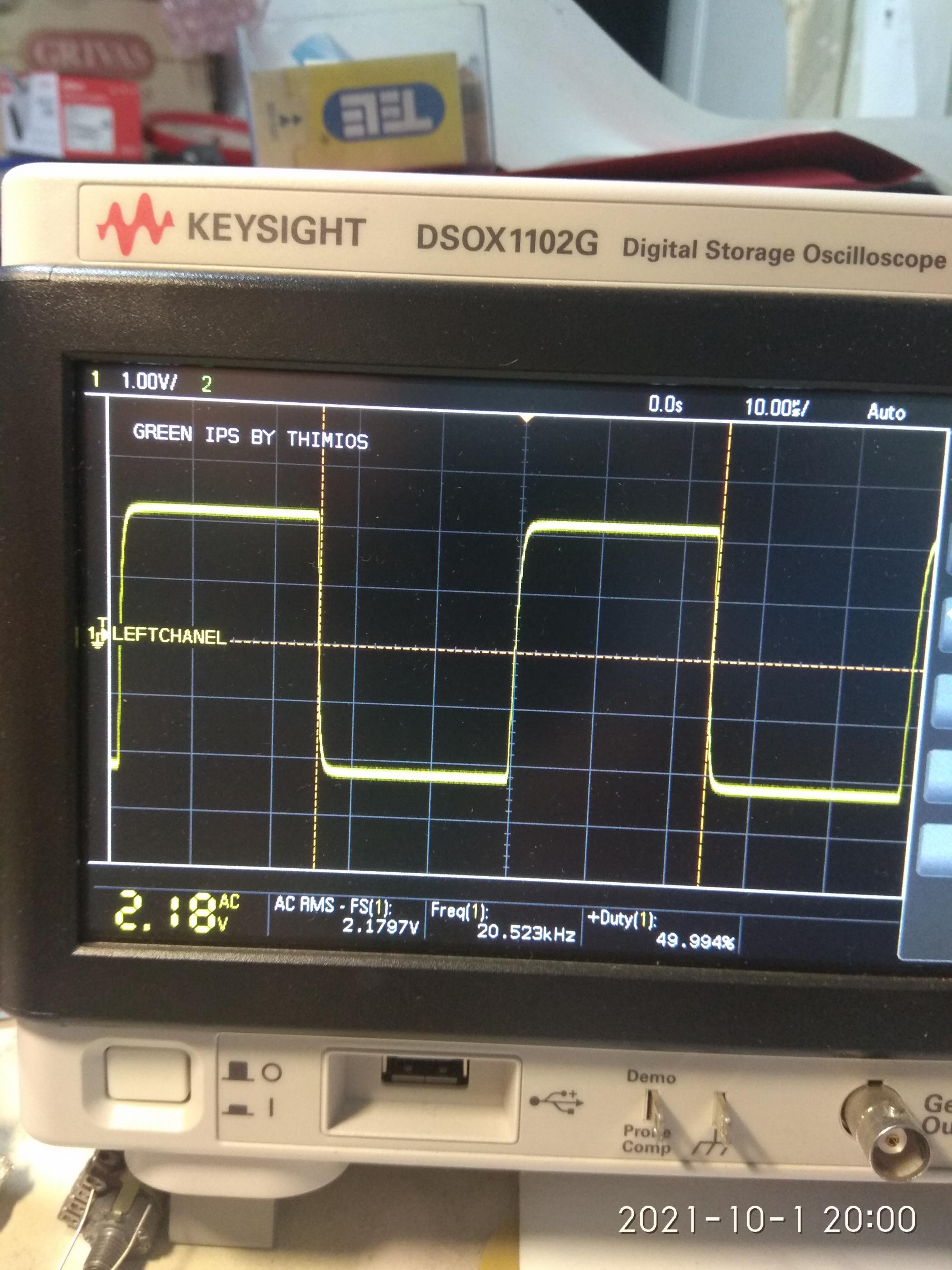

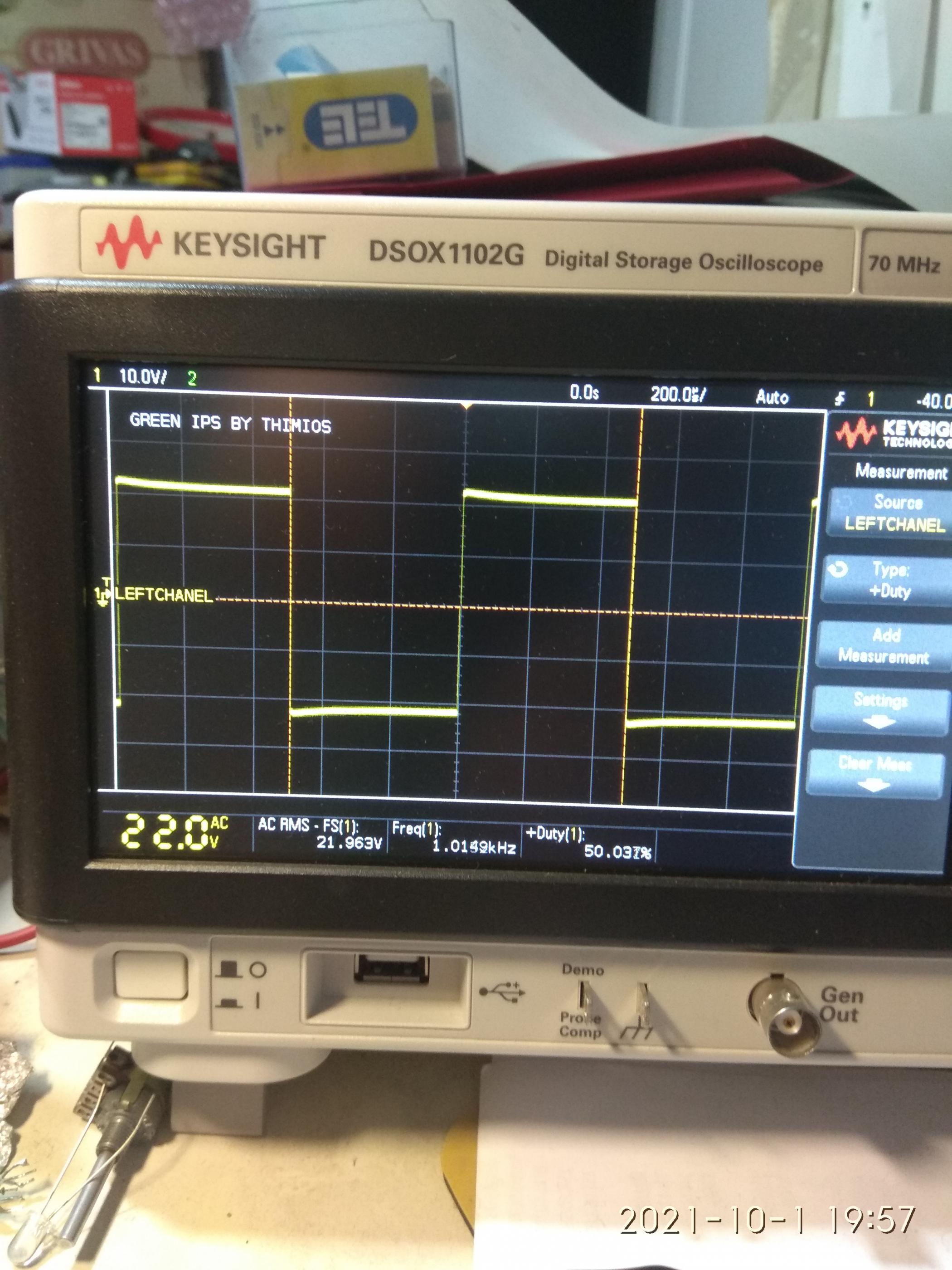

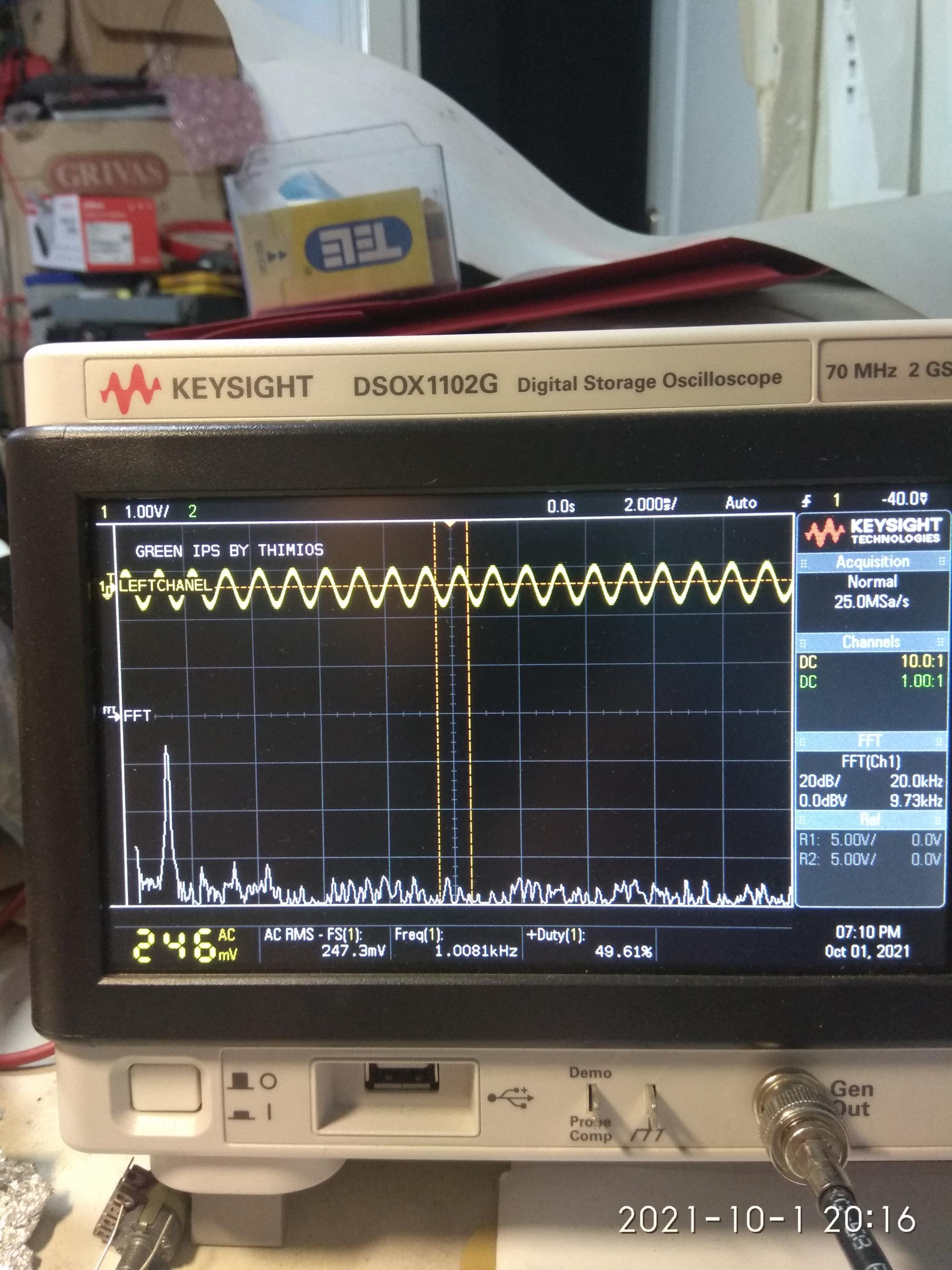

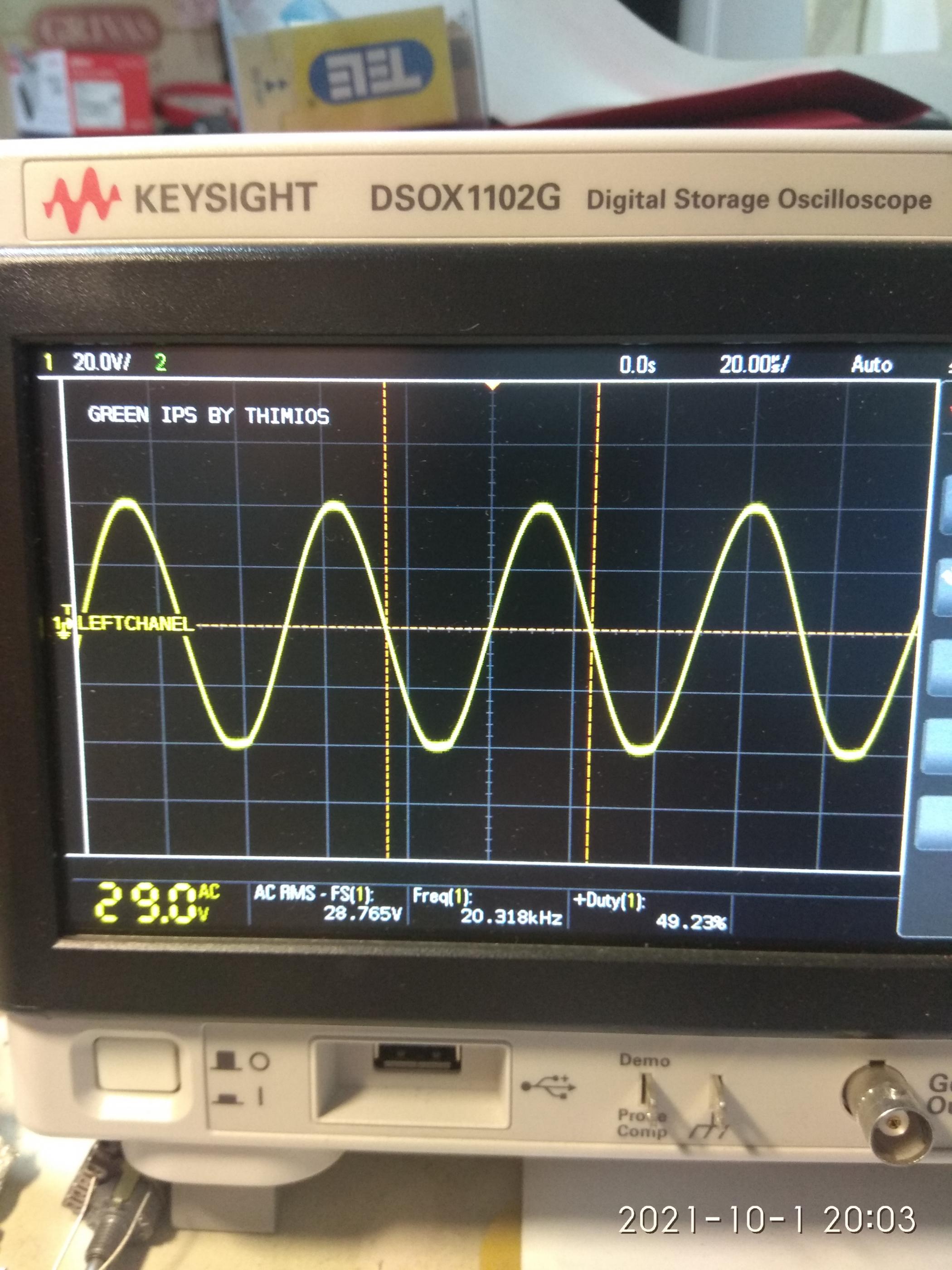

IMG_20211001_200323.jpg Testing the Green IPS
Power supply +/-50v
Vclip=29v RMS
Load=7ohm
Vin=1.2v RMS

1.2mV offset thimios wow! on the first image? Please make a video sound but with free copy right music

hi thimios should work I had mine reversed because the LED were wrongly polarize after I install new one works and sound is wonderful I think in my opinion, maybe you can scope it to see if any changes need to be done to it
