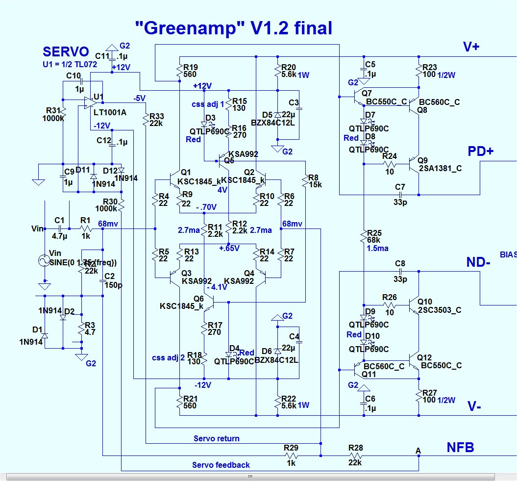

So what can you tell me about all these different boards or parts that have all the crazy names. Wolverine?? I understand the Psychotic statement but maggies are famous for this. Big power! 300 minimum is needed. Am I seeing this correctly that the frontend is not differential long tail pair? I have huge heatsinks and power transformer. I could line up 50 TO3p output packages if needed on one channel heatsink.
From what I understand any of the large panel type speakers like a lot of power. 5 pairs of the big On Semi devices would be more than adequate.
The Wolverine input board is pretty close to the same as the Honeybadger input, it's just flipped upside down in the way it's connected to the power rails.
Out of all of the input boards I think the general consensus was the Spooky input ( a refined Leach amp) was the king in the bass region. The Kypton-ND ( refined NAD amp) was the best at higher frequency detail. The differences were very subtle between then though. These both had DC servos so once they were initially set up and running they were maintenance free designs.

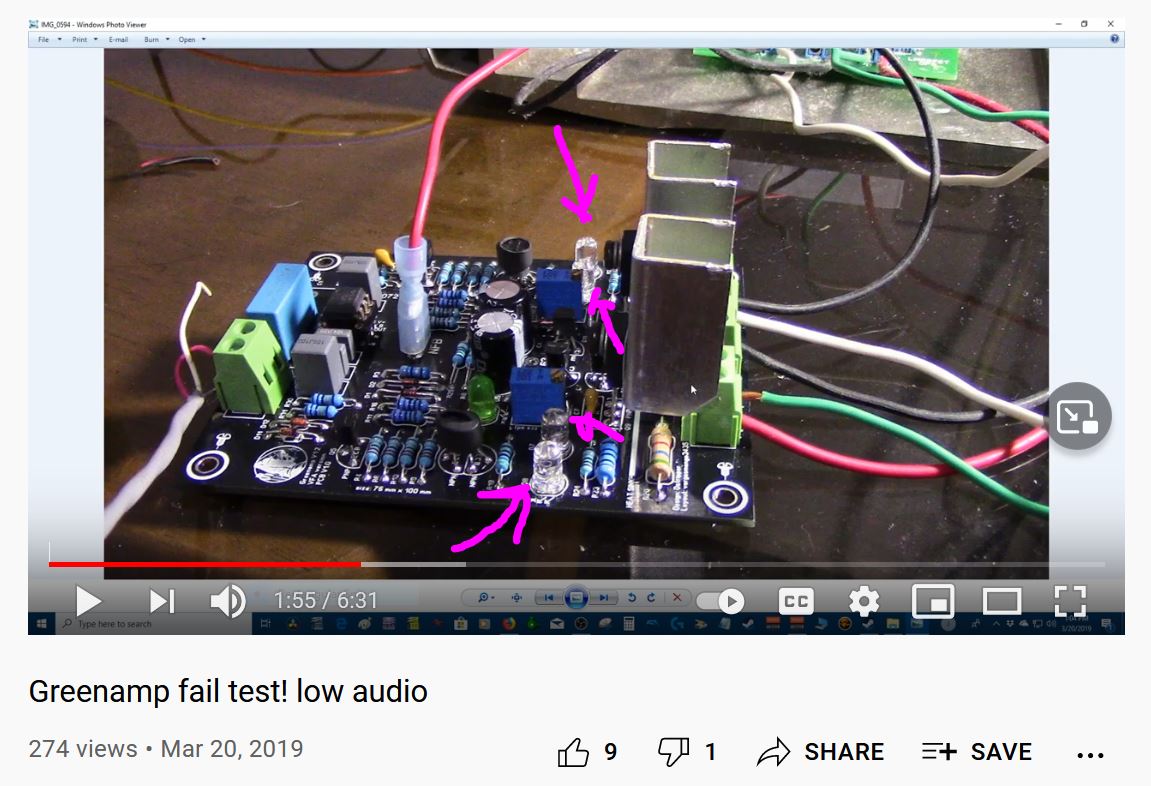

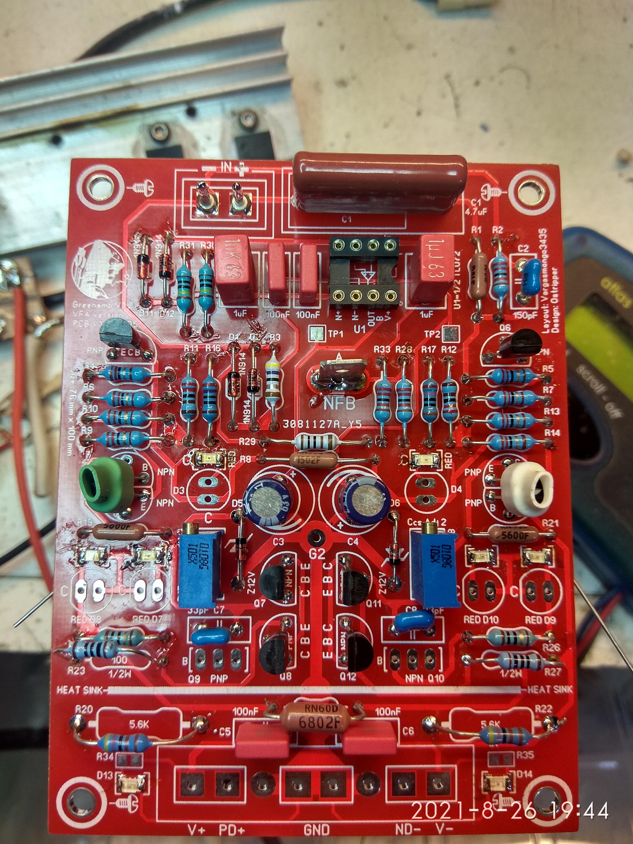

hey guys finally I put the Greenamp together with correct LED also I begin the build of the Arc Welder today first board

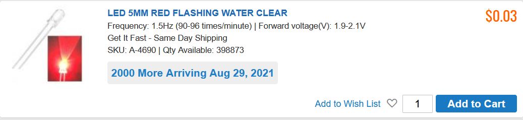

Are the smd red leds suitable for green ips?
Really? The flat on the package was on the wrong side?I had mine reversed because the LED were wrongly polarize
Yes those I purchase on Tayda Electronics the anode and cathode were reversed I learn a hard lesson always check polarity on unknown brand LED I was so angry after I found out
here is a video sorry Spanish, a bit of English
Greenamp ya funciona - YouTube
